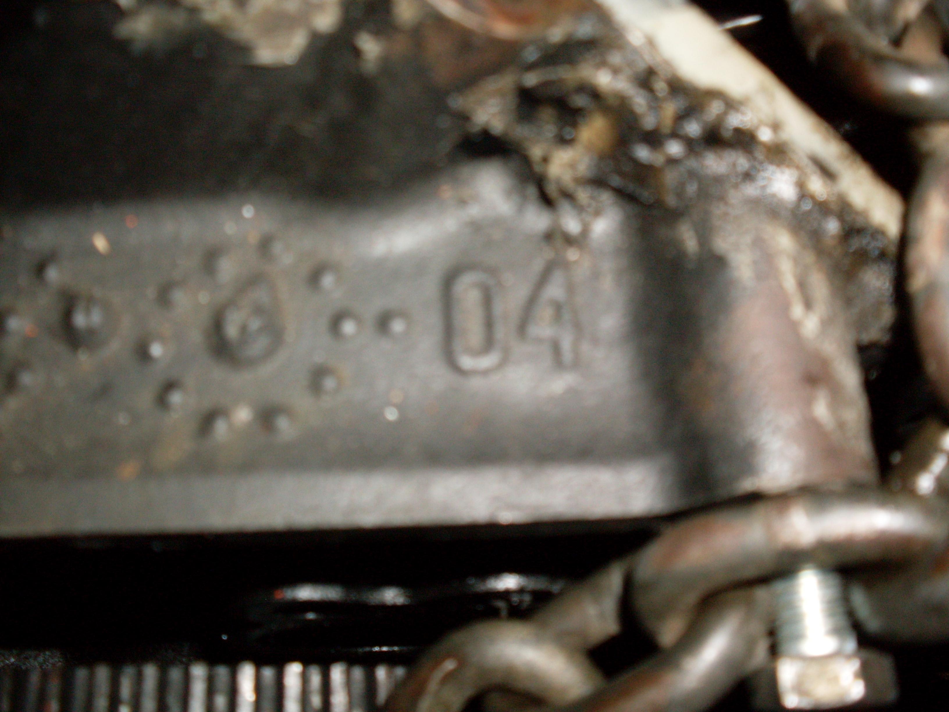

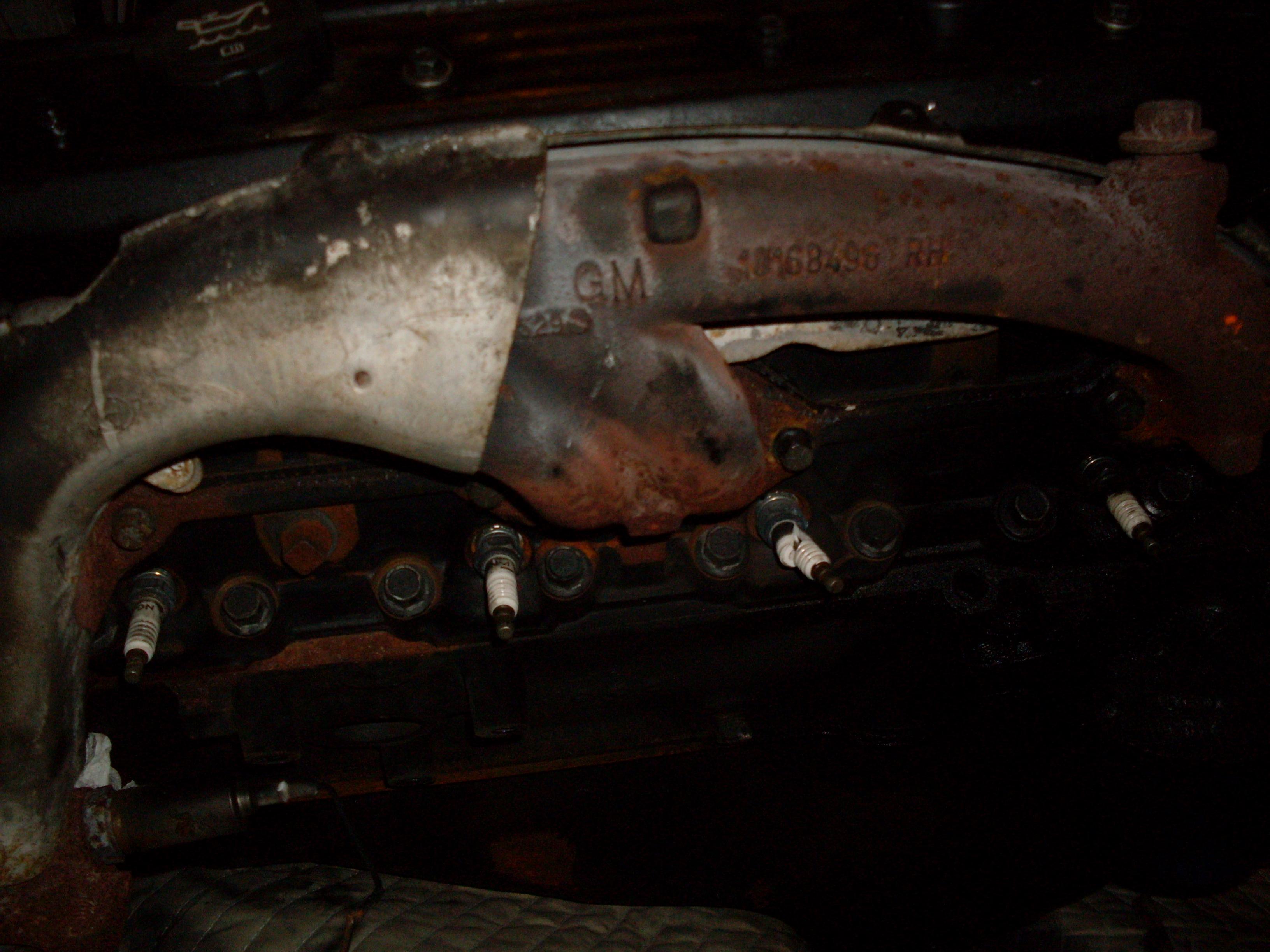

I just bought an engine from a guy on craigslist. He says the engines a 350 with 330 hp and 345 lb of torque, no where can i find the info i need to determine what type of cam and what not i can use for performance. The block casting number is 10066036, the head casting number is 12558062. The block says made in Mexico in 2004. I cant find this engine anywhere that was made in 2004 also the guy said compression was 9:1. If anyone can help id really appreciate it. Ill upload some pics as well, Thanks.

and last, the engines kind of dirty. Anyone know a good safe way to clean it? And inside the intake holes are dirty as well as the coolant ones. If those are the wrong names the ones that are square on top, I took a pic of them one looks like theres sand in it and the other has like an orange rust. If theres any safe ways please let me know thanks

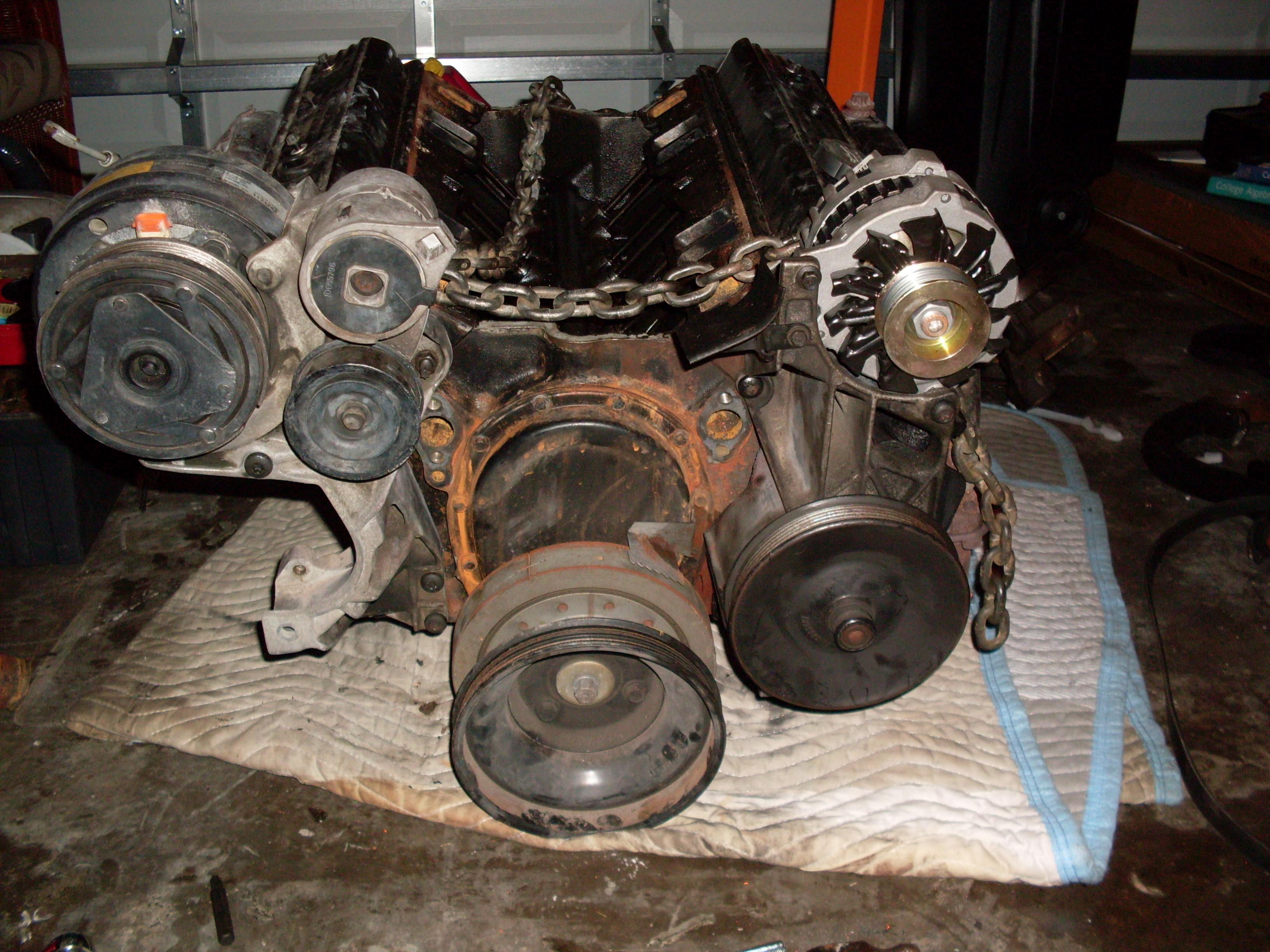

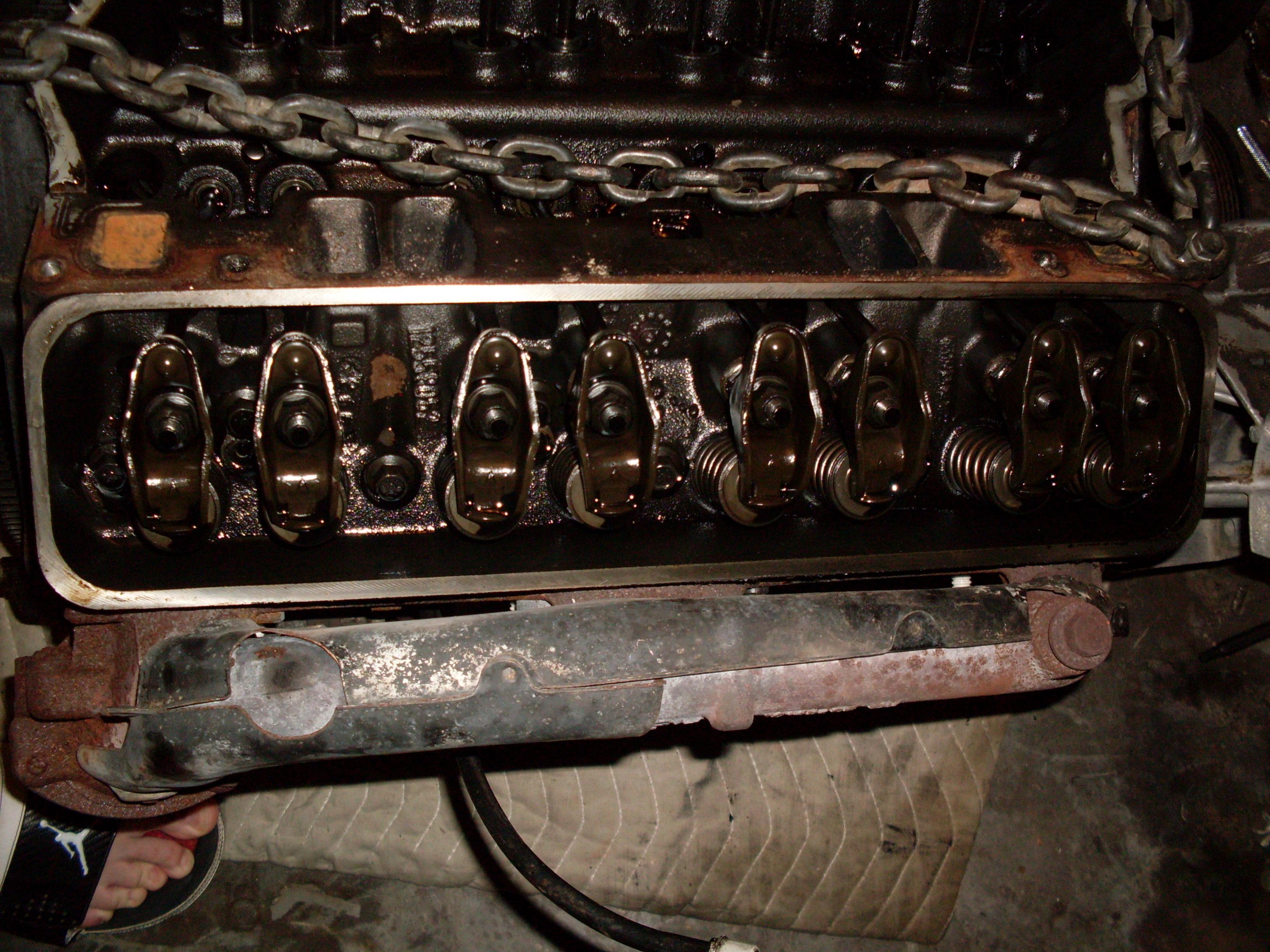

Re: Need help identifying engine

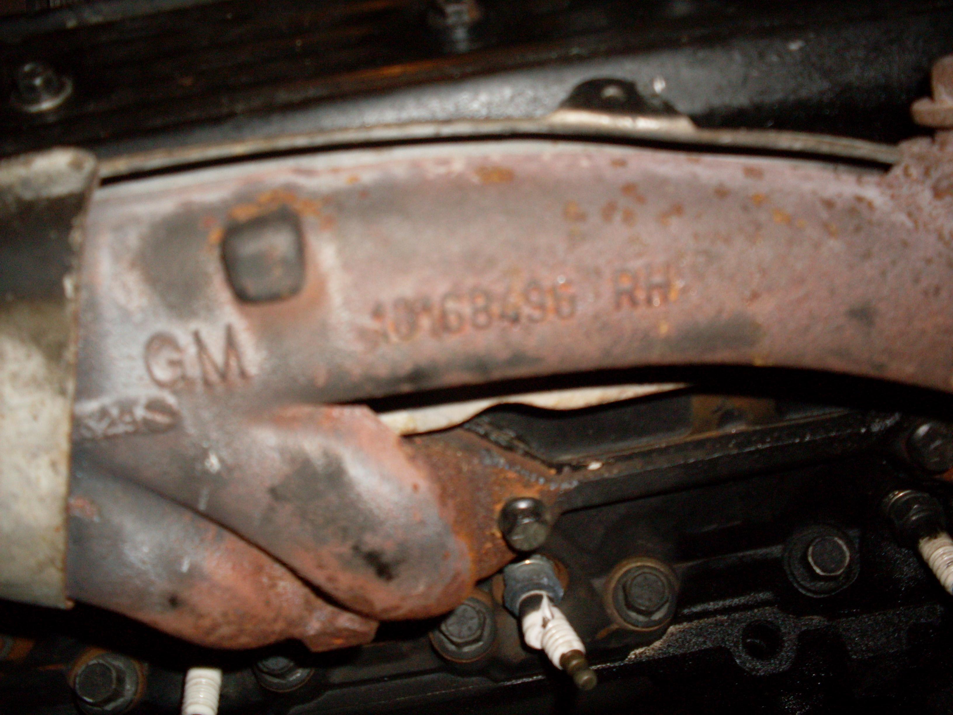

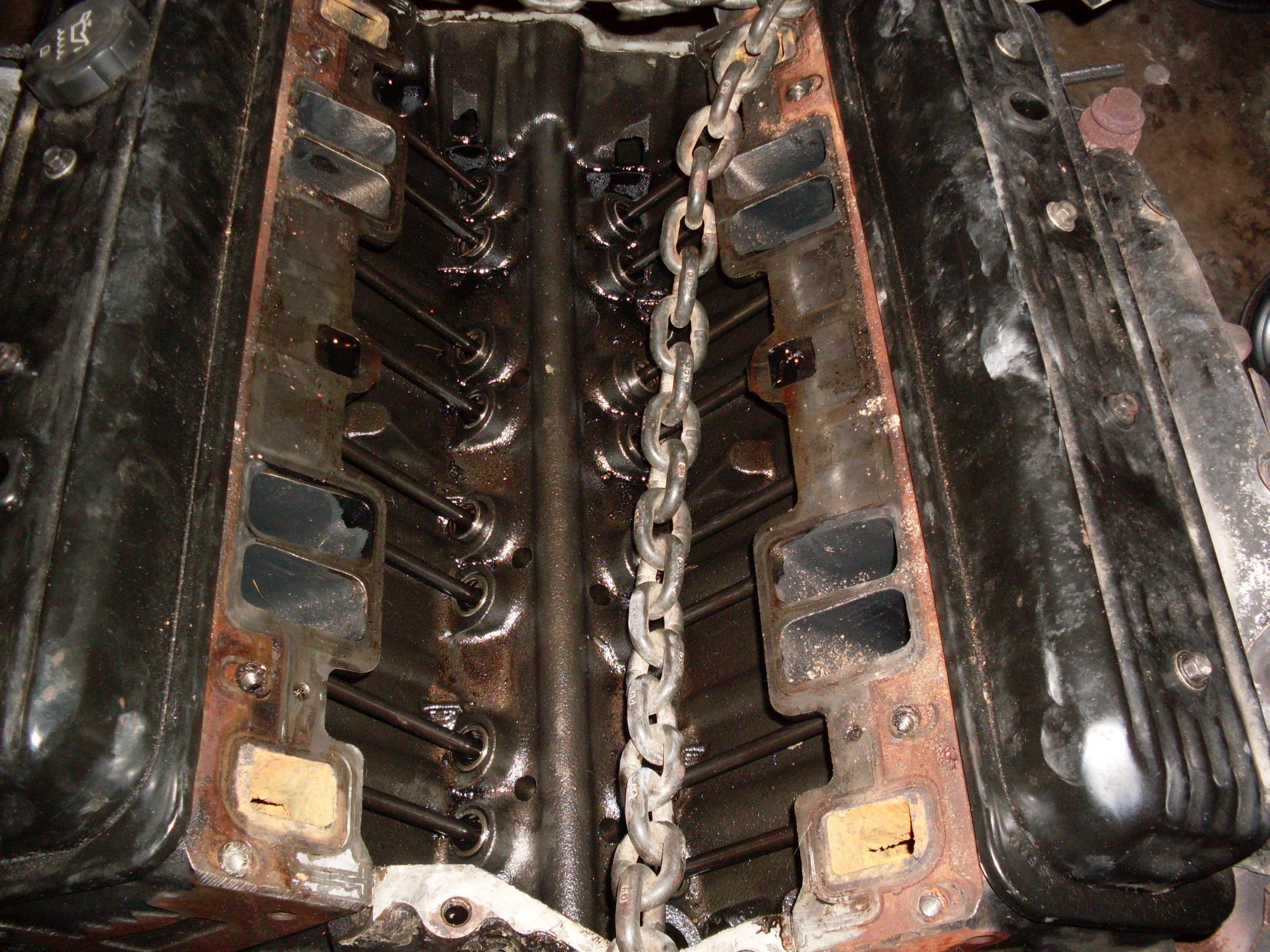

Looks like the stock motor out of a 96-99 Chevy/GMC truck. If it's not, it's probably a service replacement for that application.
Those are the Vortec heads you've heard tell about.
The compression he quoted is probably about right.
Unfortunately it doesn't appear to have a roller cam setup, like an OE Vortec motor would have. You're stuck with either running a flat-tappet type, or getting the $$$original roller (now know as "retrofit")$$$$ style, or finding a junk motor at your local boneyard or somewhere and ganking the factory roller apparatus out of it. There are 2 main things you need to be concerned with there. The first is that the heads are VERY hostile to high lift; the retainers will hit the top of the guides at somewhere around .465" - .480" of lift, as they now sit. The second is, the valve springs they put on those heads are about the WEENIEST things that can be recognized as springs, that have ever been used on SBCs; I wouldn't even call them "springs", they're really just "spring-shaped objects". They are inadequate for the SUPER WEENIE stock cam that's in it now. They are BEYOND INADEQUATE for ANY aftermarket cam. You MUST change them out, along with all their hardware, if you put ANY OTHER cam in there.
I'd recommend leaving the "dirt" you see inside it, alone; unless you tear the motor down. It won't bother anything. The dirt on the outside, you can put an intake on it, tape over the intake and exuast holes with dusct tape, and take it to the quarter car wash and clean that up easily enough.

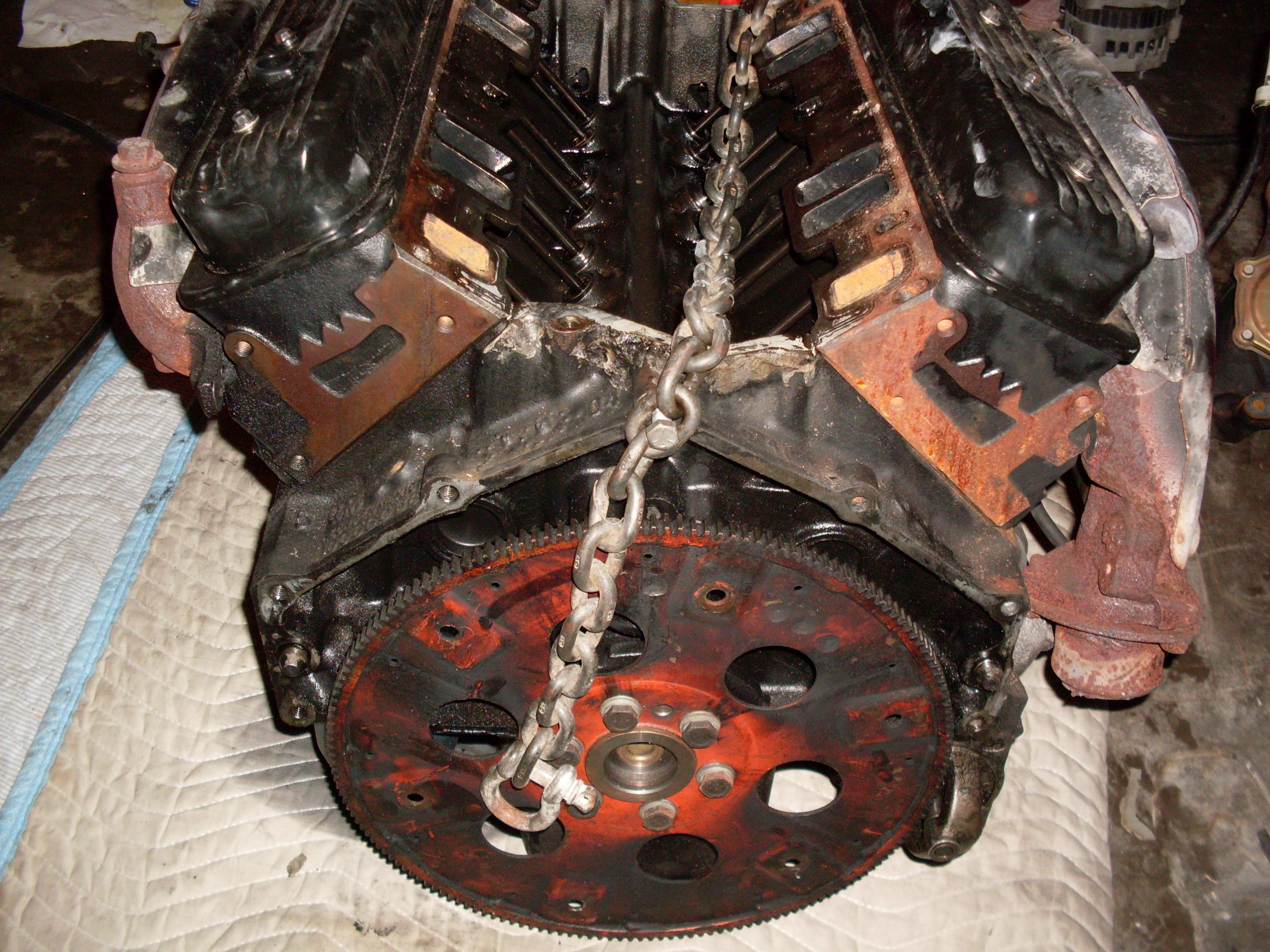

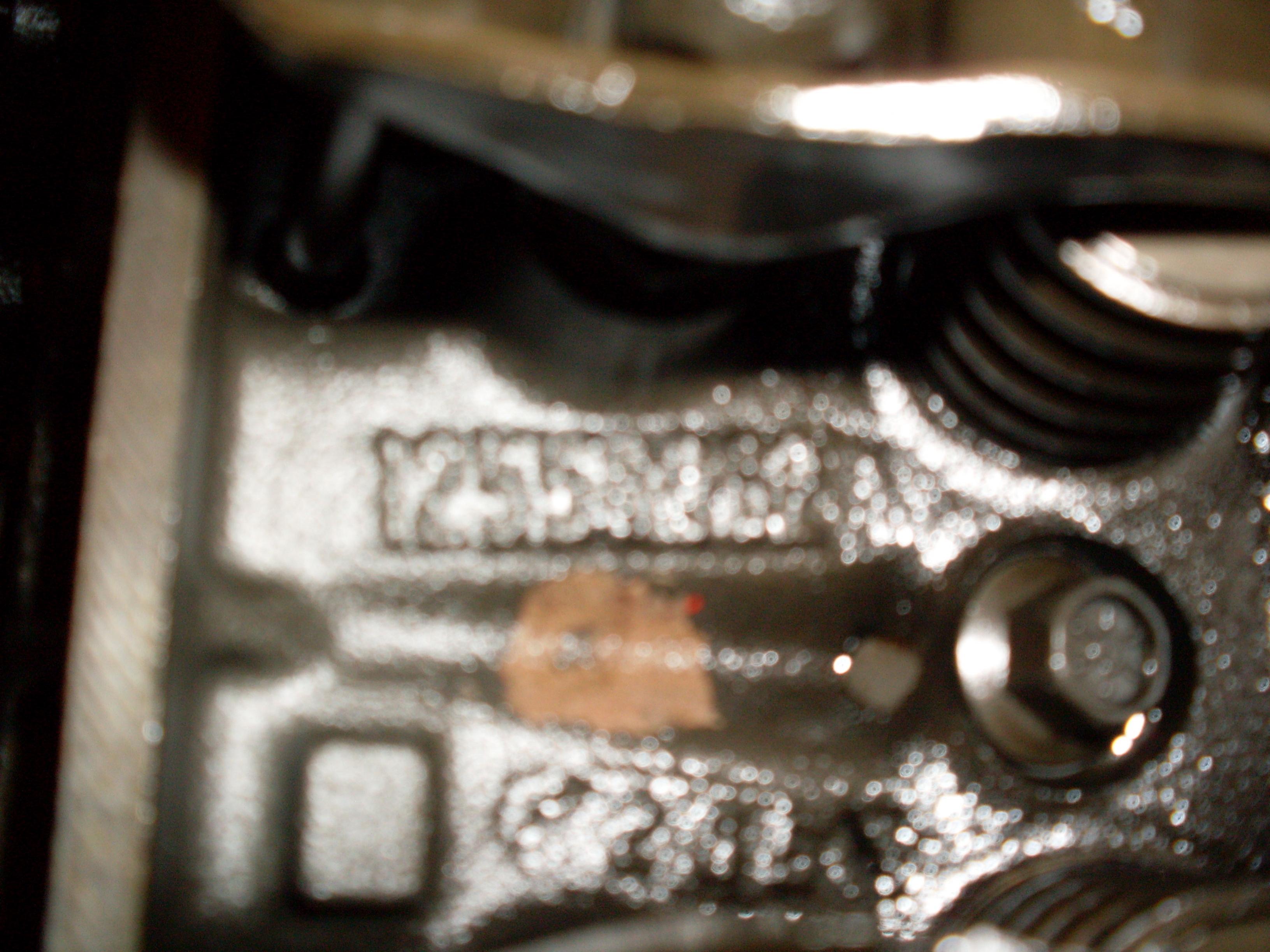

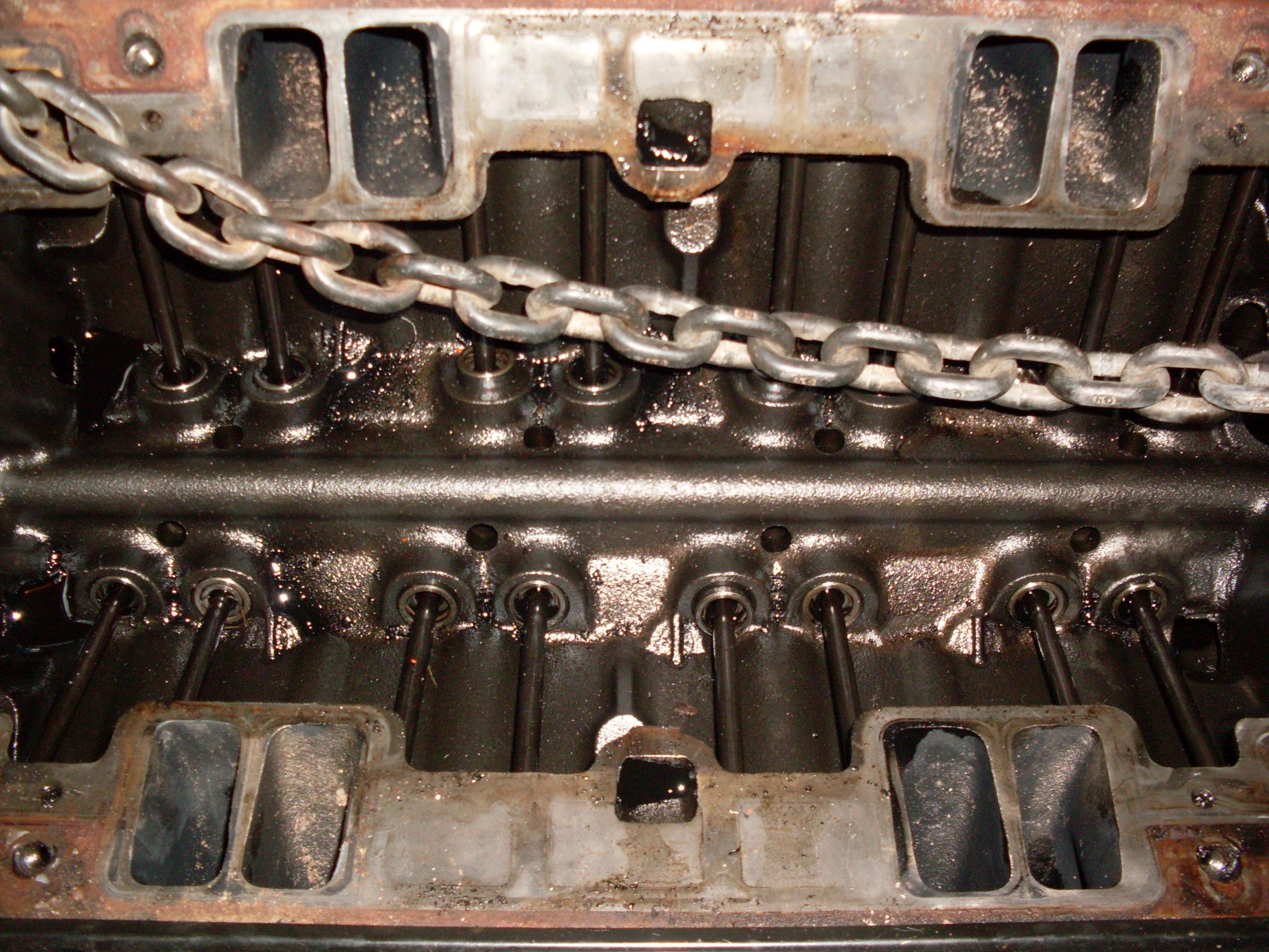

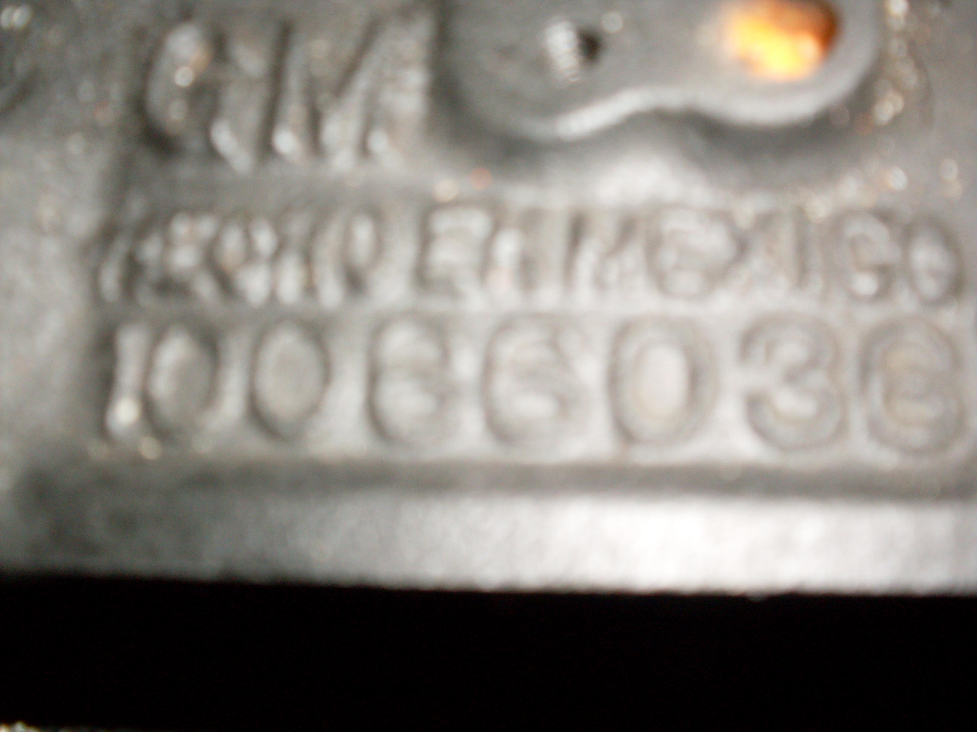

Does not have the top of the lifter bores machined for the roller lifter dogbones , the drilled bosses for the lifter retainer spider or the alum crank seal mount behind the flex plate ( 1 pce RMS )
Appears to be a Goodwrench shortblock somebody put Vortec heads on
( I don't see any listings for GM crate motors with Vortec heads on non roller 2 pce seal blocks)
GM # 10067353
New Goodwrench 350 Engine 1971-1985 Car and light Truck Replacement Engine.
Block ,2 piece rear main seal 4 bolt main casting # 10066036
Crankshaft- # 3932444
Nodular Iron 1985 and older flywheel bolt pattern.
Powdered Metal Connecting rods- # 10108688
Cast Aluminum Pistons-#12514101
Hyd Flat tappet Camshaft- #14088839
@ .050"Int 194 / Exh 202 . 383"/ .401" LSA-112
8.5:1
250 HP @4300 rpm
350 ft. lbs of torque @ 3600 rpm
Of course ,those Hp and CR numbers are with the #33417369 ,76cc heads that
that Goodwrench engine originally came with

Right; definitely not the motor from one of those trucks, probably a service replacement of some sort, since
But at least it has the good heads. Maybe it's some other motor that got stuck inti one of those trucks and they use the original heads from the truck? Hard to say, not that it matters now. It is what it IS, and all the "history" in the world, or lack of it, won't change what it IS.
However all that may be, it's got a flat-tappet setup in it, which kind of sux in this day and time. And it also has Vortec heads, which TPI won't bolt to (if the OP is planning on putting it in the car in his sig which he doesn't really say), unless the one and only "special" conversion baseplate is used, that's available from either Scoggin-Dickey or from Edlebrock. Identical same part, 2 different sources. So, next move would depend on, what you're planning to do with it, and what car it's going in, and stuff like that.

1-pc RMS engines are NOT "externally" balanced.
Like ALL other SBCs except for the 400, they are INTERNALLY balanced. There is enough space below the pistons when at BDC, between the rod journals, for enough counterweight to completely balance the reciprocating parts. In the 400 however, because of the short rods, there ISN'T enough space, so the counterweights are "flat cut" across the top (making them easy to spot in a pile of SBC cranks from 100 yards away).
In 2-pc RMS engines, the flywheel flange is part of the rearmost counterweight, which is why it has that funky shape. However since a 1-pc flange has to be round, that little bit of INTERNAL balance weight can't be on the flange, but instead has to be mounted to the flywheel. This DOES NOT make the motor "externally" balanced, even though the weight appears, to the uninformed eye, to be physically mounted "externally". This often confuses people who don't understand about how balancing works, into thinking they are "externally" balanced; after all, there's the weight sitting there looking "external". WRONG. Those terms do not mean what those people are assuming they mean.
AFAIK GM didn't offer that motor with the older-design crank to satisfy people who didn't "like" the 1-pc seal. They ACTUALLY did it for 2 reasons: (1) to consume all of the accumulated production-line rejects from over the years that they had repaired (aka the "Targetmaster" line); and (2) to supply an engine to large fleets (think, phone companies or the Post Office, those types of customers) who needed a cheeeeep replacement engine that would bolt directly into their existing trucks without changing other parts.
But none of that has anything to do with the issue at hand here, which is trying to help the OP get the most out of whatever it is that he bought here.
In 2-pc RMS engines, the flywheel flange is part of the rearmost counterweight,. However since a 1-pc flange has to be round, that little bit of INTERNAL balance weight can't be on the flange, but instead has to be mounted to the flywheel. This DOES NOT make the motor "externally" balanced, This often confuses people who don't understand about how balancing works, into thinking they are "externally" balanced; after all, there's the weight sitting there looking "external". WRONG. .
The weight is just in a different position
I have had this argument for years across the forums.
General belief is internal balance is better than ext balance for perf use ( less stress on crank ? ) so guys say 2 pce crank is better than 1 pce which is " externally " balanced
Not helped of course by all the flywheel manufactures referring to a 1 pce RMS engine as being Ext balanced
