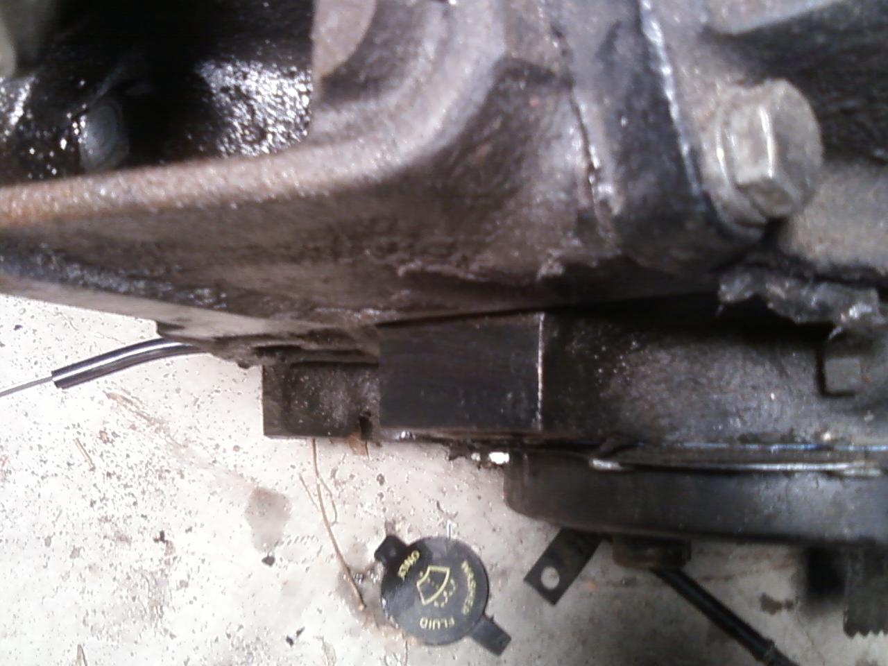

This what looks like, You should still be able to see it even with your Ac and power steering pump on the engine

Alright, I used your picture as a reference, thou the guy who built the engine painted it orange.. and its totally covered.. and I don't even see any number impressions.. soo.. without taking and somehow scraping it off without damaging the tag gonna be a bit hard. Anyother way to tell if its a 350 block? I heard the starter bolts up different on the 350 then a 305.. something about the bolts are staggered? And supposedly the guy put in a Cam that did not require a chip or a modification.. though I do want to agree with you. It seems like the car rev's super slow.. and with it running rich.. blah.. so mad and sad at the same time and just frustrated.

I put the picture of my engine stamp on my photo thing on my profile.. lemme know what you guys think.. seems pretty hopeless.
