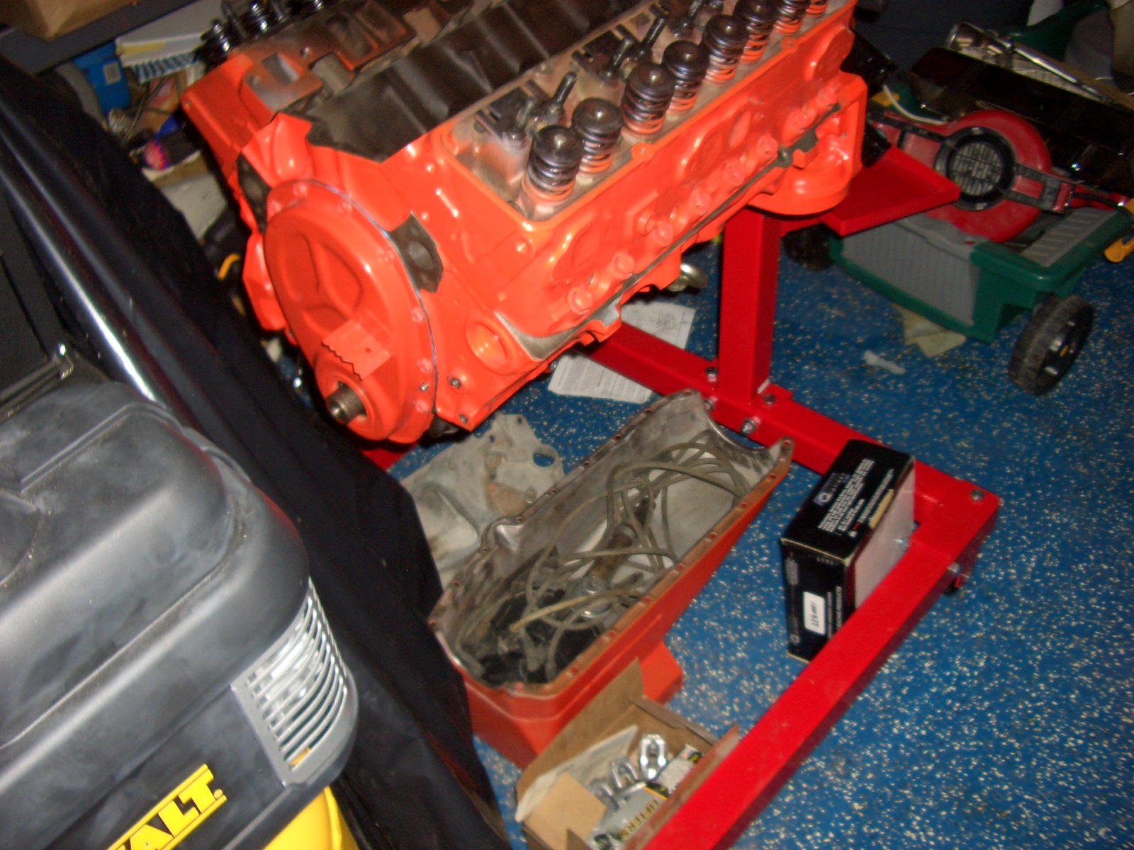

So Im making this thread to show you all pictures of my progress on my engine swap and also if I need help =D ....
Here is the engine!
Attached Thumbnails 305 to 400 My swap log-3.jpg   305 to 400 My swap log-85..jpg   305 to 400 My swap log-106.jpg

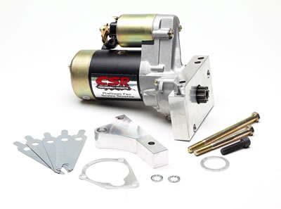

The compression is probably like 9.5:1 so i guess i really wouldnt need the mini starter.
Do you know of a starter that has a staggered bolt pattern that will work with a 153 flywheel?
Old Mar 27, 2011 | 11:17 AM
red406's Avatar
Joined: May 2005
Posts: 270

I missed that you were using a 153 tooth flywheel. I found this on summit's website. It is a little pricey though. It might be cheaper to find a different flywheel.
http://www.summitracing.com/parts/CSI-100PSBP/

I wonder if i can just get that adapter seperatly and put it on my starter.

Why not just use a 400 starter? I think I paid around $60 from Ebay with shipping.When i did my 406 swap that is what I had in there and used hedman long tubes and it cleared well.

My dad is just going to drill the hole for me.
The 400 starter is for a 168 tooth flywheel and that wont match my t56 or even fit in the bellhousing.

yeah may as well just drill and tap the hole and use the mini starter you already have. only other option is to buy an msd or powermaster they have them staggared for 153 or 168).

painted the engine red.
What do you all do for your lifters? I have a video that just says put some assembly lube on the bottom of the lifter, and dump a half quart of oil on them and just slide them in. Or do you guys reccomend soaking them over night in oil?
