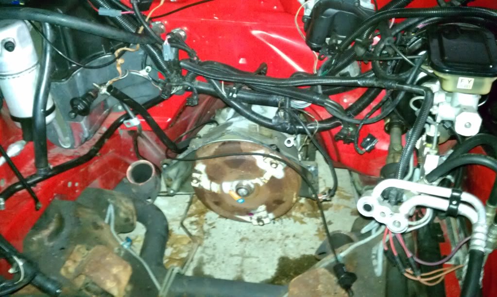

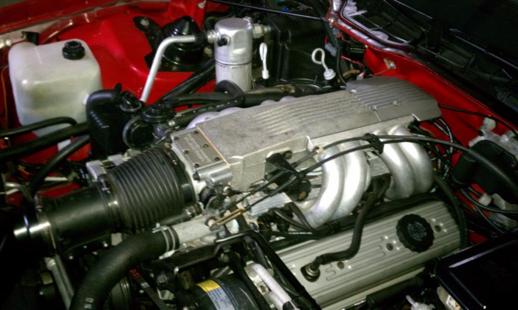

This is what I got so far. Tell me what you think. I'll keep the pics coming as I go. Hope to finish by May.

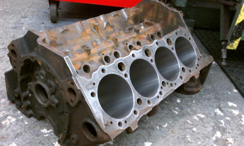

350 4-bolt .040 over 1-piece RMS. World Sportsman II heads w/ mild port and full rebuild

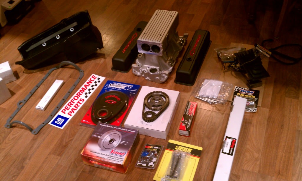

StealthRam, goodies, 30lb Bosch III's, can't see it but Lunati 30142 Flat tappet cam. Deep sump pan

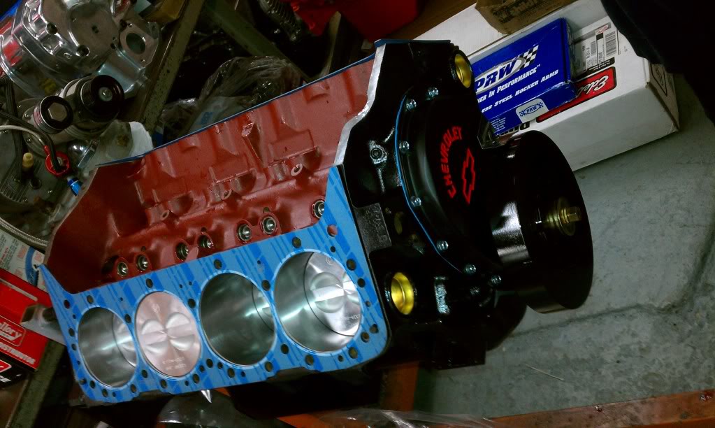

Assembled short block
Size:  42.4 KBName:  IMAG0352.jpg
Size:  106.1 KBName:  IMAG0355.jpg
Size:  67.1 KBName:  IMAG0356.jpg

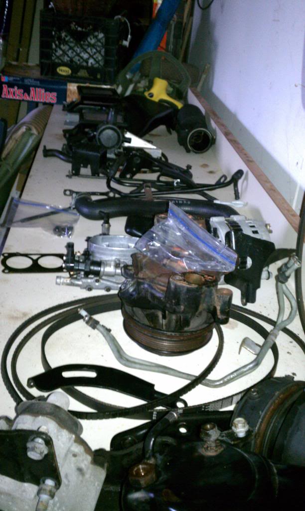

Tear down

Question 1: Whats the best way to seperate the tranny from the motor? Can it all come out in 1 piece? How high should I get the car up?
Size:  71.9 KBName:  IMAG0418.jpg
Size:  62.9 KBName:  IMAG0419.jpg

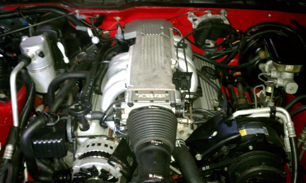

Question 2: What is a good way to re-support the alternator bracket with the stealthram ?

Spent a full day on the engine and bay today. First thing I tackled was inspecting and repairing the wiring harness and rerouting the wires to give a little more access behind the motor once it goes back in.

Next I spent a couple hourstransfering over most of the sensors from my old 305 to the new engine. My World heads had larger tappings than the oem 081's. Guess I can find some reducer bushings to make the sensors fit there. Vaccum fittings for the stealth manifild were not the same thread size either so I'll deall with that later on when I get to fuel lines. I did eventually drop the new block into the car and got mount bolts in place. Gonna tackle the bell housing tomorrow. I'm wiped and will probably take another 3 hours just cause I have to jack the car back up to get at them.

Glad to see you are at the point where you are at least turning it over. Does the weak spark mean it runs? Just poorly?
I have been putting in a few hours here and there routing the harnesses and mocking up hoses and accesories to figure out what else I need. The headers are back from the ceramic coaters ( I went black) and I purchased stage 8 fasteners to holdem in. Got 1" bolts but they were too long so I cut a 1/4" off each and now they are good. I think my World heads have a bit different size larger threads for the coolant sensors so I need to get either reducer bushings or new sensors. Alternator bracket came from summit and I will needs to sand down and paint black. That and my MR. gasket water neck too. Chrome on my bay looks like SH#%.
Ordered tuning service from Solomon @ http://www.lt1pcmtuning.com/ . I have good feeling he will have this thing running pretty stout when I go to fire it up. Then I'll do some data logging and he will adjust some more. It should give me a pretty good idea on what to really mess with once I get into it myself. The last thing I want to have to do is play around with my tune for 6 mos before I can even enjoy driving it this summer.
My plan is to route the fuel lines from the engine bay back to the fuel inlet. I kinda wanna give it a try with fabbing up some of my own hard lines with flares for a real factory look. I wonder if anyone has gone through that aggrivasion with this manifold swap before? Also gonna do what ORR did with relation to the PCV valve and air breather. What about the vaccum line that goes to the canister from the throttle body? can that get vacuum from elsewhere so I don't have to run it accross the front of the motor?
I'm left with some extra electrical connectors from my smog system so I'll have to figure a way to neatly tuck and hide those somehow. I went with EGR delete but I know the World heads come equipped with that. Is this something internal or is the an external opening on the heads I have to plug up?
Here are some shots of the mock up so far:
