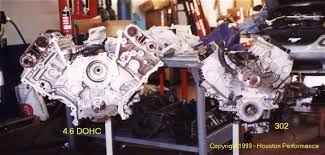

dohc vc ohv, here's a f*rd rendition

How odd that down here in tampa with rediculous downpours i've driven around more than adequately enough to say that you are referring to hearsay, from people who lack the ability to maintain their vehicles, and then blame their lack of maintenance on a part design.
There are plenty of others who have actually owned them that have had the same experience.
