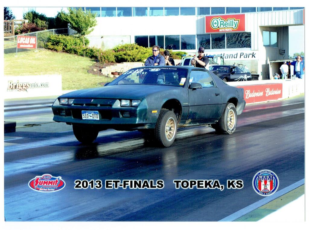

You could also put a 4bbl TBI unit from somebody like Holley on a 4bbl intake manifold. Probably need to use their computer, though, rather than the factory TBI computer (I'd suggest you search the TBI forum for information about running aftermarket TBI systems with the factory computer).
Whenever I see a post that lists a HP goal, my first thought is, "Where did that number come from?" I'd prefer to shoot for a performance goal, even if it isn't quantified (plenty of spunk, gets out of its own way, etc.).
I haven't had my car on the dyno, but from the HP calculators you see that use 1/4 mile ET and MPH to estimate it, I'm not making 400 HP with my LS1/4L60E combo. I normally run it at 5800' elevation, which most people can't relate to, but I did run it at Topeka last month (yes, the car is ugly, but paint ain't a go-fast part...):
That's at about 3350 pounds going down the track, puttin' the hurt on 26x9.50-14 Hoosier Quicktime DOT slicks. All GM internals in the engine, with LS6 intake/cam, 1-3/4" primary/2-1/2" collector long tube headers, single 3" exhaust out to the bumper, free-flowing air inlet, shift kit in the tranny, ~3500 stall, 3.73 gears. I drive it to work with highway radial tires pretty much year round (hence the rust hole in the driver's door - bad collision repair job). Best it ran was a 11.82 @ 114.8 MPH (last weekend at the high altitude home track it was running 12.7's @ 107 MPH).
Now, that's less than 400 HP. If you want to turn your daughter loose on the street with even more power...
