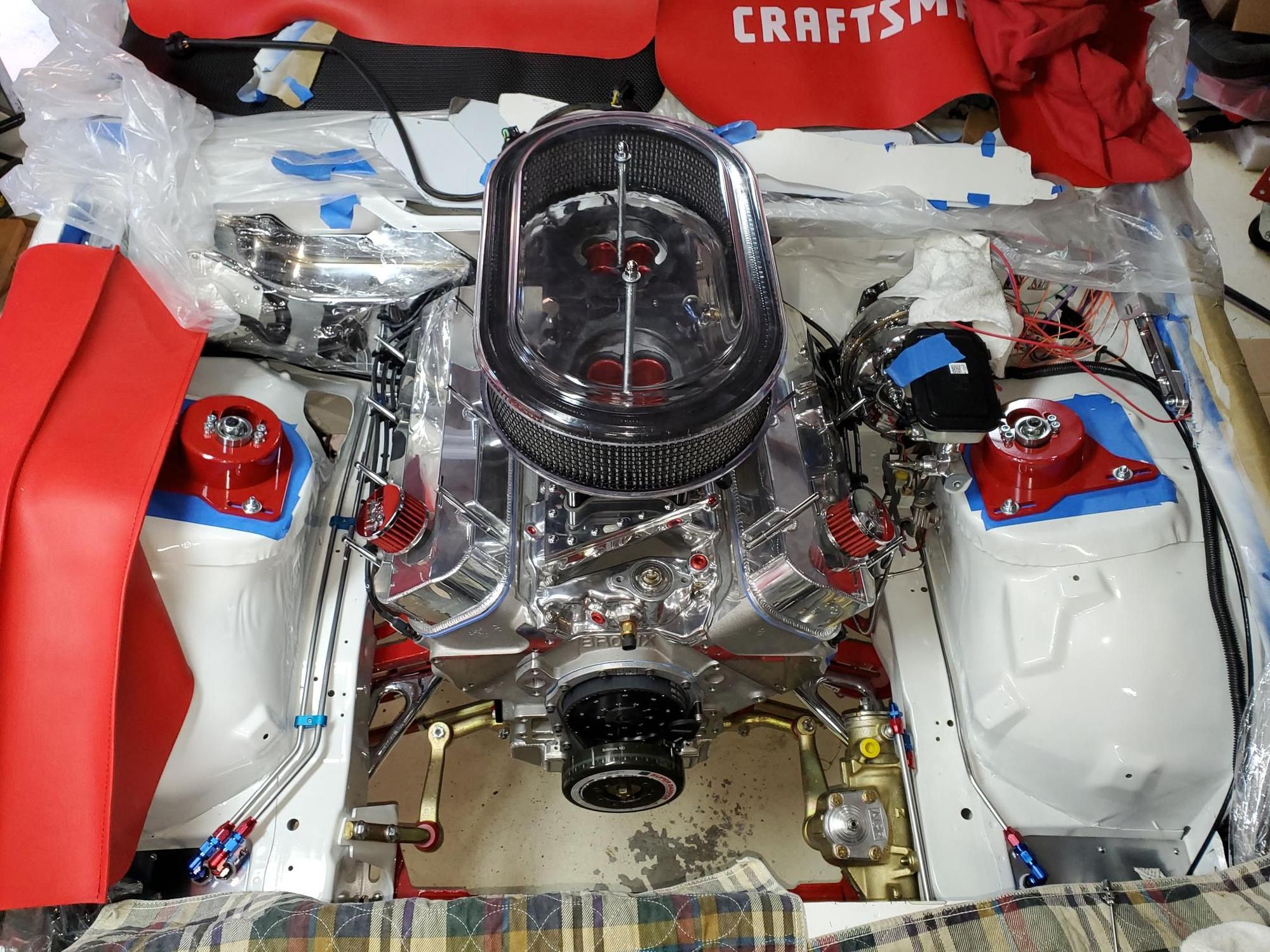

Did a Larg CID Aluminum BBC install with Bolt in Parts. Not a Tall Deck. just 615cid solid mounts and did everything New (Yes everything)
it was bolt in. Had no Problems. drops in. some like front plates some like stock motor mounts I used solid.
I did AC delete. just Heater.
your going to need a aftermarket hood unless you get the New low profile intake.(Brodix I think) I made My own intake out of a old tunnel ram (cut it down) to look like the old school Pro stock for the 70s. sort of thing.
headers today $900 to $2500 Ball park. for good fitting working units.
trans Pick one? Th400 will bolt in without body mods.
Accessory Drive. like Headers. so many out there I run Power steering and alternator. simple.
GM should have installed the BBC.
I like the Dan Lemone's headers spendy and ya have to cut 2 holes. (easy).and $2300 to my door. not for everybody. but ya can get to all the plugs. and install takes 30 mins by your self with eng bolted in. Lotes of room for the big Block in the 3rd Gen Camaro. .Just Do It.

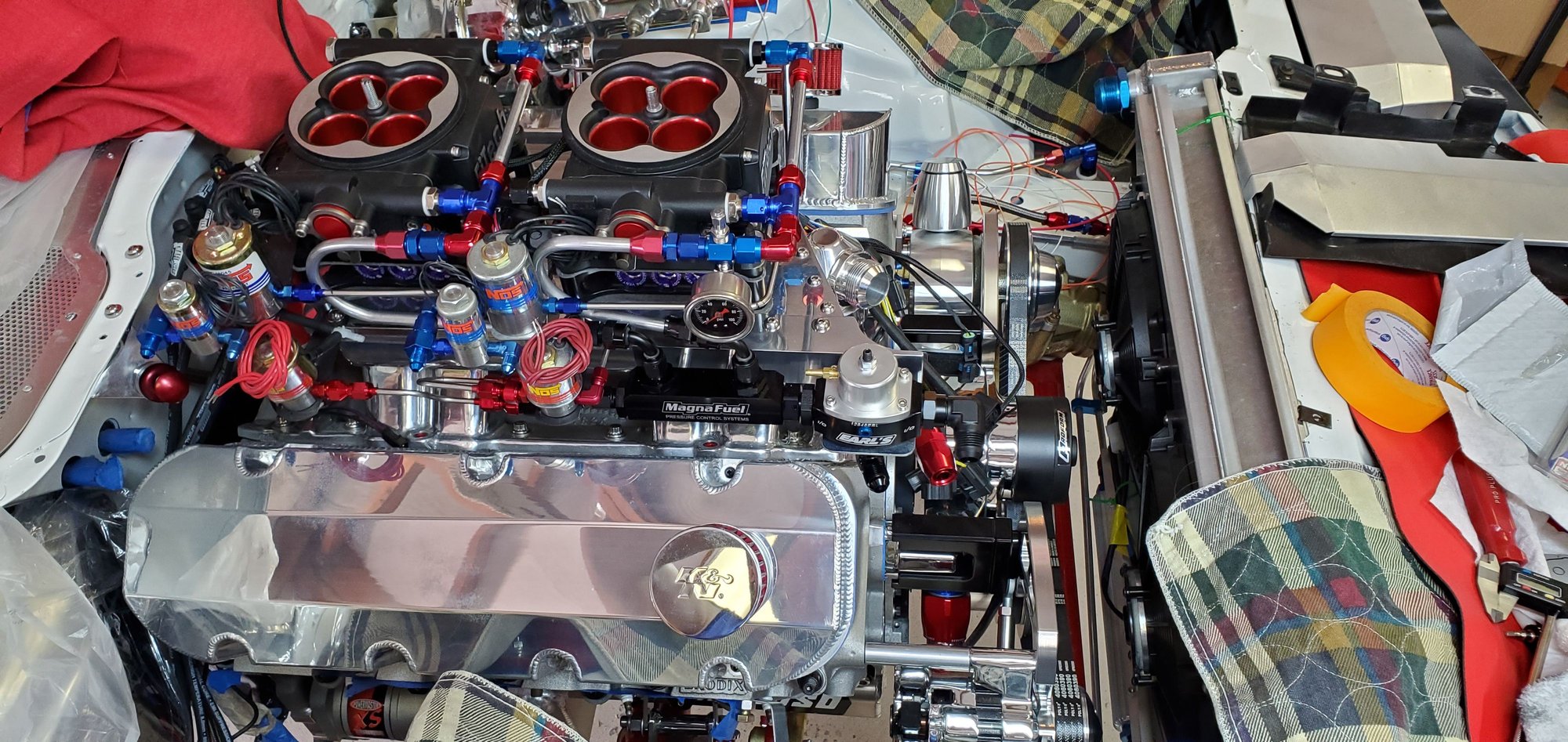

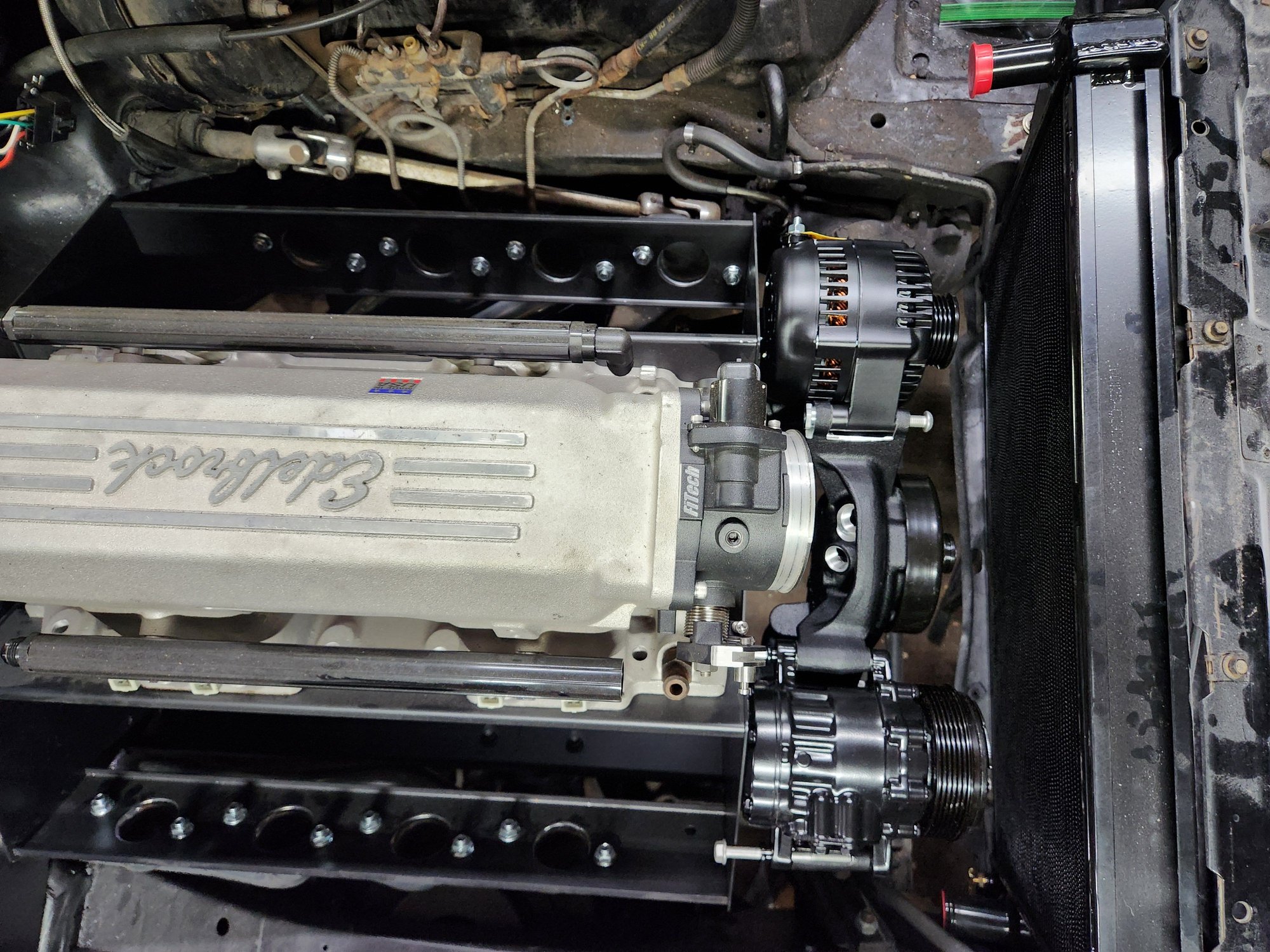

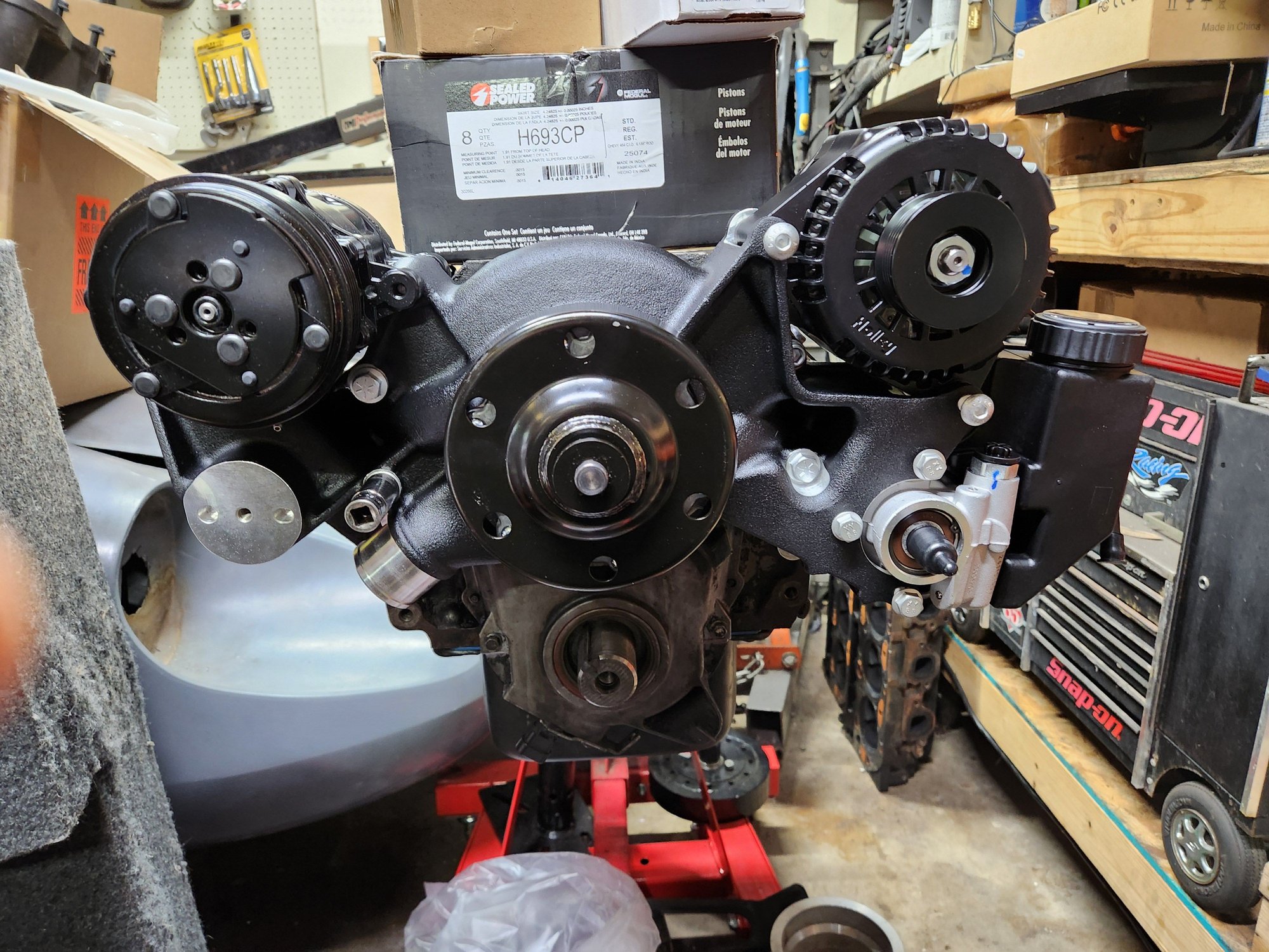

Old May 24, 2026 | 09:32 PM
85Z28NOS's Avatar
Joined: May 2010
Posts: 542
Likes: 38
From: Texas
Car: 85 Camaro
Engine: 454 RamJet
Transmission: LT1/T56
Axle/Gears: 8.8w/4.10
Re: How To Install A Big Block Chevy Engine Into A Third-Gen!
I recently
bought the Holley mid mount accessory drive for my gen6 install and really like the way it fits. The only change was to a remote reservoir for the power steering
