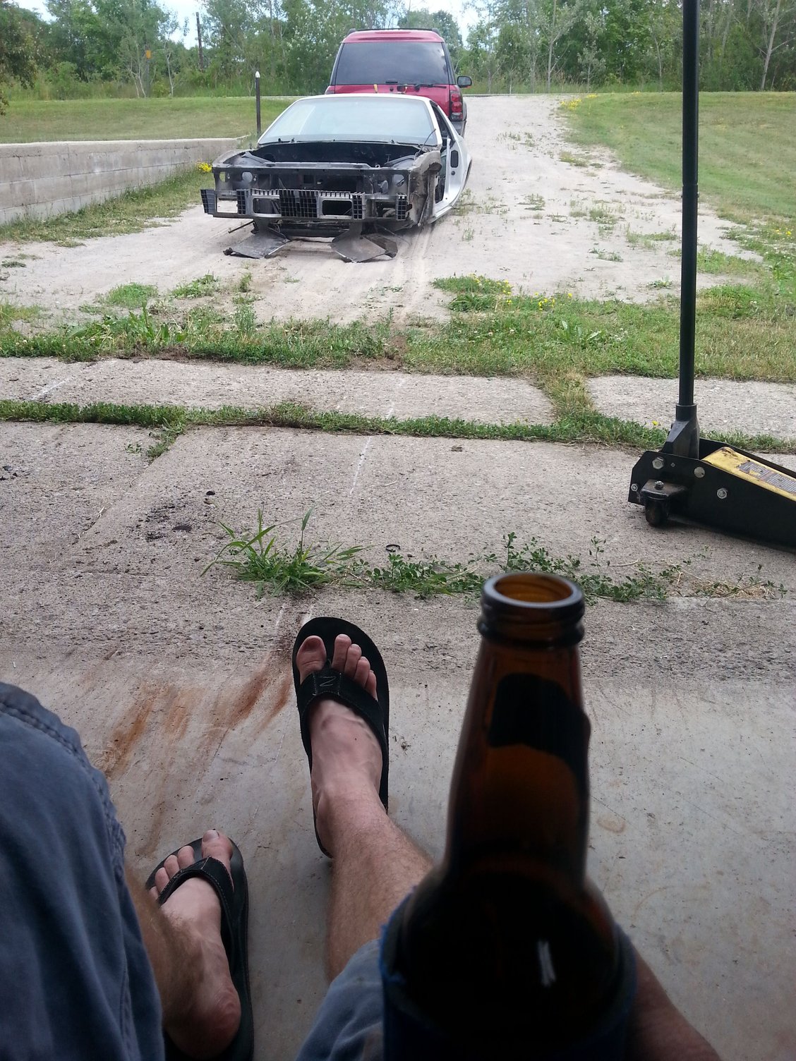

Turbo 3.8 or 5.3 LS?...TURBO 6 WINS!! Buick 3.8 swap 2.0
Hey everyone. A quick back story here. 12 years ago i bought my 1986 camaro and over the years built it up with a turbo 3.8 buick engine. This past winter it was found the floor and frame was too rotten to be practical to repair. So I bought a 1984 camaro with the 5.0l to replace the 86. The plan was to build an all aluminum 5.3 LS with a carb and cam. I have already gathered some parts. Now after driving the 86 again i realized how much i miss the turbo 6 power. So the question is continue with the ls, or swap over the turbo 6?
Attached Thumbnails Turbo 3.8 or 5.3 LS?...TURBO 6 WINS!! Buick 3.8 swap 2.0-20150830_151813.jpg   Turbo 3.8 or 5.3 LS?...TURBO 6 WINS!! Buick 3.8 swap 2.0-20150830_151838.jpg   Turbo 3.8 or 5.3 LS?...TURBO 6 WINS!! Buick 3.8 swap 2.0-20150830_151933.jpg

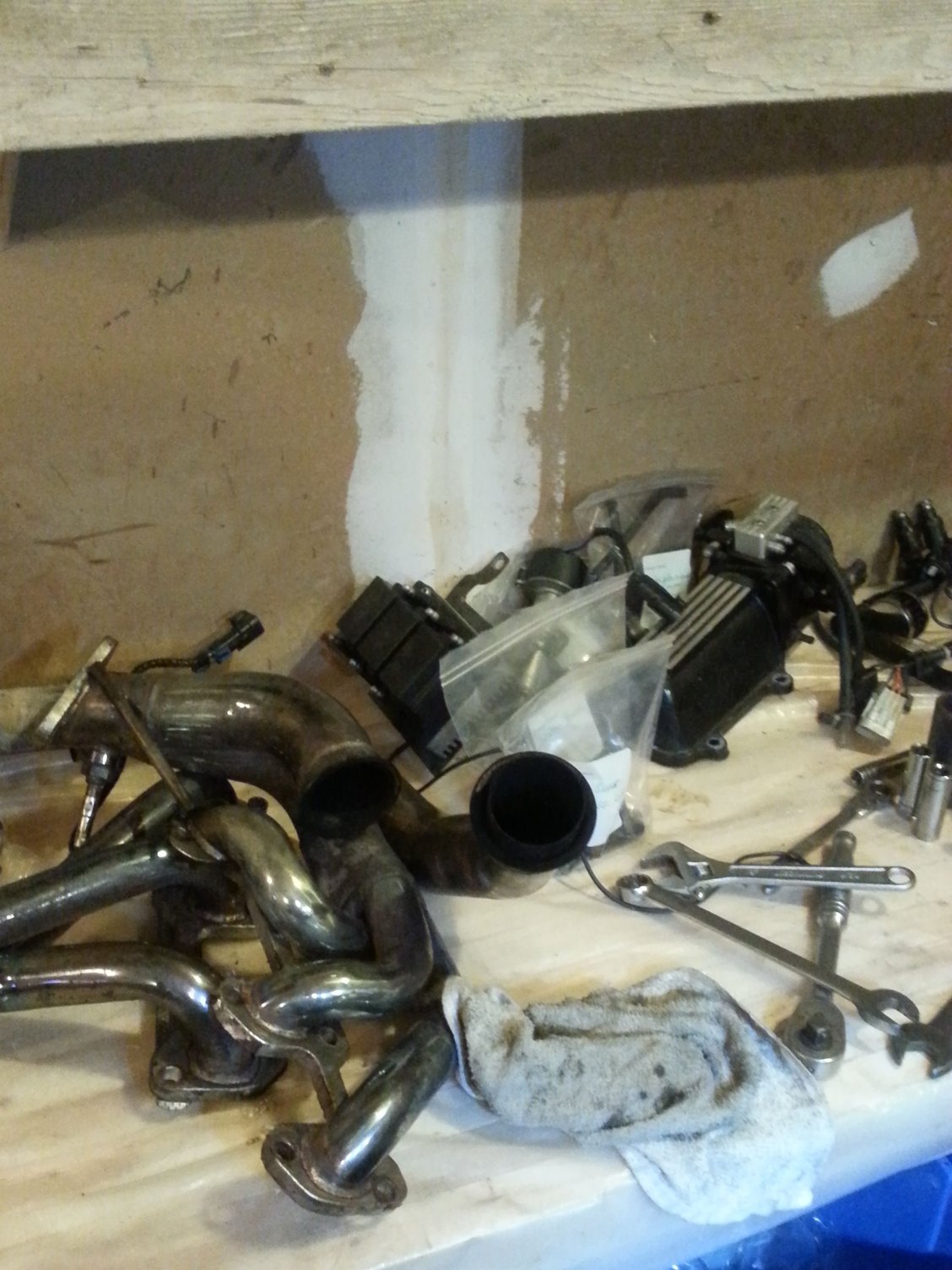

Re: Turbo 3.8 or 5.3 LS?
Some pics of my new parts...

Got some work done on pulling the 3.8l out, started stripping down the engine to get ready for new gaskets and paint. Its organized chaos in my 18' x 26' garage. I still have to pull the trans, rear end, torque arm, steering box, front suspension, and wiring from the '86.
