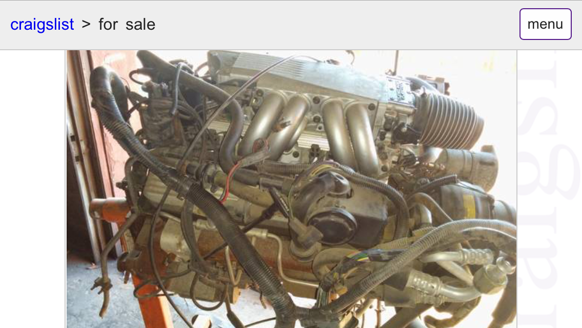

Engine is out of the car. The engine was covered and swaddled in a tarp. The rear is rusted pretty bad but not going to buy it unless he gives it to me lol. The engine from the pics is pretty clean. I'm sure there will be some cleaning to do but as far as the engine I think it's solid. Swapping into my 92 Z
I mean whats the story with the formula? Why is it apart?

Here are pic ttop
