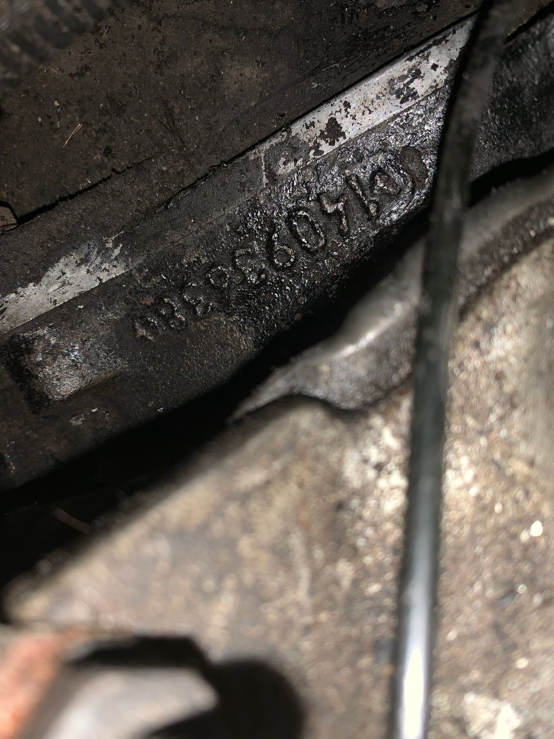

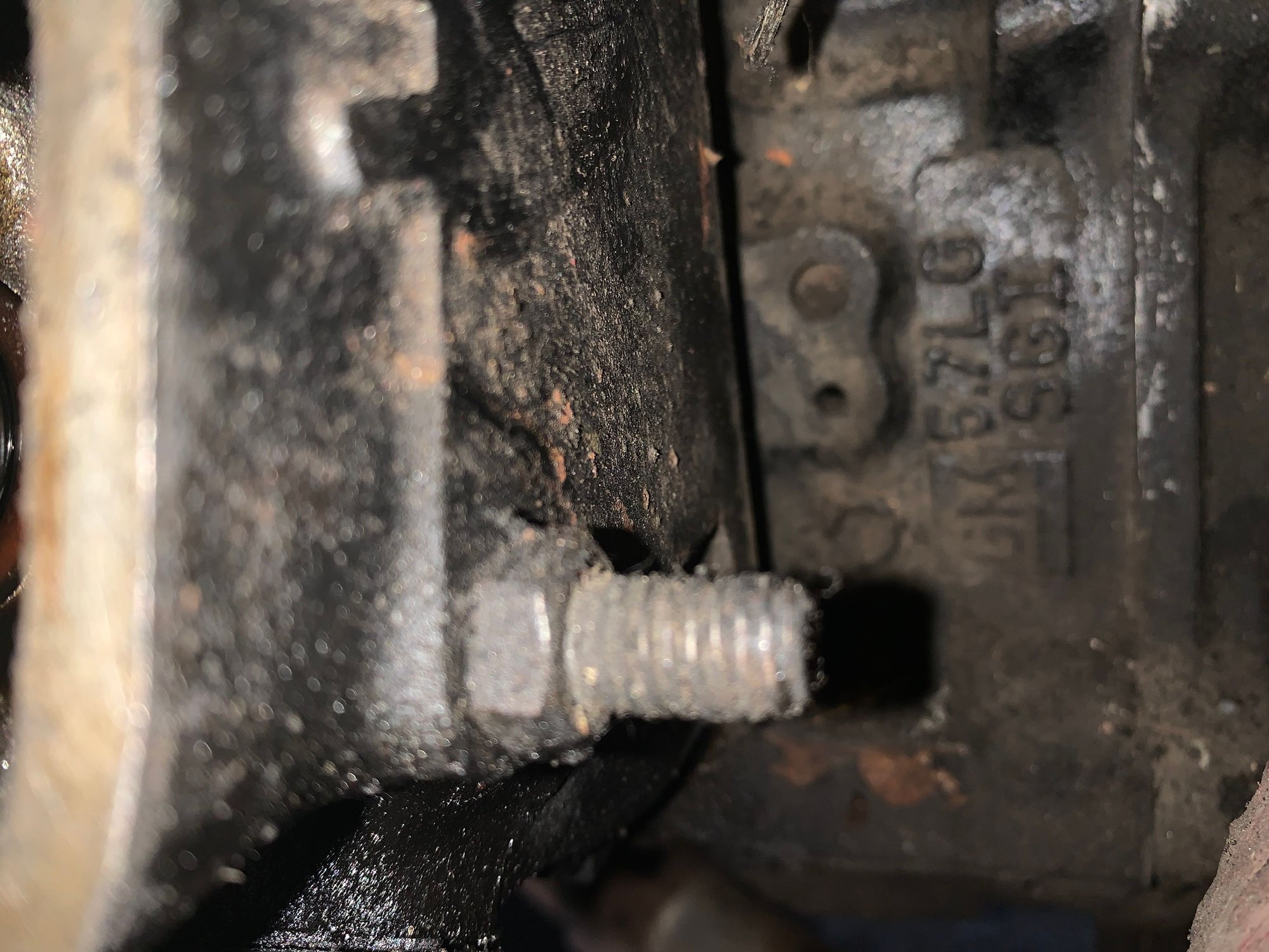

I have a 350 in my 85 and I’m curious to figure out if the guy I bought the car from put the wrong water pump because I was told the car had an original 305 with a carb and intake manifold put on it but to my conclusion it’s a 350
Old Jun 11, 2021 | 02:28 PM
Posts: 27,918
Likes: 2,448
Re: '86 LG4 305 to 350 swap question
"Water pump" is not a function of 305 vs 350. The same accessory drive systems fit both. The WP goes with the accessory drive system.

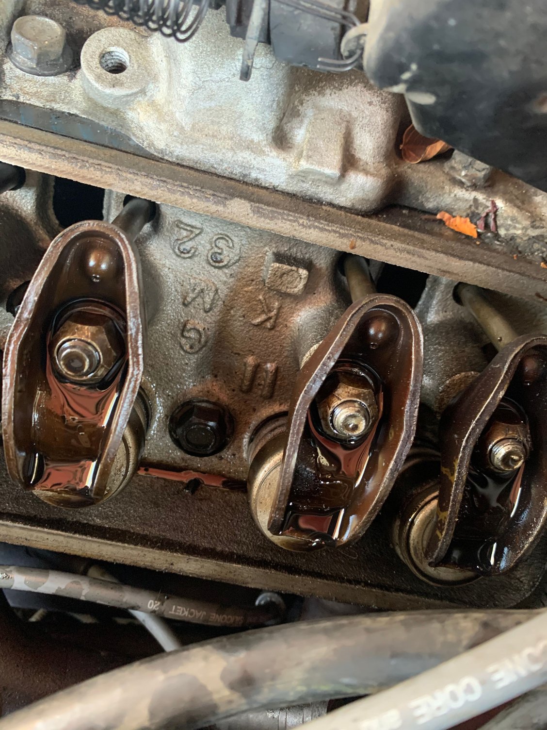

The head casting you have, came on TBI 350s such as trucks and Caprices. Your block says 5.7 so it's a 350 as well, might conceivably be a whole factory motor, not likely but not impossible either from what you show. Probably 99.99% of all motors used in a swap like this aren't factory motors though; they're "rebuilt", which means that all the parts and pieces have been randomized to some extent. Which in most cases matters very little or not at all to anything external to the motor proper (like ... water pumps) since they're all so similar. None of that has anything to do with which water pump is right for your setup or which one the PO put on it.
Why does your water pump seem wrong?
Old Jun 12, 2021 | 01:59 AM
Blkjohn's Avatar
Joined: Jun 2021
Posts: 3
[QUOTE=sofakingdom;6429622]"Water pump" is not a function of 305 vs 350. The same accessory drive systems fit both. The WP goes with the accessory drive system.
Why does your water pump seem wrong?[/QUOTE. I was told when I bought the car it was a 85 rs with a 305 after tuning numbers it came back as a camaro with a few z28 options now I I went under the hood to see what the the block read now as u see it came back 5.7 now the guy I bought this car from said it was runnin a lil hot but wasn’t to sure how acturate the gauge was now he replaced the radiator replaced the pump and took out the thermostat now I was told that the 305 has a reverse flow water pump by two guys that say they know this but I can’t get any directions on identifying this from the correct 350 one do I just pull the old pump off that I have on it and just open it up and check the hope file for the best with this new 350 pump I got

Therefore the choice of WP depends on what accessory drive system you have, NOT 305 vs 350. (which incidentally, I found the block casting # in your pics, it's 638, which is a 350) And, not the heads, not the block, not the PO's diarrhea of the mouth. Only on the accessory drive system.
Which one do you have? Do you have the correct WP for that system?
