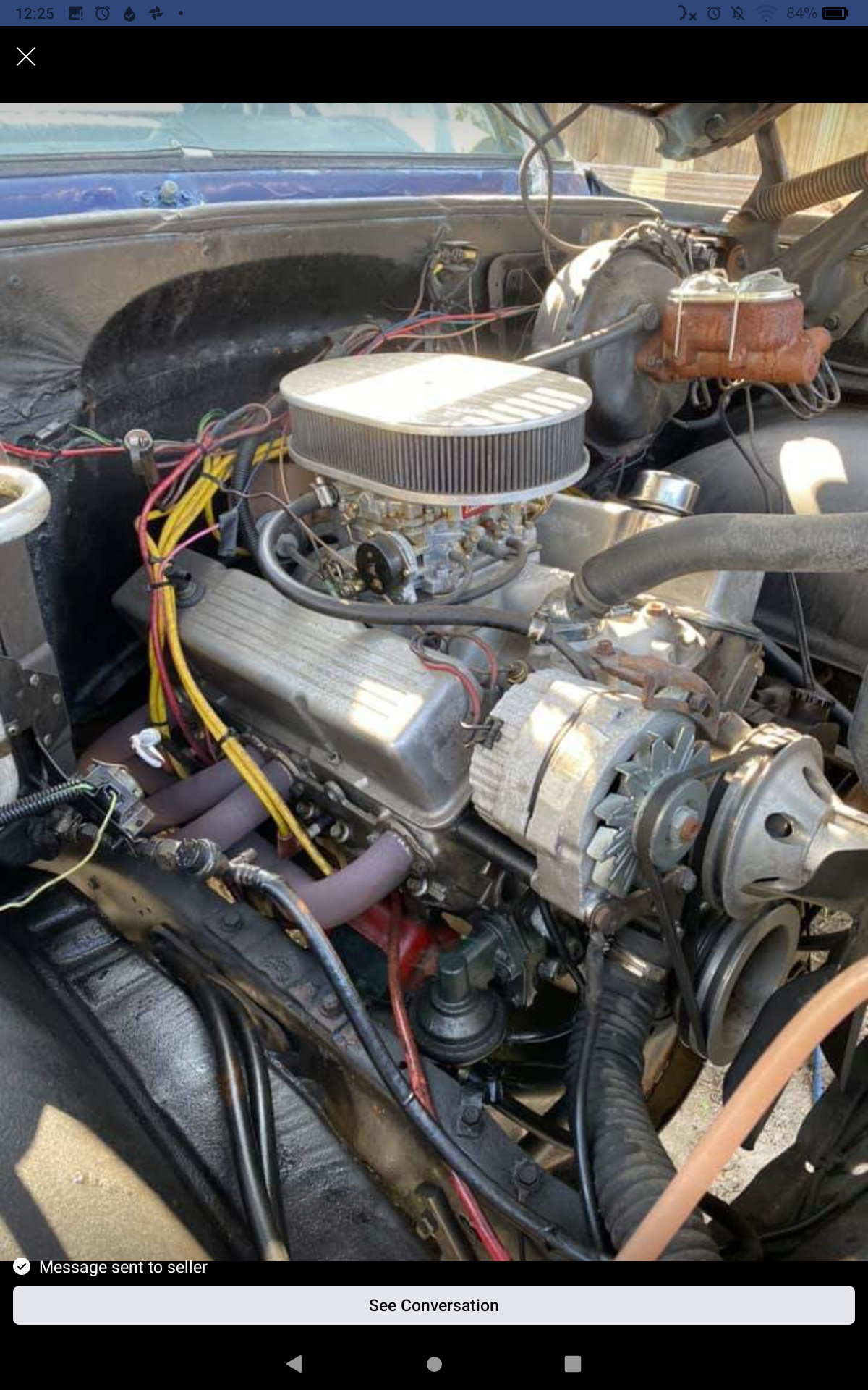

Found this right down the road for 900. What do you think?Motor was completely resealed all new gaskets , doesn’t leak a drop
Runs perfect
.390/.410 cam
New elderbrok carb
high rise intake
High rise valve covers
Comes with a set of hooker headers
New fuel pump
Hei distributor
New water pump
Aftermarket aluminum pullys

What is it ?

Option 2,upgraded SBC far easier and "cooler" than a "trendy"LS swap...swap to upgraded sbc can be done in a weekend with no special parts needed.
The engine in the picture looks like it is probably original to the ~mid-80s squarebody truck it is in: 207 350 block,76cc '624 heads,might be 4 bolt main.not really what you want to upgrade an '88rs with,and about $400 overpriced.
Not suggesting you should do this,but this is what I would do if a stock 305 '88 RS ended up in my driveway: 88-91 'vette 350-swap pan and pickup to f-bod,modify/upgrade the TBI as needed,upgrade exhaust.shift kit original t700,3.42 posi. Totally era correct ,but big,big upgrade over stock and easy turn key reliability

Originally Posted by 88fastcamaro
New elderbrok carb
All that high rise **** ain't gonna fit under your hood.

If the best ad copy he can come up with for it is the 929 cam (the stock .390"/.410" 194°/204° POS used in basically everything from later 283s on up through 70s smogger 350s) and "high rise valve covers" and a set of headers that are about 99.99999% certain WON'T fit your car and a "new fuel pump" that you can buy at AZ for about $15, there's probably nothing else INSIDE it worthy of mention either. All in all it looks like yerbasic 70s smogger crap with 165 HP that's possibly been downgraded by putting in pistons that have even more deck clearance than stock, meaning its compression ratio is now likely 7.x:1.
Pass on this one too.
