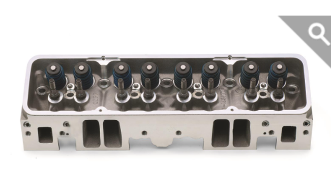

And if these are your heads below:
Then you'll probably find that due to the Vortec port shape at the head/manifold surface, a Vortec intake is better suited as the fitment matches. A traditional SBC intake may be too large and port alignment goes out the window.
