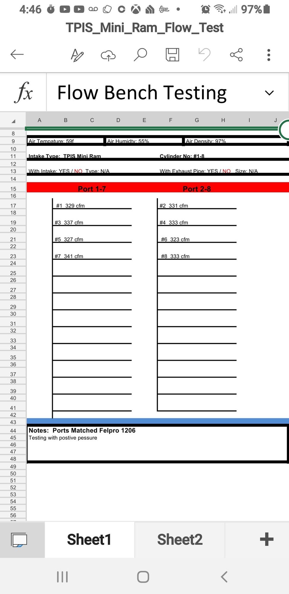

First was I sent out my miniram to Brent Scott at Blitz Cylinder Heads. Mine was untouched out of the box with just a 1206 port match. Usually these flow between 285 and 300cfm. He did some work and it picked up a bit of cfm. Attached screen shot of numbers:

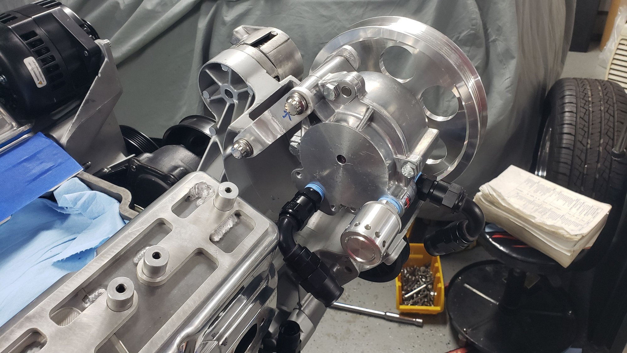

I had a catch can Mighty mouse unit inline with my pcv setup and was still getting oil in my intake. They redesigned the can and I need to pay even more to upgrade the inside of it which I may not do. Not happy with them as when I purchased they said it would be what I need. A few month after I purchased it they redesigned the can. Oh well. I have a bit more blowby then most because of the .028 ring gap for nitrous. So I have installed a GZ vacume pump. It was mind racking trying to get this into the factory serpentine belt setup, but I got it done. ASP underdrive crank at 5.5 inches and the GZ vacume pump at 7.5 inches puts me at 4700rpm , under the recommended 5k max. Had to make custom brackets and put it into the old ac spot.

When I reached out to Bill at GZ he really didn't have any insight to putting this pump into the stock serpintine brackets. I was just looking into trying to get the rpm of the pump under its max. With their pulley and with my under drive crank I get it there. The other was making aluminum brackets. Just regular aluminum bar stock from Ace hardware and a torch and a vice and a grinder. It works. I'm probably in the same boat as you with the gapped rings and blowby. I have that dam lip seal leak I fixed but I dont trust it without the pump.Since its street I'm only going to run a low vacume number. Biggest hurdle is getting in the belt drive. Other than that I did 2 other mods I forgot to mention. I used morosos equalizing plate on the fuel pump plate. Used a 12AN orb to 10 AN there. You have to use the motion raceworks fitting for this. They make them. Only reason is I tried numerous other brand fittings and returned many ( Thanks Amazon)because the thread part 12AN orb the threads hit the block because they are too long. Motion raceworks makes a short thread 12 an orb to 10 and which is what I have. Its to equalize the bottom sump to the valve cover in terms of vacume. Hose from equalizing plate to pass valve cover. Pump draws off drivers side.
