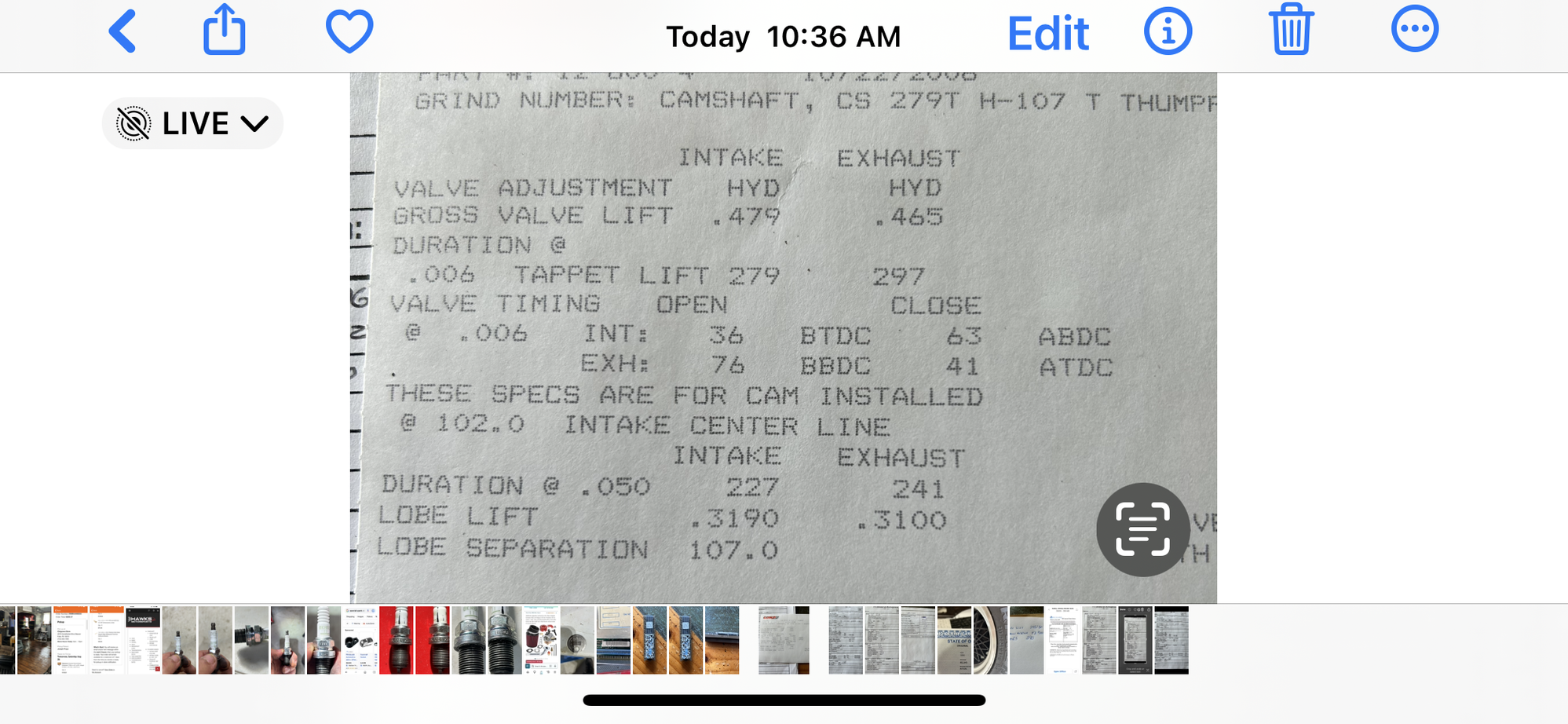

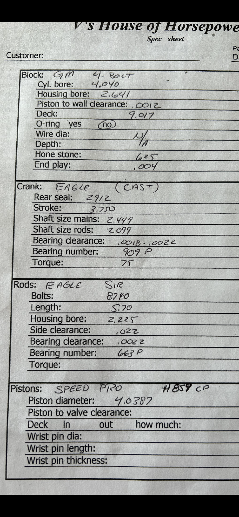

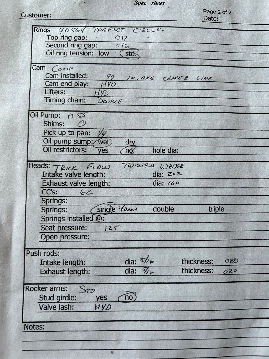

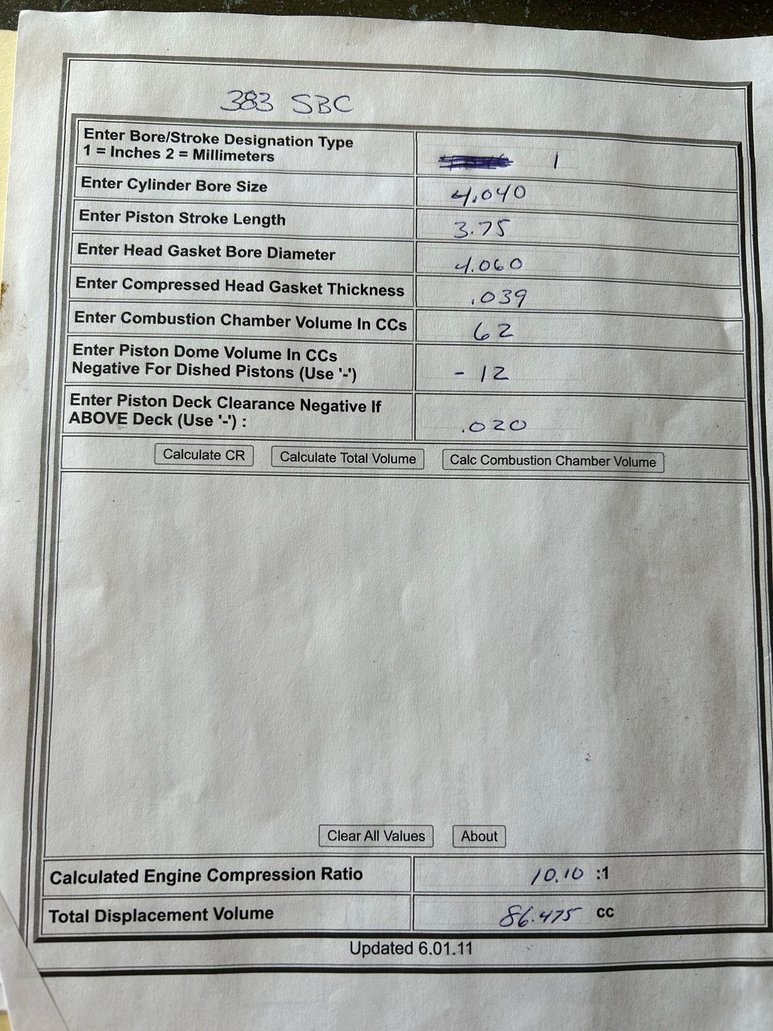

Professional build sheets below.

I can think of few worse series of cams you could have put in there. That's likely to be one of The Problems, if not The Major Problem. Might want to try something more specifically designed to the requirements of TPI (if indeed that's what you mean by "multiport"). I'd suggest one more about like this https://www.summitracing.com/parts/cca-08-501-8 or this https://www.summitracing.com/parts/cca-08-302-8. If it's an older block you might want to have them grind it on a "retrofit" roller core. You'll need link-bar lifters and a cam button to go with it.

Throw that Thumpr cam in the trash.

Your tune is probably wrong for your combination, also that cam is very not what the TPI wants.

Exactly. Not sure what "cheap chip off the internet" means, but yeah the tune is likely all wrong and that cam is probably not suitable for a street car let alone for EFI.

That series of cams is designed for poseurs who want to wow all the 8-yr-olds at "square inches of krome" contests in grocery store parking lots on Friday evenings. Which is not to say that that's not a "valid" objective; after all, if that's how somebody wants to use their car, it's not hurting anybody else so why should I have a problem with it; only, it's NOT consistent with making the car produce the most power, be the most fun to drive, and all that. And worse FOR YOU, TPI requires cams to specifically support the "tuned" aspect of its runners; a cam that "lopes" equally specifically DEFEATS that feature. Get it OUT OF THERE, put a TPI cam in, and get a decent tune. There are people on this site that can help with that.

That cam is not a bad cam, just flat out wrong for a speed density closed loop EFI system with an ancient controller.

I'd be more worried right now about the backfiring and the fact that it's a Comp cam...........you better pull valve covers and crank it over to see how many lobes are flat.

​​​​​​​I'd suggest one more about like this https://www.summitracing.com/parts/cca-08-501-8 or this https://www.summitracing.com/parts/cca-08-302-8.
Still the same recommendation. Nothing that's been posted since then has altered it in the slightest.
There are other vendors that can supply cams in this general range. But one way or another, you need to get that POS "Thumpr" out of there, and put in a cam that is SPECIFICALLY SPECIFIED as being compatible with TPI, such as these are. Between those 2 the 302 grind is probably the better for your situation.

I bought the engine complete from a long time builder it was available he had a good reputation, he was used to building 1/4 mile 1000plus hp. I was in a hurry mistake one the car is actually my son's 17 and I didn't want to wait all summer to finish it. To top it off I have Zero experience with TPI, my last car I sold 6 years ago was a 68 Road Runner 440 I actually enjoyed working on it.

What pistons are in this motor?
What's the deck clearance?
What's the rod length?
What heads are on it?
What's the car gonna be used for?
Start with the basics.
