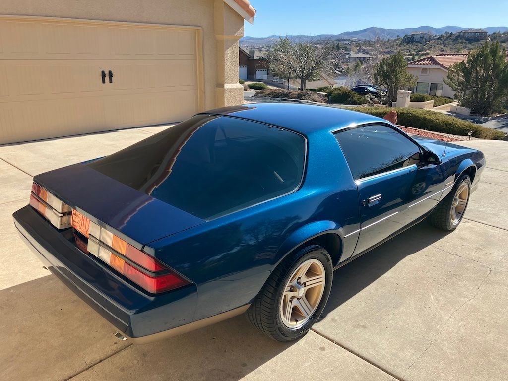

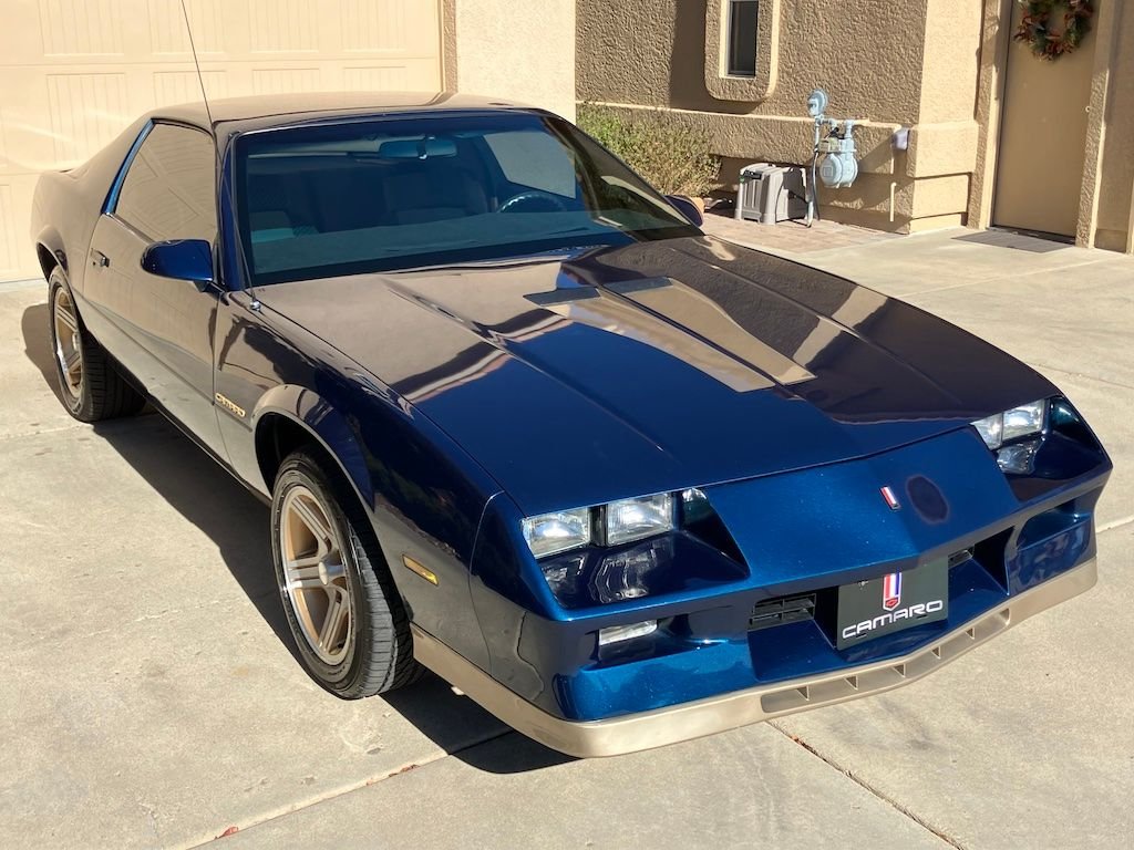

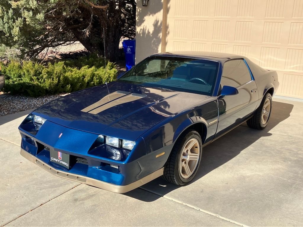

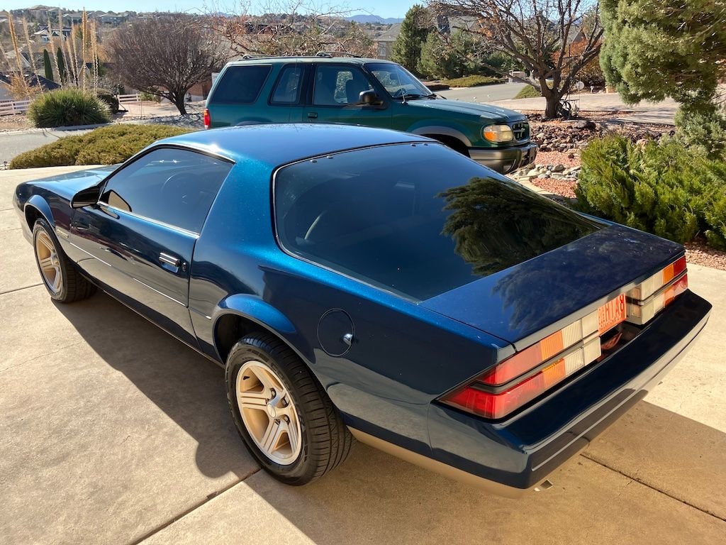

I'm flying to Denver on Thursday to go get my old 84 Berlinetta. Decided on an ATK HP98 350/345HP/400TQ iron head motor.
9.1:1 compression so it will still run on 87 octane. Yes, it has a Z28 front end. 3.08 or 3.23 gears (have to check when I get it).
700r4 auto. Bose sound system on the pod...hope I make it back in one piece! LOL
Some pics...

And here's the final pics of the 84 Camaro. Couldn't put on the spoiler due to warping issues on two of them in a row.
Just got it detailed, ceramic coated, etc.
