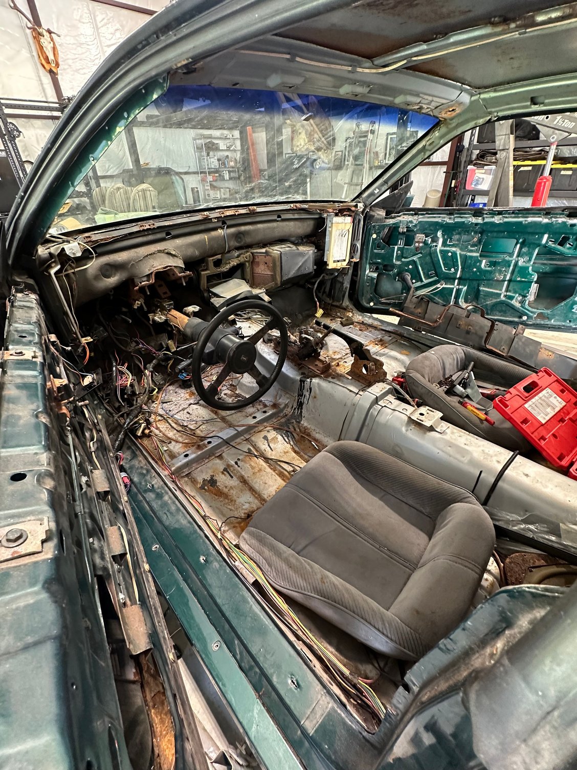

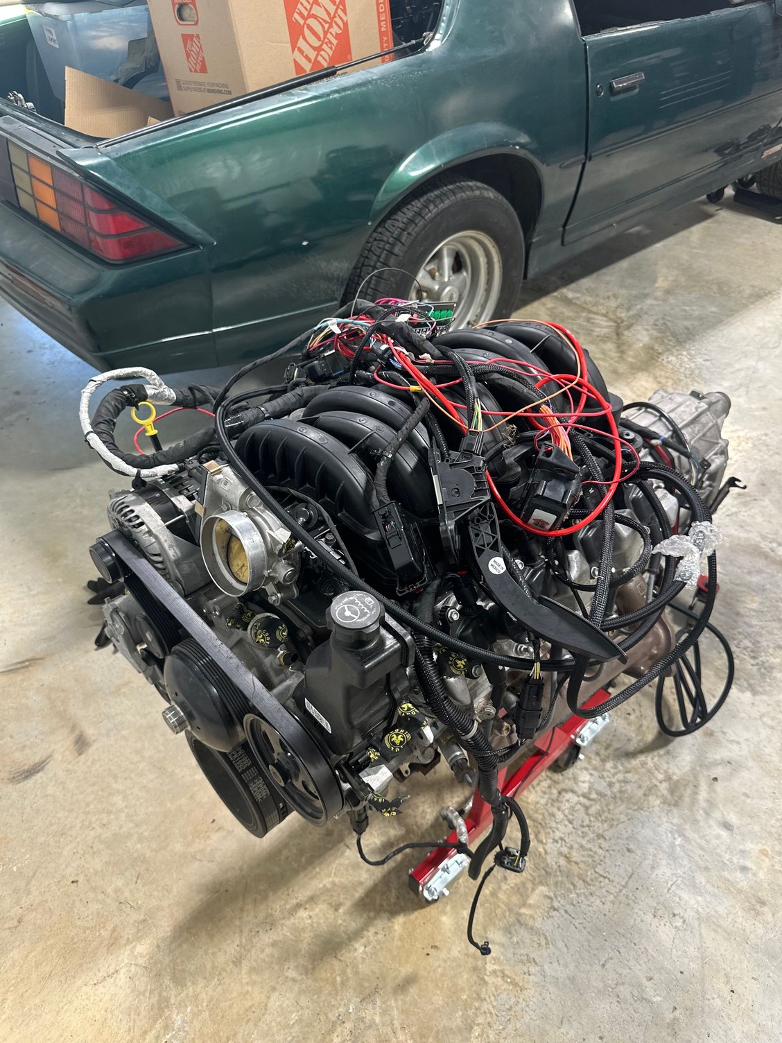

Starting in on Gen V 6.6 / L8T (gmc 3/4 ton) and 10l80 Tahoe trans in a ‘86 Z28.
Haven’t test fit engine, only removing parts at the moment. Have Aeromotive fuel system, Swaptime harness, Misc install parts already. Need get recommendations on motor/trans mounts, sort out a torque arm, etc. and then get after it.

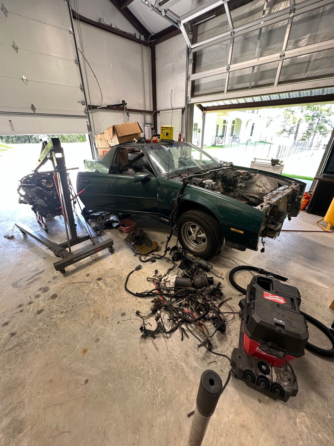

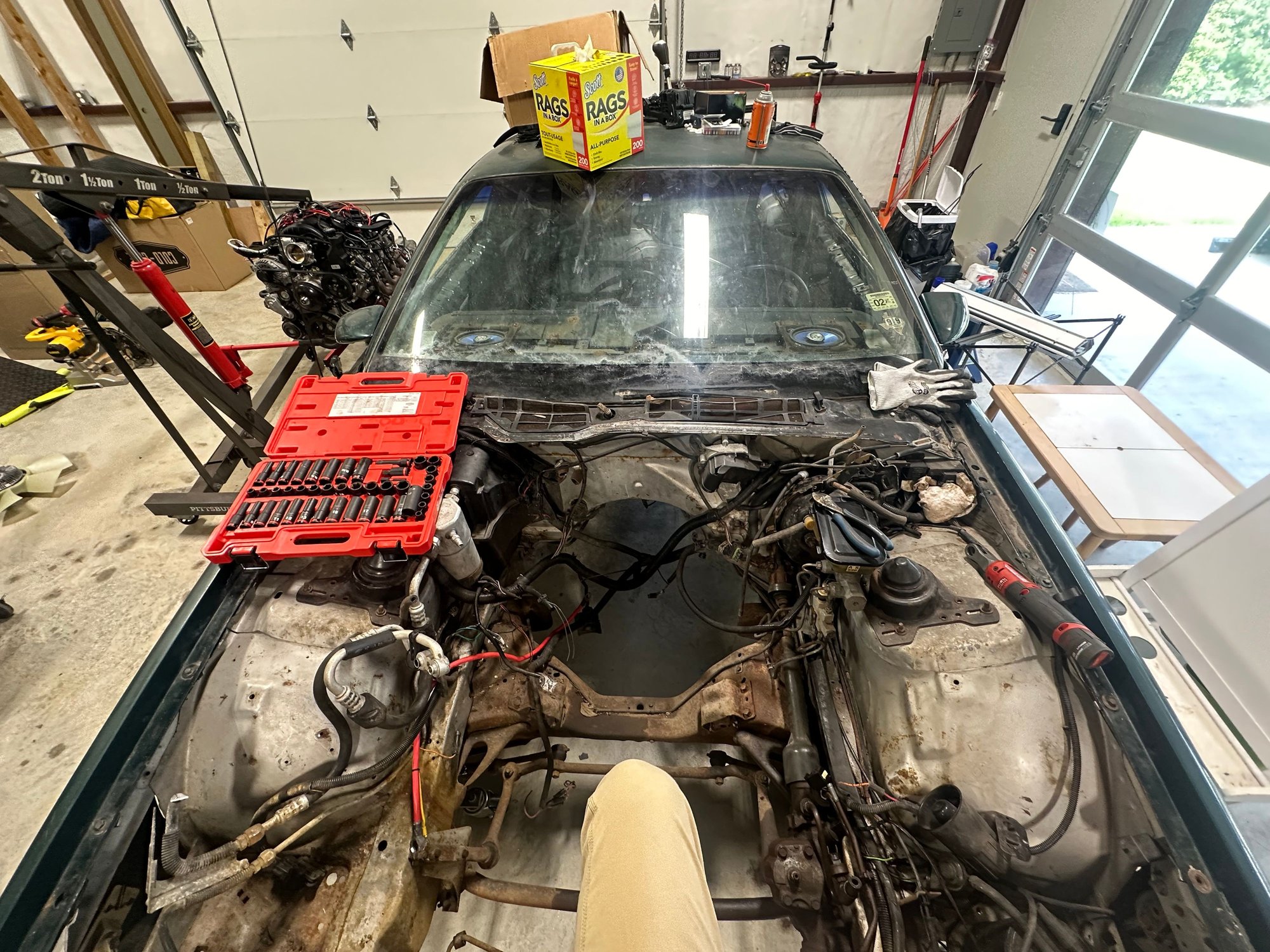

More gutting this weekend getting ready

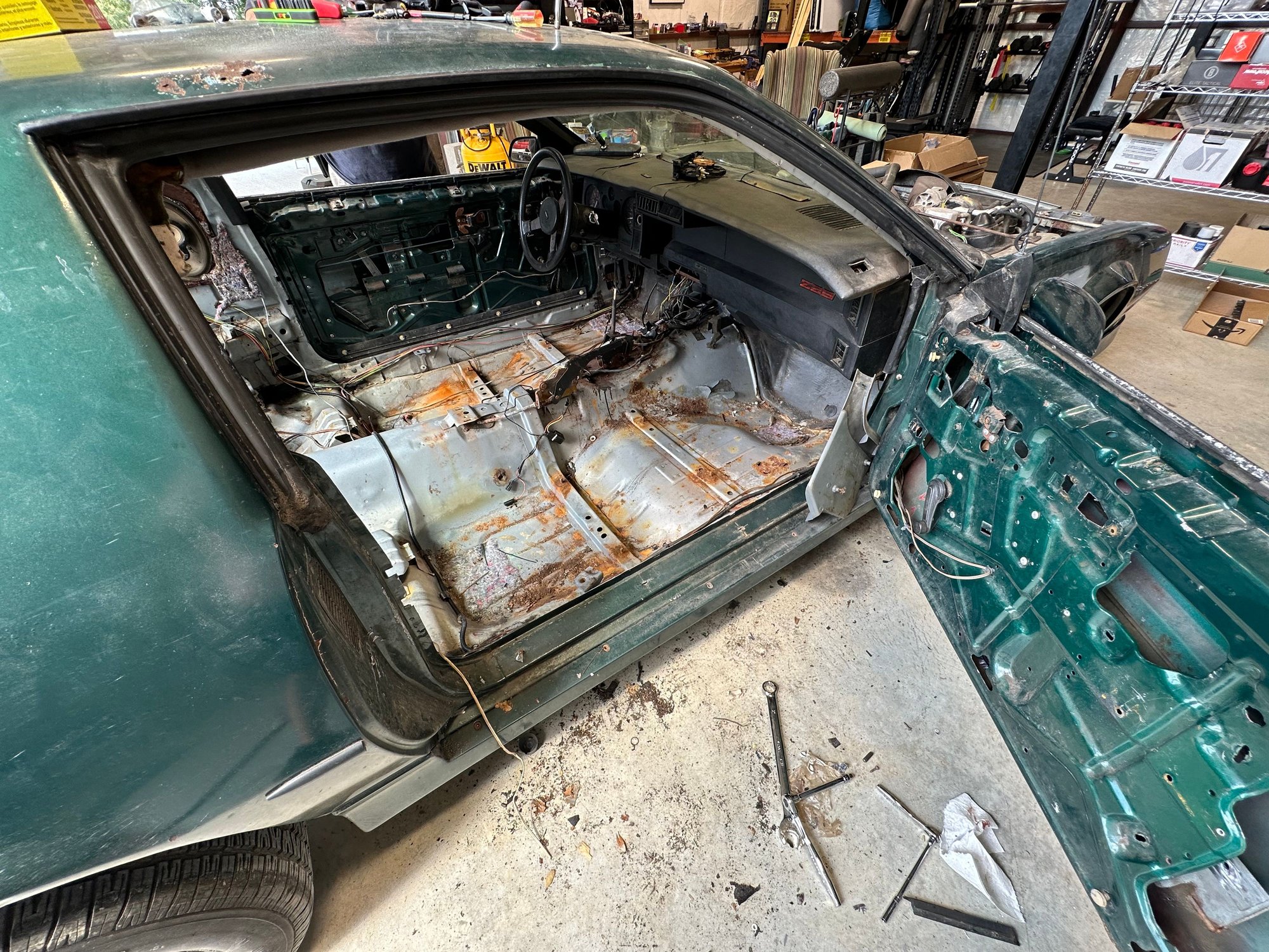

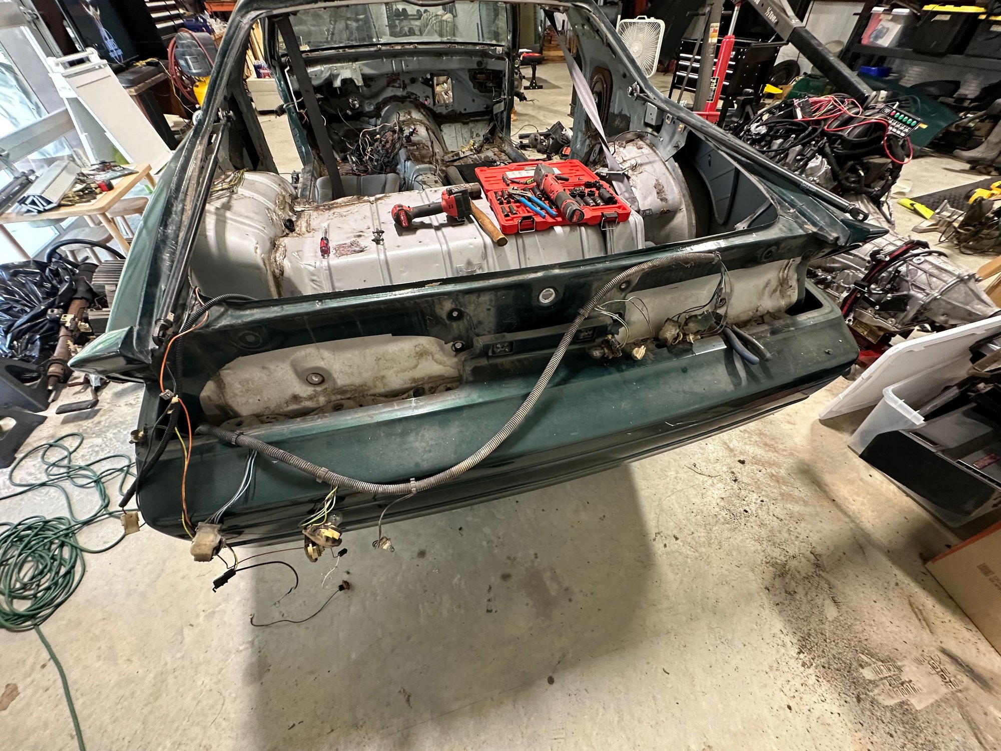

More tear down, super bad cowl/firewall rust y’all have any recommendations on that other than start cutting and patching? Going to sandblast whole frame, then start assembling, can’t decide if I’m going LS K-member with LS->LT swap plate and customs trans mount, or full kit from Hawks.
