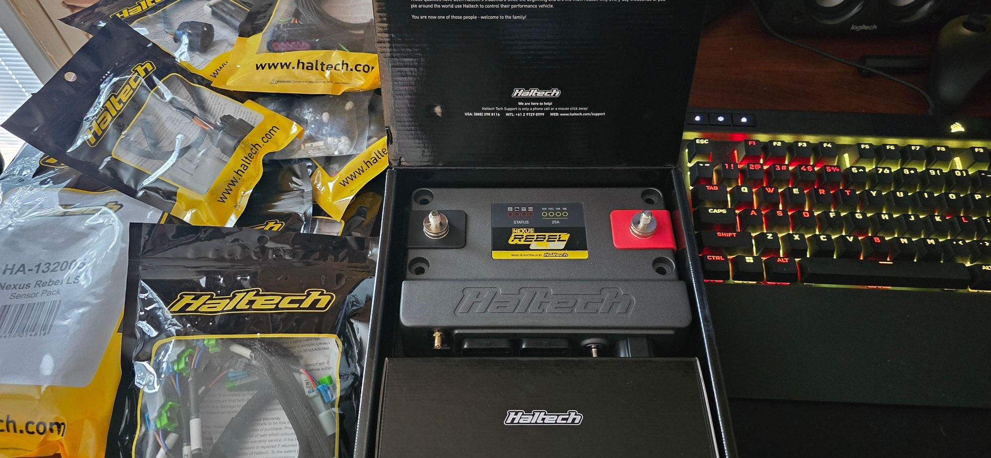

C5 alt/ps-already here
C5 AC mount for a Sanden compressor from VA-waiting on
VA surefit kit for 82-87-waiting on
Haltech Rebel LS for engine management-already here
Holley HiRam with Bosch 210's-waiting on
Tick lvl 2 T56 with a Monster LT-1 sc twin disc-already here

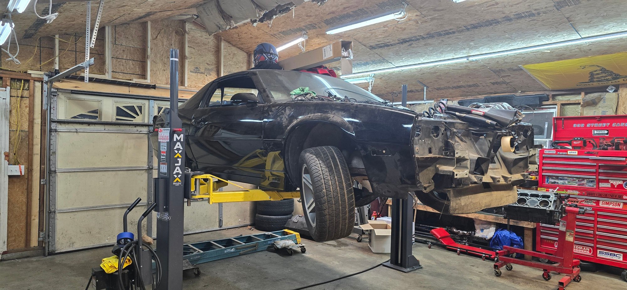

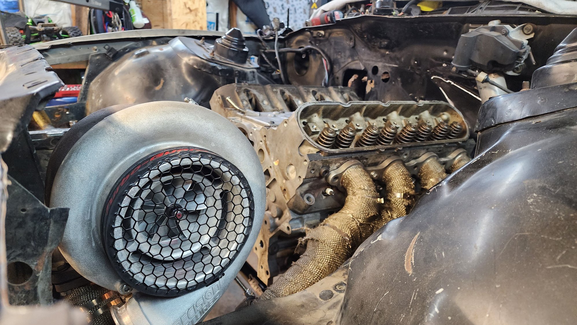

Not much to see just yet. Car is on the lift with the interior and engine bay stripped. Waiting on boxes to show up. But i have a few. Also stuck one in there of when I mocked up a turbo system last year but decided I'd rather move forward with the blower setup.
