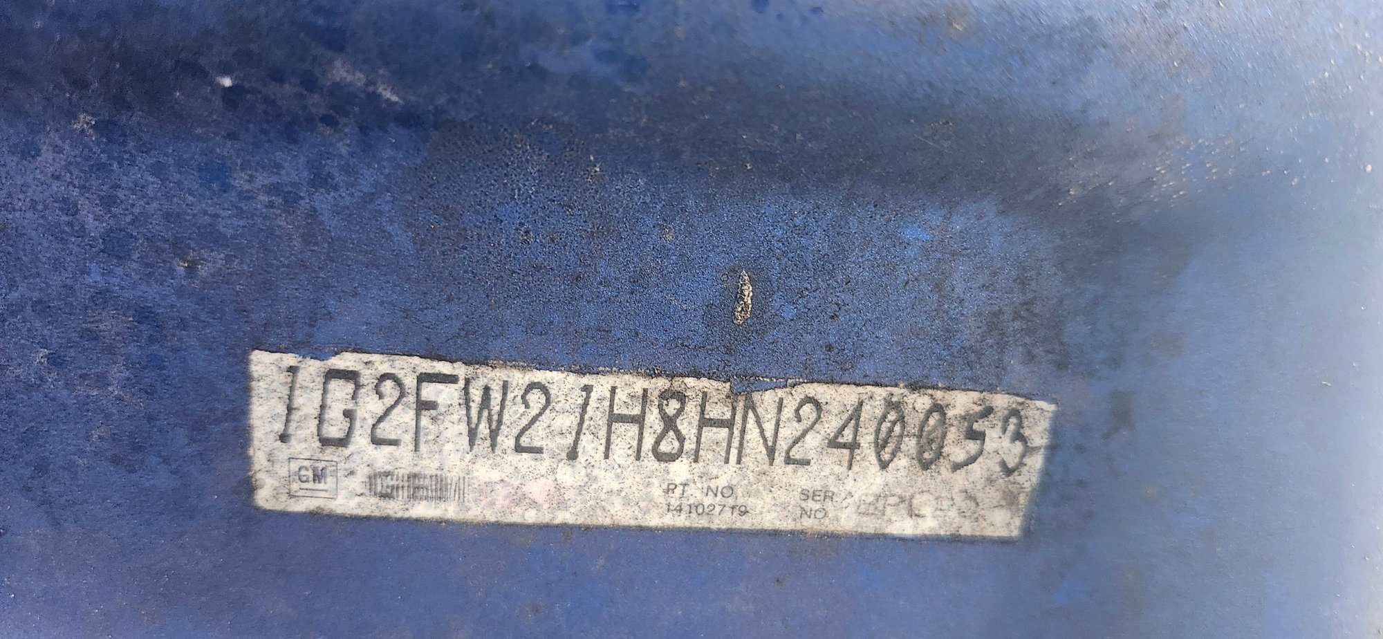

No need for photos.
What's the 8th digit of the VIN?
Not like it really matters all that much though if you're just gonna downgrade it to a 283.

No need for photos.
The 8th digit is a 8
Old Nov 20, 2024 | 10:10 AM
Posts: 28,052
Likes: 2,505
Re: Swapping in a 283
8 isn't the code for the HO 305. Pretty sure that's for a TPI 350.
Interesting this car has a carburetor so it's not TPI. There hasn't been any motor swaps either

Your 8th digit (well, character) is H.
That's the LG4, the regular non-HO 305, like everybody else that had a carbed 305 in their F body that year.
