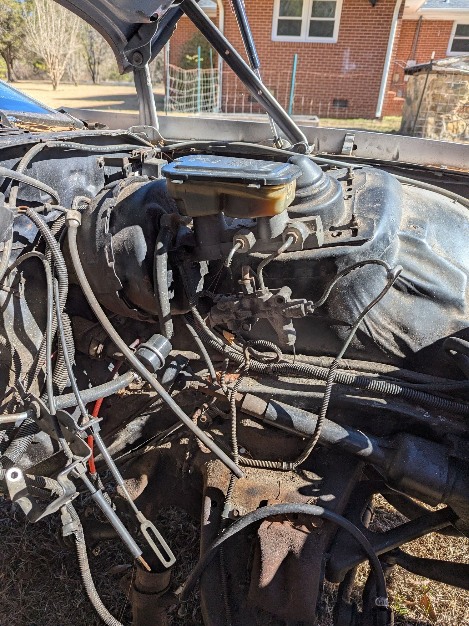

Please don't be mean or nasty, I already feel dumb enough. Now I just have to figure out how to fix it, and since it's not dead, it is still fixable.
When I pulled the 305, I realized that I bent one of the hard brake lines, pinching it off. I may have pushed the master cylinder/proportioning valve up some from the brake booster, possibly pushing the brake booster in just a little.
Part of me says gentle pressure to pull the cylinder/valve back down makes sense, and part of me says I'm gonna cause more problems.
Or am I going to need to start searching for a new booster and master setup?
Can you buy pre-bent hard lines, or is there a shop that I need to contact and they will know what to make?
This is all new and I'm continuing to learn every time I get up.
Thank you

If a line is kinked, then there is no fixing that area. You can cut a little away from the damage and reflare to use a union. Beware, 3rd gens use metric brake lines. Most flare tools cannot sufficiently grasp the factory lines to reflare. If the line is relatively short, it is often easier to just replace it entirely
Post a pic of the damaged line and trace where it goes. We can't offer much help without

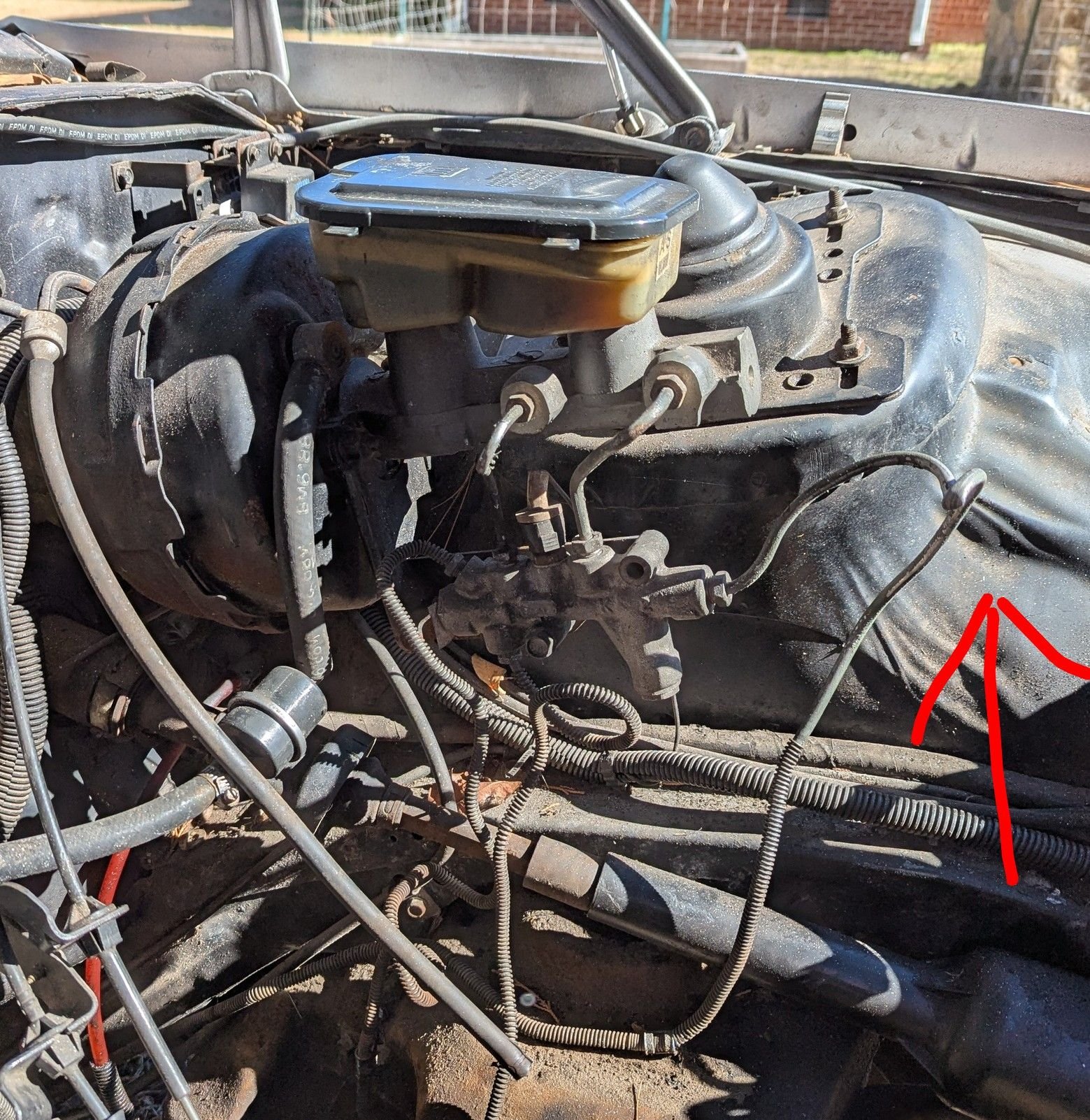

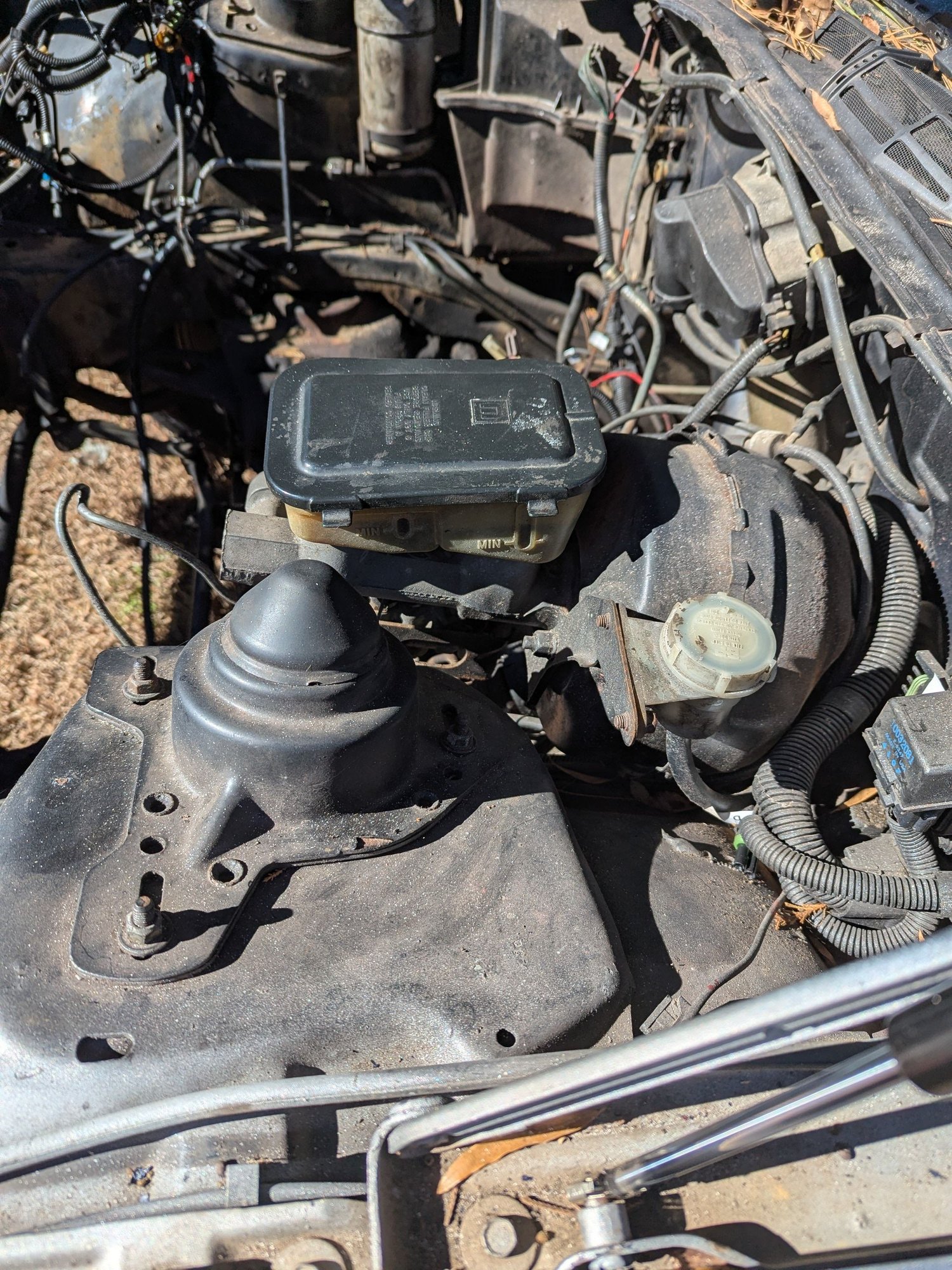

I've attached several pics to show what I mean. Hope these come out well enough.

Just leave it alone. I've moved mine around a bunch without issue

The kinked line is the long run to the rear
Easy way to identify thread type is to remove and inspect. SAE will be inverted flare (concave), metric will have an ISO bubble (convex)
Buy an fitting kit off amazon and make a new line. SS would be nice but is a pain to work with. NiCopp is more expensive, but super user friendly. Easy bends, easy flares, will turn green but never rust
Since the engine is out, it's the easiest to route now
If you plan to get alot of use out of the car, it may be a good idea to replace the prop valve with a more universal piece, PV2/PV4 or some form of adjustable. Stock pieces are known to have the shuttle get stuck

You lost the loop but it honestly looks like you could cut the kink, reuse the original nut, reflair the tube and go. Some gentle bending shouldn't be an issue

All part of the experience! Plenty of good advice already given on here. I'll echo what's been said a few times though in that your brake lines are most likely SAE if they're original to your 84. 82-84 had SAE nuts then they swapped over to metric in 85 (if I'm remembering correctly!). Ran into that with my '83.
Don't worry about the angle of the valve, it'll work fine.
