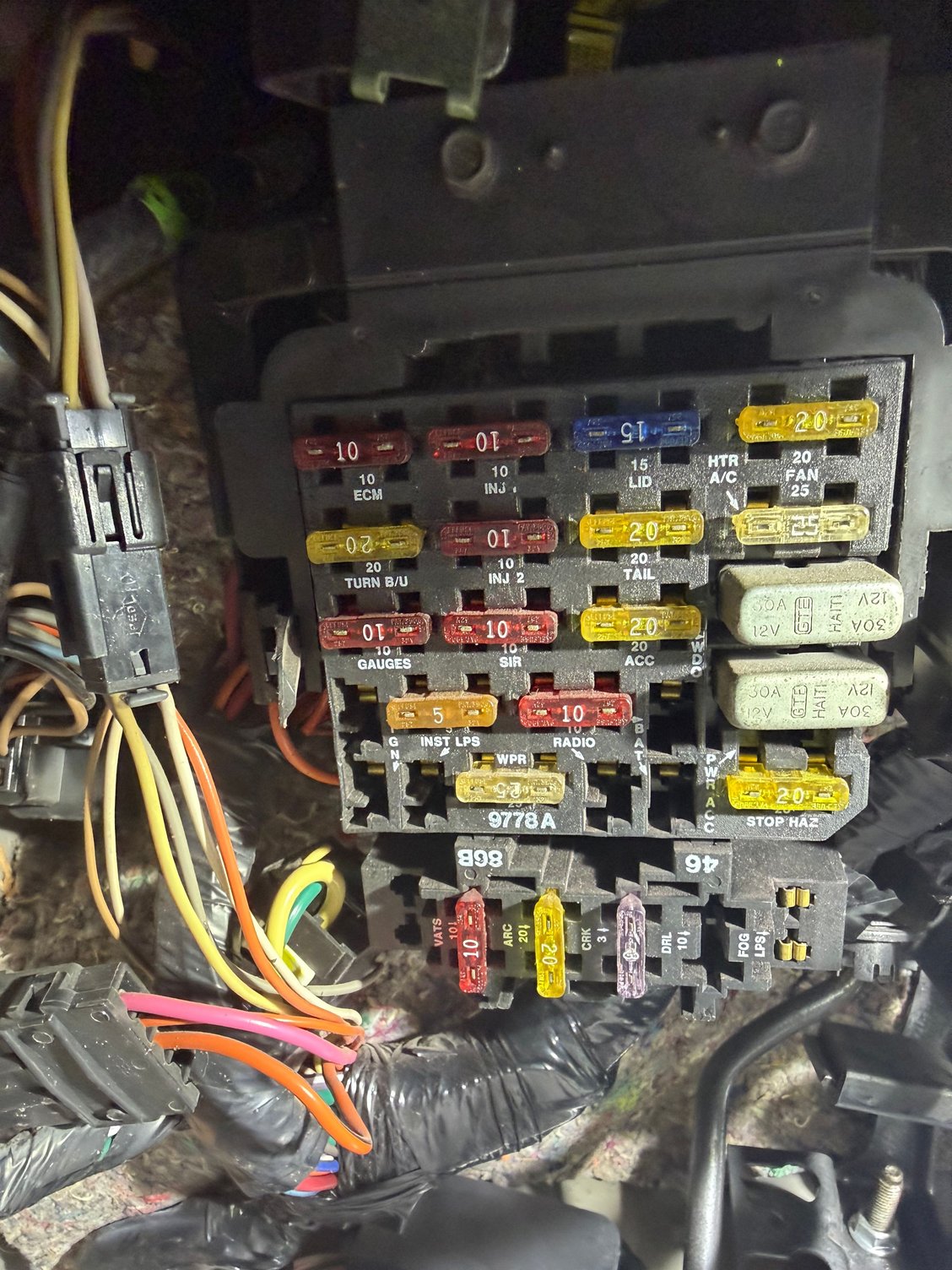

I’m working on a 1992 Camaro (3rd gen) with an LS swap using a PSI conversion harness, and I’m trying to power up the factory body harness / fuse block for the first time.
The battery has been relocated to the rear of the car, and I have a front power distribution block with constant 12V available.
Right now I’m trying to figure out where to apply the main always-hot 12V feed to wake up the factory fuse panel.
Looking at the fuse block, I see the area labeled BAT next to the RADIO fuse and the PWR ACC section, but I’m not sure if that slot is the correct place to feed the main battery power for the entire body harness.
Questions:
  1. Where does the factory main battery feed enter the interior fuse block on a 1992 Camaro?
  2. Is it supposed to be fed from the back of the fuse panel through a stud or large terminal, or through the BAT slot on the front of the fuse block?
  3. What wire in the factory harness is normally the constant battery feed (color and gauge)?
  4. What wires should I look for that correspond to:
    • IGN / Key ON
    • START / crank
  5. If I want to power the body harness and starts testing test lights/wipers/etc, where should I safely apply 12V? I was going to use 12v with a 100a breaker to power the body harness but I don’t know where this needs to go
The car currently has:
  • rear battery relocation
  • front power distribution block
  • PSI LS swap harness
  • factory body harness still intact
I just want to wake up the stock body harness and fuse panel safely before wiring the ignition switch.
Any guidance from someone familiar with 3rd gens would be greatly appreciated.

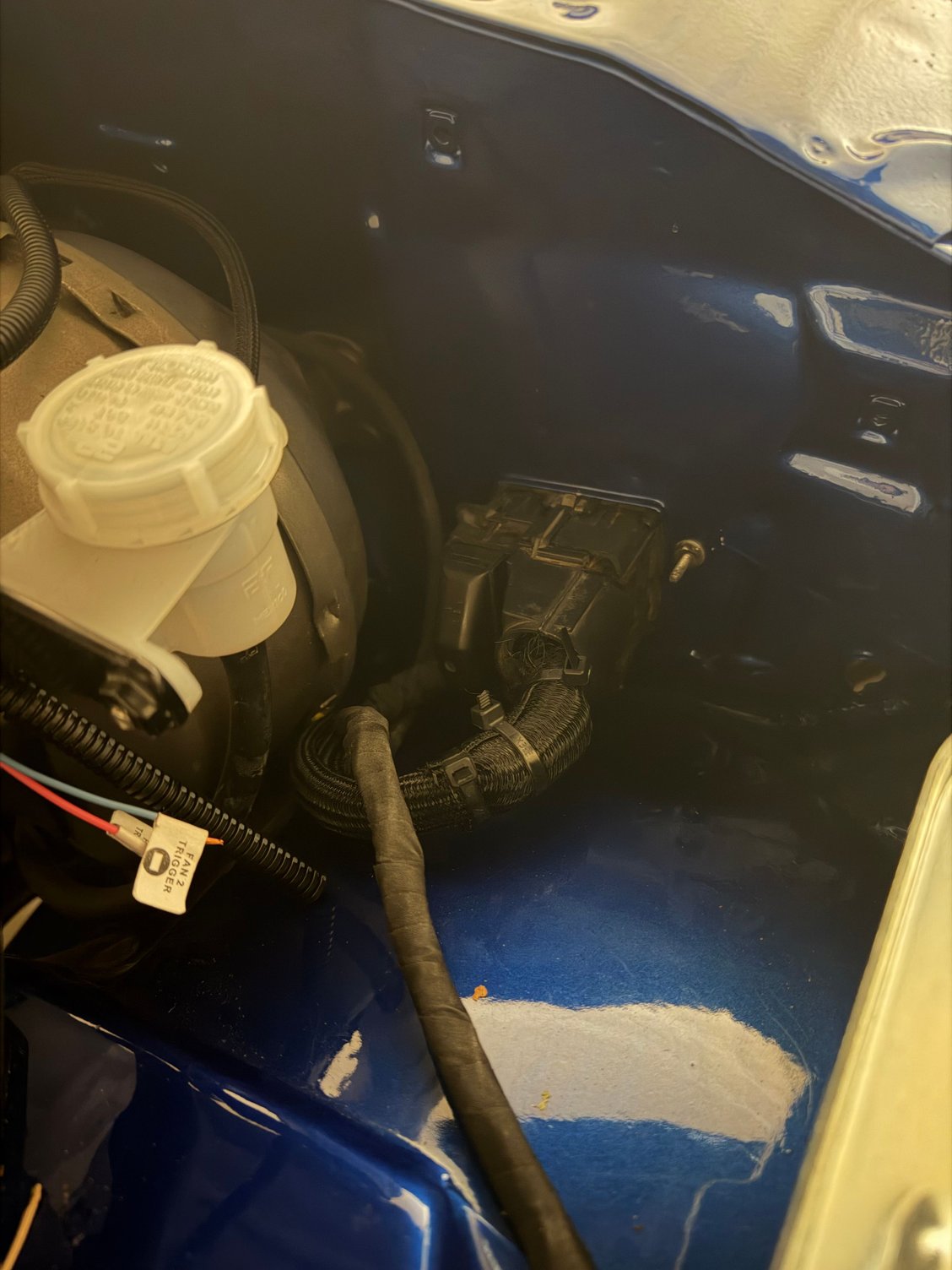

see body harness that goes through the firewall

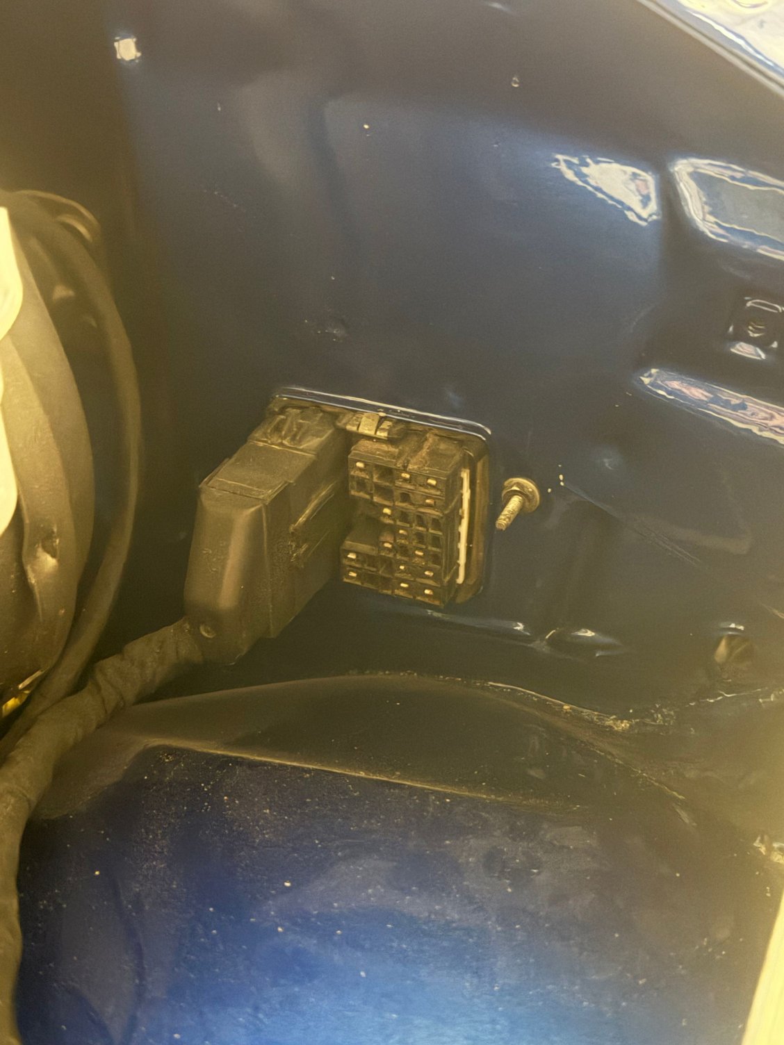

After more reading it looks like the body harness power is going through the c100 engine harness first. Could I simply buy this connector and plug it in with a pin out to the main power distribution ? And my body harness would be powered ? Or is there an easier solution ?
are there any grounds I also need to replace if my c100 engine harness connector is missing ?

On my '89 Firebird, all the chassis is powered by two 12 AWG red wires that go through the C100 connector. Fusible Link 'A' runs most the lighting and such, and Fusible Link 'B' runs the dash, HVAC fans, and other things. Both these are connected to power distribution in the engine bay. I cut off the fusible links and tied the wires directly into my new power distribution. Sorry, I don't remember the pinouts in the C100 for these two wires.

Yes, the power is coming in through the C100 connector. Yes. You could buy that eBay connector kit but to me, it is very pricey for what it is. It does have the items that you'd need and you don't have to do any research to find the individual components but it is a lot of money for what it is.
August 2025, I purchased 5 of the engine side, C100 connector halves for less than $4.43 each from Mouser. Unfortunately, it appears that they are no longer available from Mouser and that makes the very overpriced eBay kit a little more appealing:
Aptiv 15492519
The metal terminals are inexpensive as well with the largest being the Metri-Pack 630 terminals currently selling on Mouser's website for 56 cents each:
Metri-Pack 630 terminal 12064735-L
I'm LS427/570 swapping my 1987 IROC and I'm going to be powering the interior through the C100 connector just like you're going to want to do it.

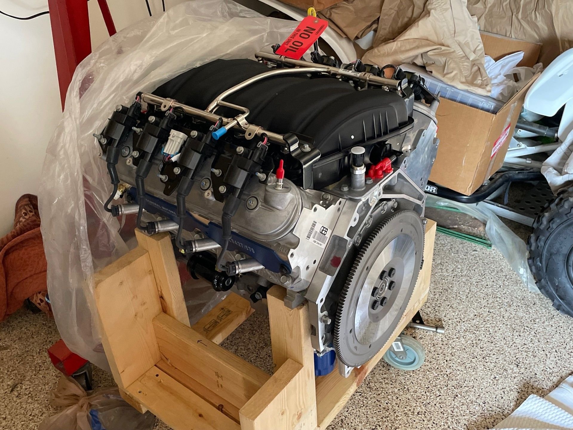

Chevrolet Performance LS427 7.0L 570 HP Long Block Crate Engines 19421004
I was lucky enough to get my hands on one of the last available LS427/570hp Chevrolet crate engines.
Here it is in the engine bay soon after my wife and I got it in.
