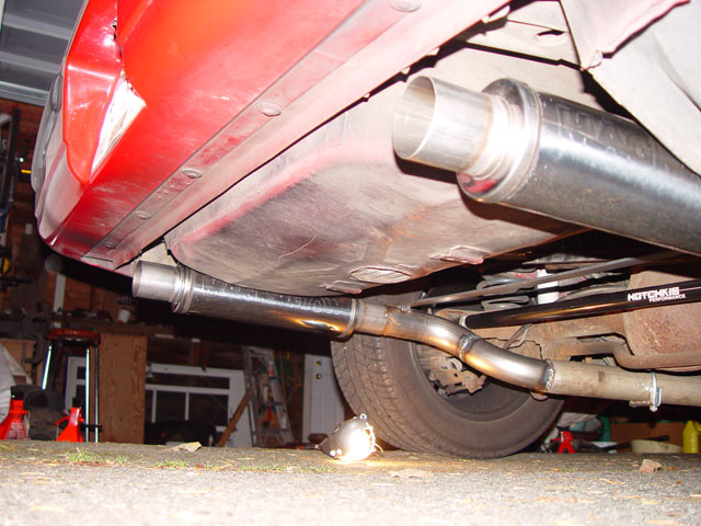

CheezX has a true dual system similar to mine on his car the runs under the axle..
I've got dual 2½" on mine, clearance is good considering a flat and nearly flat tire. It's not costly to do if you can do it yourself.

thats a pretty sweet setup man, the advantage to going under tehe axle is that you dont have to hack anything to do it, but yours looks nice and clean....i have that panhard bar too, do you have the LCA's as well?

I don't think many people want to spend that kind of money on an exhaust.
Very true, but consider the following:
1)
I paid $80 for a crossover. I didn't "have" to do this.
2)
I paid for seven 180-degree mandrel bends from Jegs and Summit. I didn't have to do this. The system could have been bent at the muffler shop.
3)
I didn't have to pay $134 per muffler. I could have used any cheap bullet style straight through muffler at a fraction of the cost.
4)
I did not have to pay $60 per hour for the labor to install the system (it took five hours). I could have gone to someone a LOT cheaper. The only reason I did not was because the guy who built my system has done a lot of work for me in the past. I wanted this system to be as perfect as possible. I paid for his experience, knowing he would build it to my level of satisfaction.
Another consideration)
You always hear guys complaining about the lack of ground clearance on their true dual systems. My design has as much ground clearance as a stock or any catback system out there. That's because it uses the stock routing.
Summary
My system could be had at less than HALF of what I paid.
Drawback
The one drawback I can think of is the fact that there is only one location for the mufflers, the stock location. Because you'll need a pair of mufflers in this position, space can be a limiting factor as to the shape of the mufflers. Bullet style mufflers are no problem. Anything larger might be.

thats unfortunate dude that alot of cash....most shops (as im sure you are aware) dont want to do this job, and in fact tried to tell me it was impossible
the guy that did my exhaust is a very unusual combination, hes really good, really fast, and really cheap. I stayed at the shop while he did the work (he prefers that for custom work, so he can OK everything with you) i got there at about 10am, i left at 12:30. completely done, fully welded....it was fairly impressive to watch him work. anyways, the custom pipe bending ran me about 300 bucks (he's a local guy that wanted his name on the project, and ive done some fence work for him in the past too) so it was a little cheaper than maybe the dude next door. i think my warlock muffflers cost me 60 bucks a piece from summit. so not counting the headers, the exhause cost about 420 bucks which is not bad at all.:rockon:
it also sounds totally unique with the warlocks (especially when you take the cap off, holy **** is that loud)

that dual exhaust running over the axle looks awesome and you dont have any ground clearance.
The shop didnt want to do mine the way it is....and it was simple to bolt on but kills ground clearance.
Going duals can be as cheap or as expensive as you want it to be.
Look at my setup...less than 390$ for everything including install and that includes the header price.
Then some guys spend more than that on a single 3'' system and do not sacrafice clearance, some guys run insane dual systems that cost big$$ but have no clearance issues...
it really just depends on how much cash you have and what you want. they say you cant do duals on our cars but you can...how you do it depends on how deep your wallet is.
