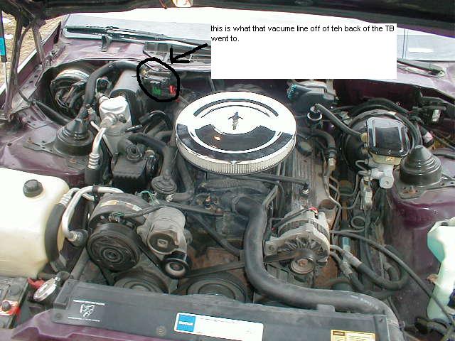

here is a pic of the thing that vacume line went to. also that airfilter will not be staying i will have my K&N tomorrow. but if anyone can tell me what that module does please do so.
You deffinately need to have that plugged in. That is your map sensor and it is very dependent on vaccuum. If you look under your hood you will see a vaccuum diagram for where everything should go and where it goes to. You also need to plug your thermac port. That is causing a vaccuum leak. You can plug your AIR tubes comming off of the manifolds. If not exhaust will come out of them and act like an exhaust leak.

i know where it goes just didnt know what it did. a friend told me it had something to do with the EGR. also can i plug them where the rubber hose met the metal tubes that when to the manifold?
