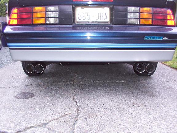

ok i put it on i placed the tips on and they look offset like one is farther out then the other side i have pics take a look for yaself or is it just me ill post pics of the way i placed it on the rubber things and help would be most appreciated

Your over axle pipe might be in the muffler crooked. Other than that try moving the whole tail pipe/muffler and see if anything's loose or you can adjust it easily. Car looks nice BTW. How do ya like the new setup??

i believe you may have installed the hanger(bracket) on the drivers side, incorrectly. try moving the bracket onto the back side of the rubber bushing instead of having it on the front of it.

thanks yeah i was wondering if that was the problem

mine are set perfectly, the only difference between mine and your is if you look from the top of mine you cant see the tips

Mine too, the tips are behind the rear bumper. Plus i got the 3.5" Chrome Slash-Back Tips from Hooker, which i like better.

where did you get that over the axle pipe hanger from? Did that come with the exhaust, or didyou do that yourself? I had to jerry-rig something till I could find something to hold it up. I basicly did what you did, only more ghetto looking!
I didnt have a problem with the crookedness. Try sliding the exhaust to the right (twars the pass side rear tire) and that might even it out. I recomend pushing the tips as far back behind the bumper so you dont burn yourself when you walk around.... quick FYI for ya!

the problem is the rubber mount on the passenger side is hard mounted while on the drivers side has a flimsey rubber mount that doesn't hold it in place.
