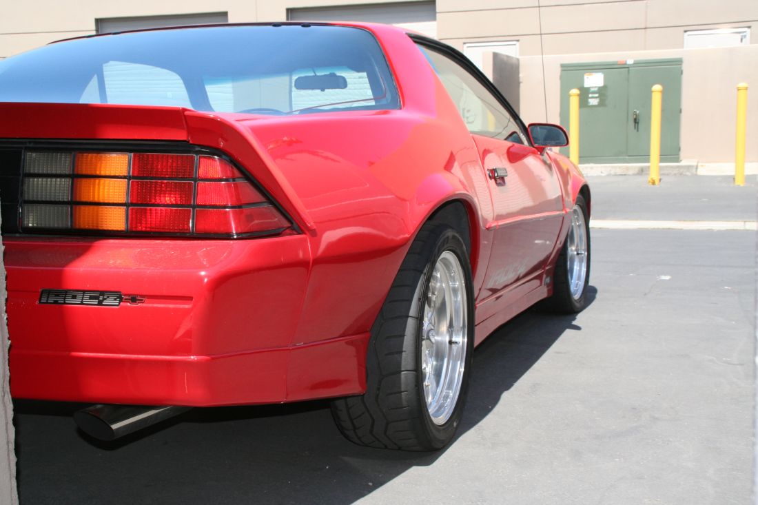

ok here is a side shot.
everything you see scrapes on speed bumps everytime and its ugly because you can see it from the side.. as you can see.
I cant think of anything to do to fix it. The only thing i can think of is that my motor is sitting lower than normal. like my motor mounts are bad.

I can tell from the pic in your signature that your car is lowered. It's going to drag. You could try changing to poly motor mounts so they wouldn't sag as much, but honestly you're dealing with a problem someone created by lowering the car. You're going to have to find a work around, it's not a problem with the headers, it's a lack of ground clearance.

is it possible that the new trans crossmember positions the trans mount lower than it should be? this could cause the angle of he engine and trans to be different in turn changing the angle of the exhaust, pointing is down instead of level

I think its a combination of the new crossmember and my motor mounts being torn up! I am in the process of replacing the motor mounts. I just dont know how im going to do that yet. I have never done that before so im am in search for directions.
