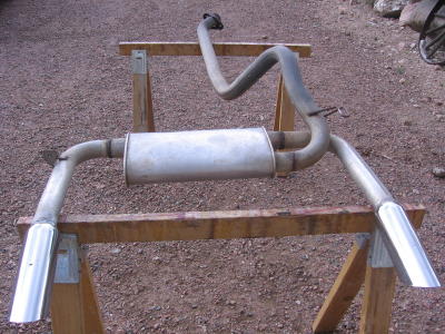

Ok, so I've finally got all the parts for my entire 3" exhaust. I have a single piece Dynomax Catback, Hooker 2055's and Y pipe, and Catco 3" cat. My question is, has anyone been able to install a single piece catback without dropping the rear end? I know the hooker and flowmaster catbacks are in several pieces you can bolt together. I'd like to do this a home, but I'm unsure if I'll be able to.
Any input would be much appreciated.
Here is a pic:

cut clamp weld i would think your going to have to cut it install it where you want clamp it then weld in place

Jack the car UP, UP, UP....
Unbolt the rear socks.....
Swing the rear end down....
And you might be able to snake the mid-pipe in from the rear, with the muffler section still attached.

Yeah, like Stephen said, I think if you can get the car high enough in the rear, it would be possible.

you could cut just as it starts to go up in front of axle, then put a stainless easy seal clamp on it . these clamps are made to butt two pipes of same diameter together
both jegs and summit sell them - look pretty good about 15.00.

You could probably just remove the passenger tire, shock, and spring. Then snake the exhaust in.

Now thats good thinking! Except the lca and both upper and lower panhard would have to come out to put it in from the side.
