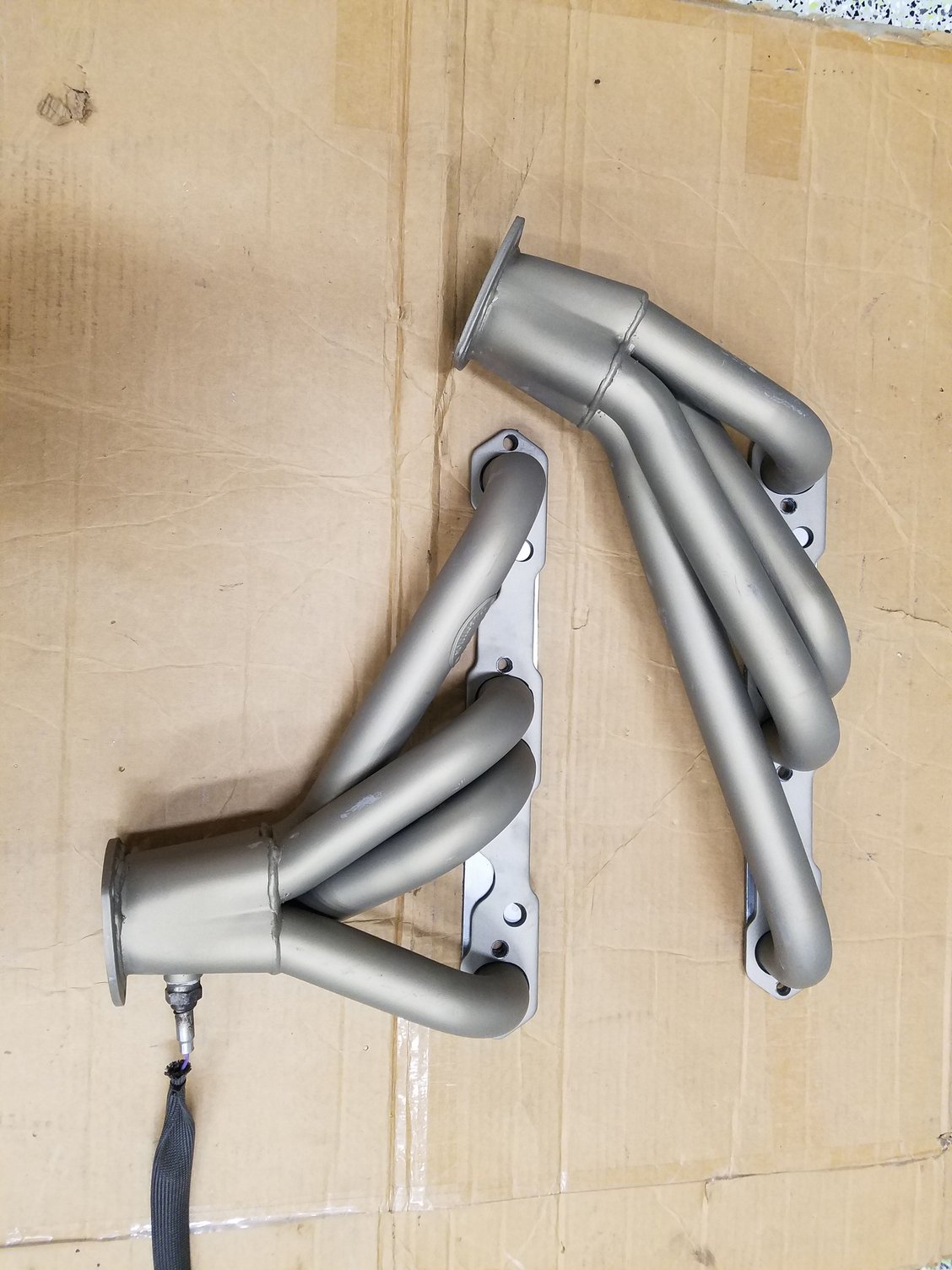

I have some hooker shorties for sale with matching y pipe. Y pipe is all 2.5 but you could cut off at y and weld 3" on as well. Let me know if interested. Its posted in classified section with more pictures.
Had high temp titanium ceramic coated y pipe has lava wrap where it crosses under oil pan. Only 300 miles after coating was done.

Looks like these would work but I'd have to do alot of mods to get it to work with my single 3" exhaust. I also don't need the o2 sensor.

If you have the 3" exhaust already you would have to weld that onto where the y pipe merges together. It would be 2.5 from each header to the y then 3" after so that would flow real well. Either way i think getting rid of your stock y pipe would be best.

Do you think cutting/welding in a dual 2.5" to single 3" collector would work? Basically cut off the current 2.5 collector on your y pipe and weld in a 2.5 > 3 collector.
Also, how was the fitment on your car? I have an 85 trans am w/350 and th700r4 auto trans, no emissions equip.
And what horse power might these be good up to?

You could get an adapter to transition to 3" but if i would do it i think just cut it off where they merge and weld 3" directly onto it to save a few bucks. I was eventually going to do that myself but engines changed lol. The headers fit really well i removed plugs dropped them in from top then put plugs back in then I loosely installed header flanges and tightened up collectors 1st and went back to tighten flanges last so everything lined up good. I did dimple one of the tubes by the flange to give better access to one of the bolts. I dont know what power level these top out at but made a big seat of the pants difference from stock manifolds.

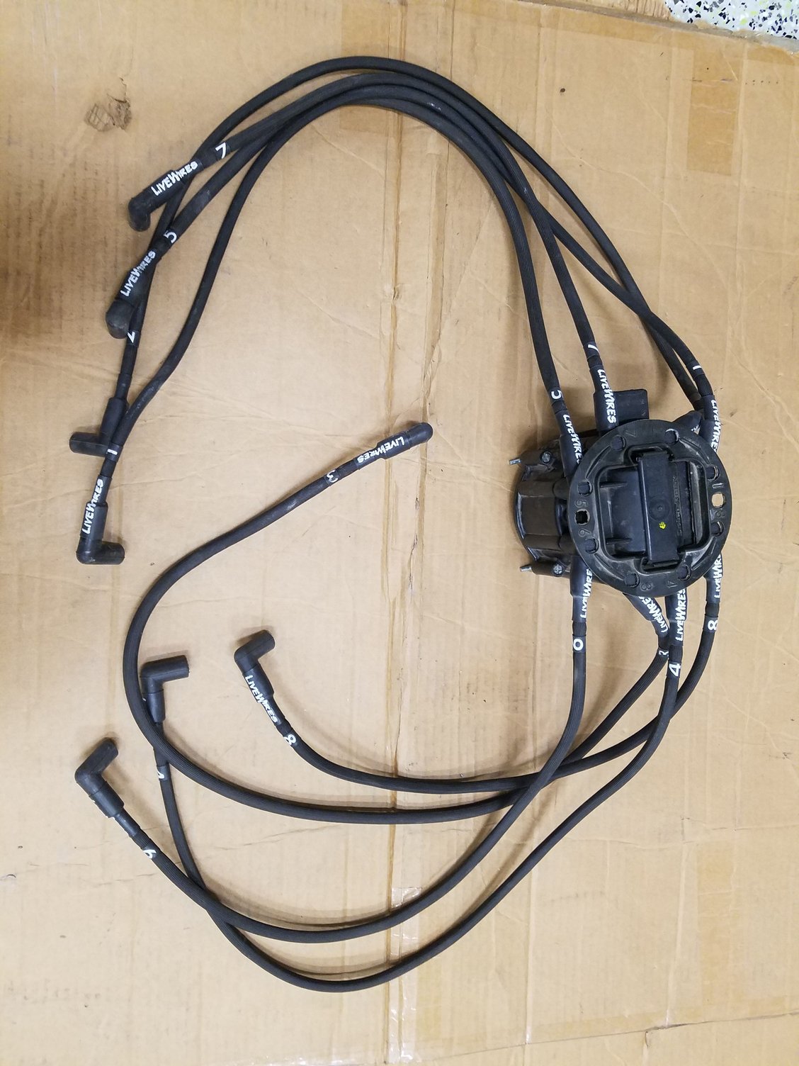

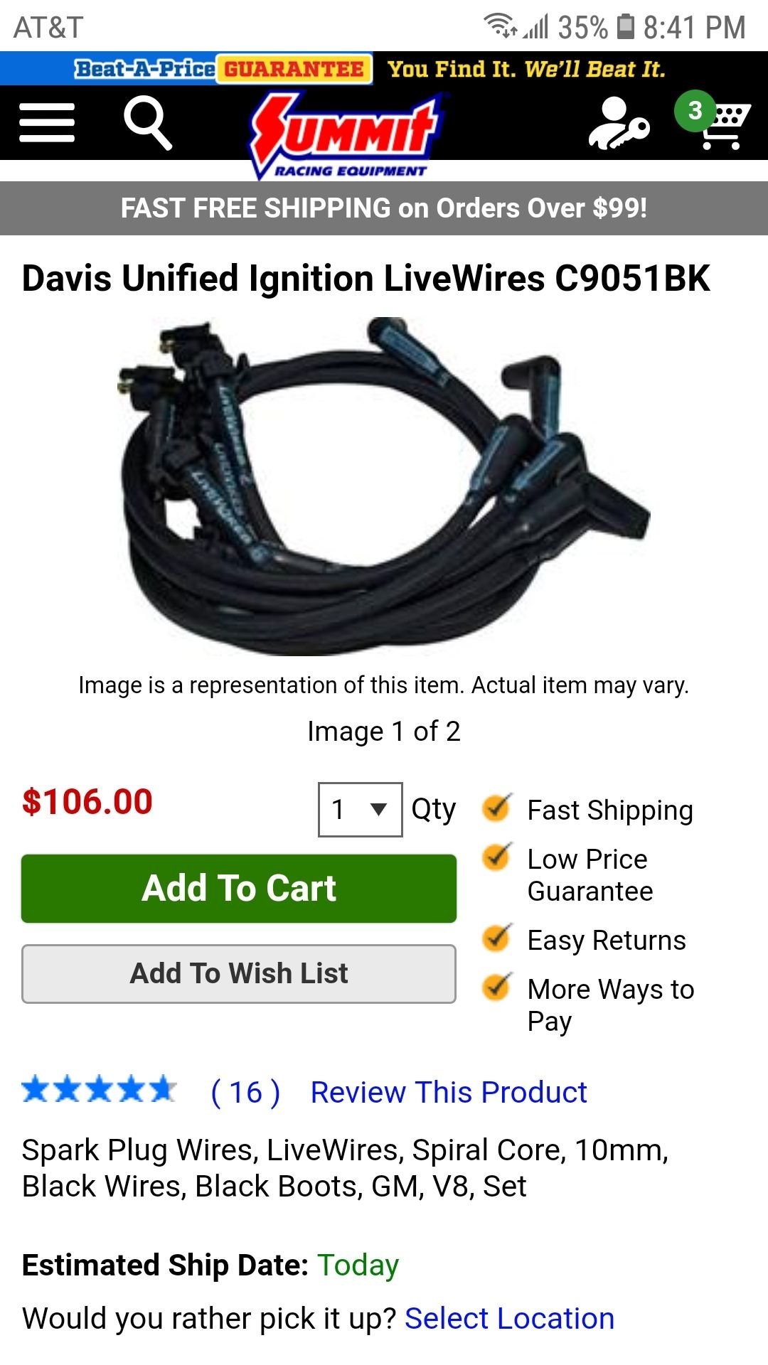

Very nice. Are they solid core or supression style...I have a mallory comp 9000 ignition and promaster coil which aren't supposed to use low resistance wires.

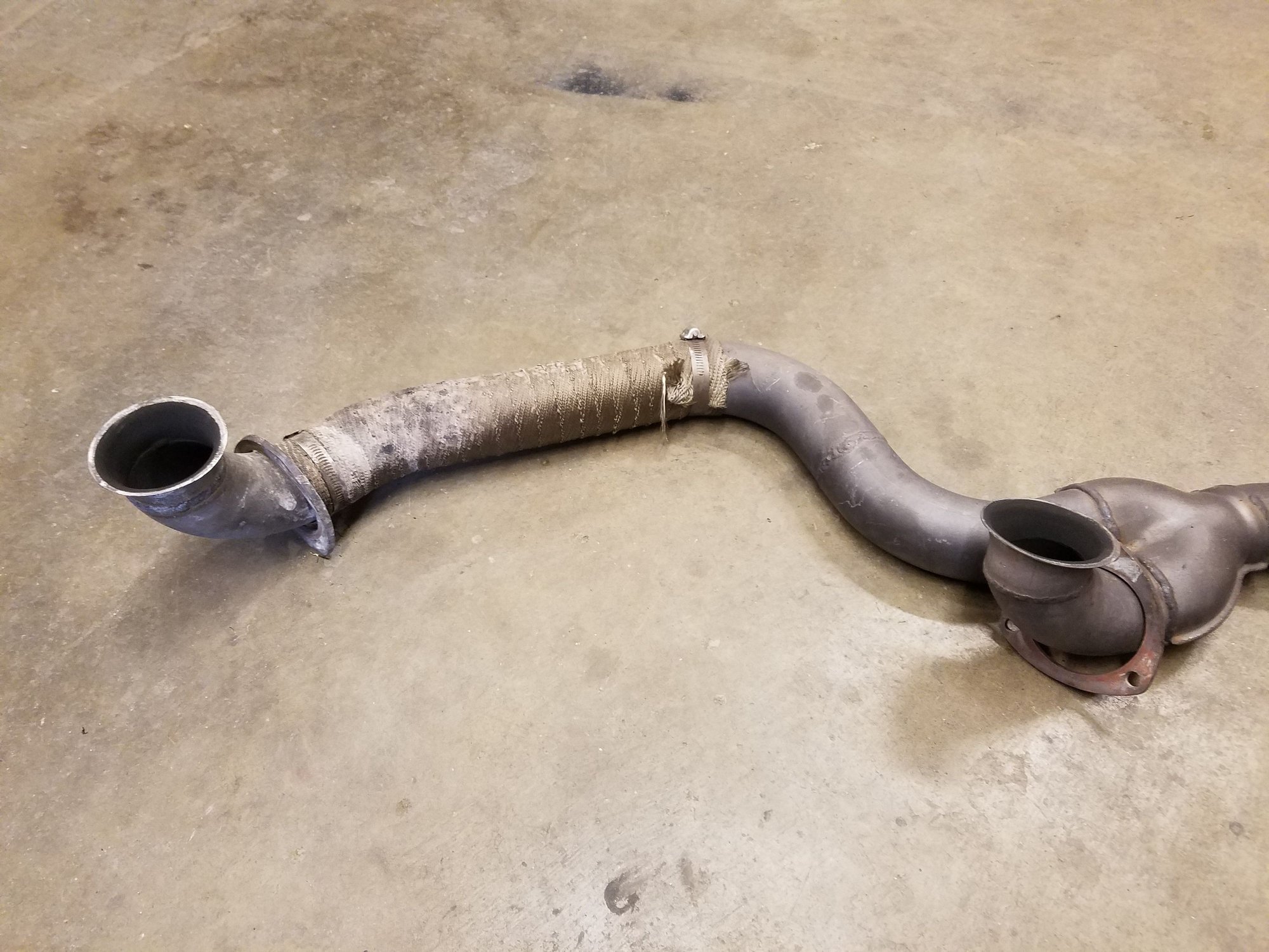

Here is pic of y pipe you would be getting. Has lava wrap where it crosses under oil pan. I will send pm with shipping info.

Thanks! I'm still deciding on the plug wires - have to do some more research on whether or not they're compatible with my ignition system.
Can you post a pic of the Y pipe showing the bend after the collector so I can see how much and what bend 3" tubing I'll need to buy to make the connection?

I would have to cut it off where pic shows to get in box. You would need a 90 degree elbow to attach to existing Y as thats whats on there now except only 2.5". I would think if you just ovaled your 3" 90 degree pipe or flattened it a little then it would weld right onto existing Y. The wires say spiral core so im guessing they are like the stock resistor style wires but definitely check to make sure though.
