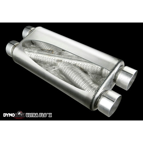

Before going glass packs, thought of 2" true duals, using something like this piece mounted in the stock muffler location?
Ok, most don't quite like Dynomax products, but it's the first picture I found. Other brands carry similar products.
Using a set of small cats mounted under the passenger seat would get that issue solved as well, without encountering clearance issues.
