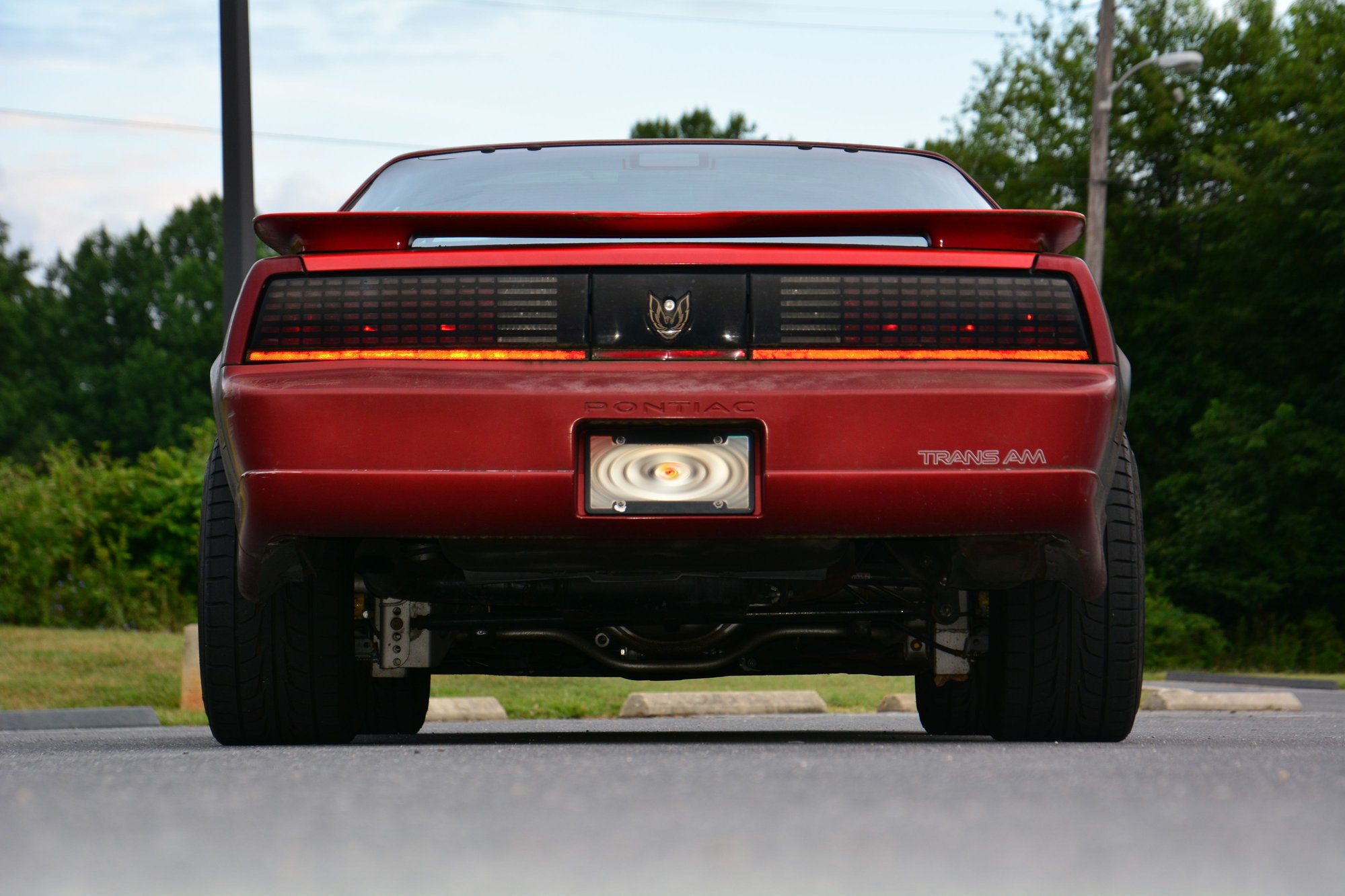

robertfrank's Avatar
iTrader: (27)
Joined: Apr 2004
Posts: 3,001
Likes: 62
From: Salt Lake City, Utah
Car: 1988 camaro "SS"/ 1991 305/T5
Engine: 383 LT1 in progress/LT1TBI 355 soon
Transmission: Probuilt 700R4 3600 stall/ T5
Axle/Gears: Moser axles, 3.42 Eaton Posi
Re: Can't decide on a muffler
I'll get some of the rear muffler today
