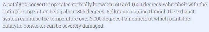

When They Can Get To Temps Like This ,You Need It.

Yes; it's there to keep your car's carpet from possibly catching fire and also to avoid setting fire to grass underneath the car if parked off-pavement.

The heat shield is there to keep the cat from setting either the car, or whatever it's parked on top of such as grass, on fire.
You need it.
If the cat is old enough to where that piece is rotting and falling off, then it's probably not much better off inside. As cheeeeeep as new ones are, and might very well improve how your car runs, might as well just change it out.
