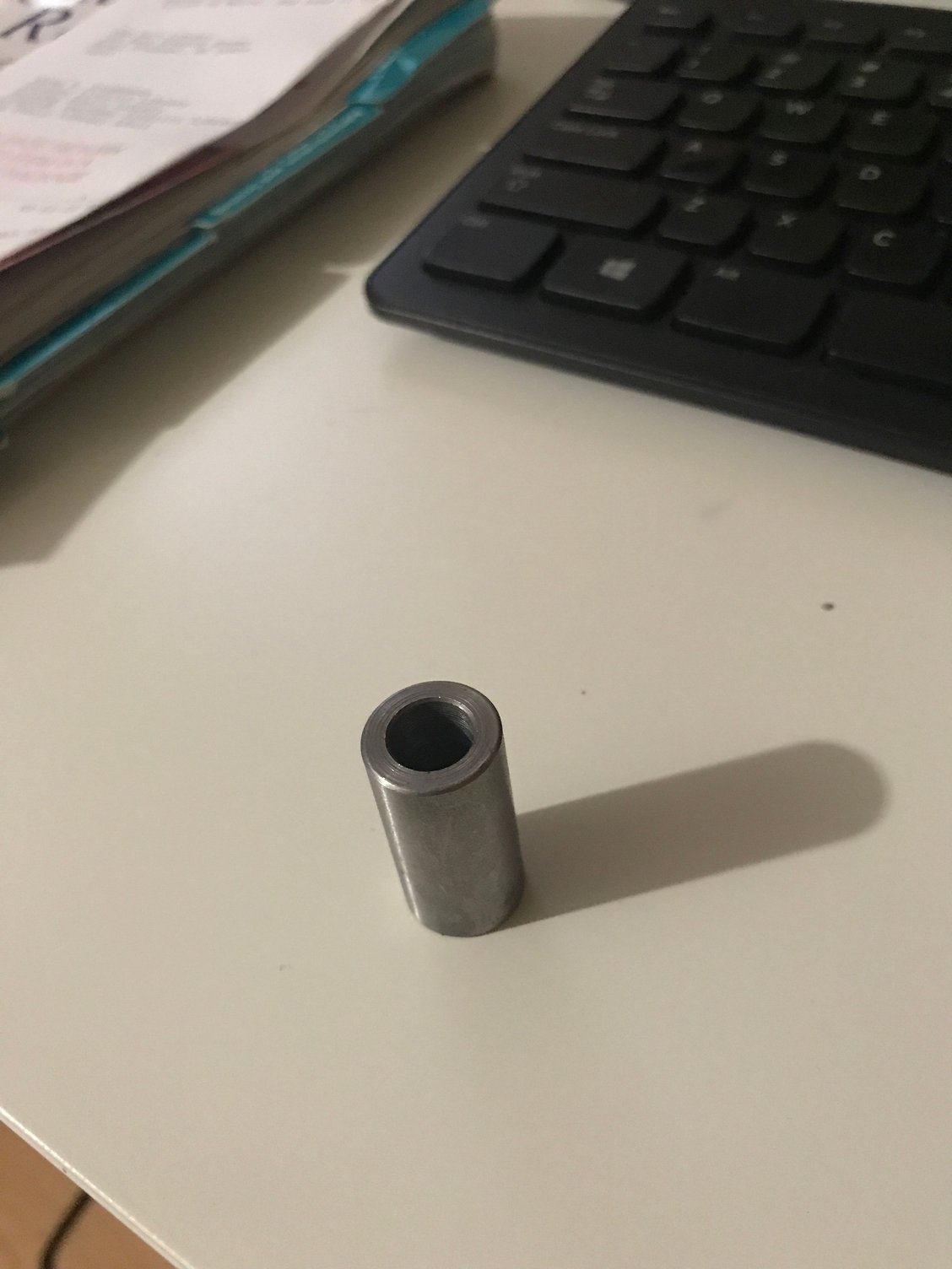

What is the bushing for that comes with hooker 2460s?
What does this bushing do and where does it go? Is it for drilling out the o2 sensor?

Maybe a spacer if eliminating ac bracket on driver side? If its threaded then probably o2 bung.

It's a spacer for reusing one of the factory studs that the various accessories bolt onto. Did you try looking in the instructions?
https://static.summitracing.com/glob...ok-2460hkr.pdf
Left side, step #4

Thank you 82Firebird5.0 for bringing up this spacer. My 2460-2HKR set came with no instructions and NO spacer. Lol so now my procrastination has paid off, I WILL have to make a spacer to fit during the install....... thanks again!

The spacer only spaces out the AC bracket that wraps around the manifold on the driver's side of the pre-88 cars. You just need to make it the height of the manifold flange - the header flange. Most people just cut that part of the bracket off.

Don't cut the bracket off if you are retaining the AC. (even if "most people" do)
Make a spacer out of galvanized steel pipe. Paint it black. Use the OE stud, or a longer bolt. (stainless) Works great.

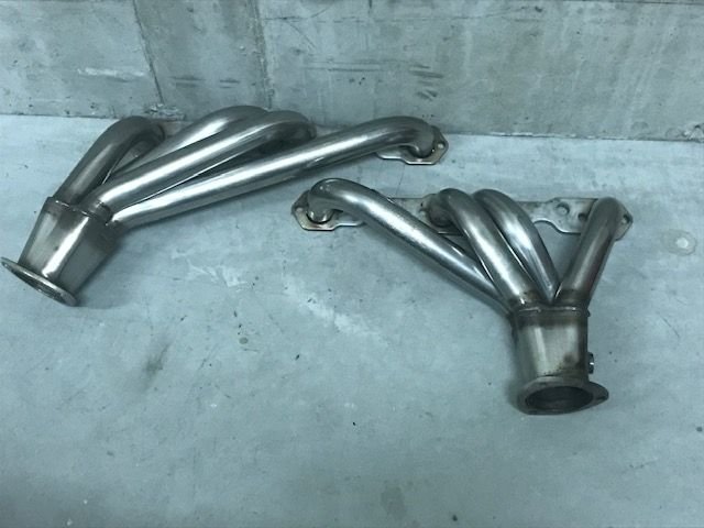

are those stainless? Or how did you strip the Black paint off? I called a hooker representative and they said the paint is just for storage and will burn off so I want to repaint mine with vht extreme heat... I just don’t really want to spend hours sanding them...

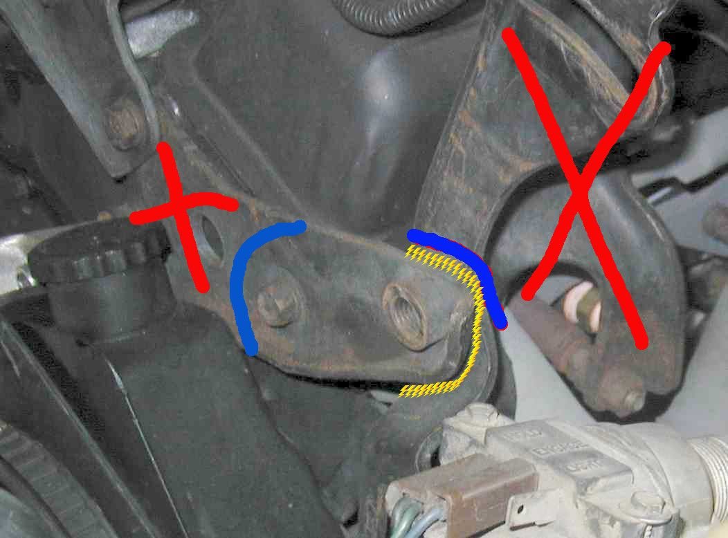

Anyone have any pictures of their modified AC brackets and/or power steering bracket to fit 2460 headers? I'm debating whether or not to cut mine off or keep searching for a PS only bracket.

Don't have the Hookers, but the same principle should apply to any headers. Here's what it looks like on Edelbrock TES.
It's not modified, because I put the AC back on; but I'm sure you can imagine what it would look like if you cut off the upper parts of the tall one and maybe rounded it over neatly so it looked like it was made that way.
You'd probably want to cut the part that sticks up, including the part that goes back behind the header tube to that other stud, and of course just use a regular header bolt back there. You need that front bolt & spacer regardless though for the PS. And put a short bolt through there where the compressor pivot bolt goes, just to hold those together.

Hi 82Firebird5.0 Yes the headers on the floor in the pic are stainless Hooker 2460-2HKR. They are 2 years old and still look great. But I haven't put them on yet. Should look good for years!

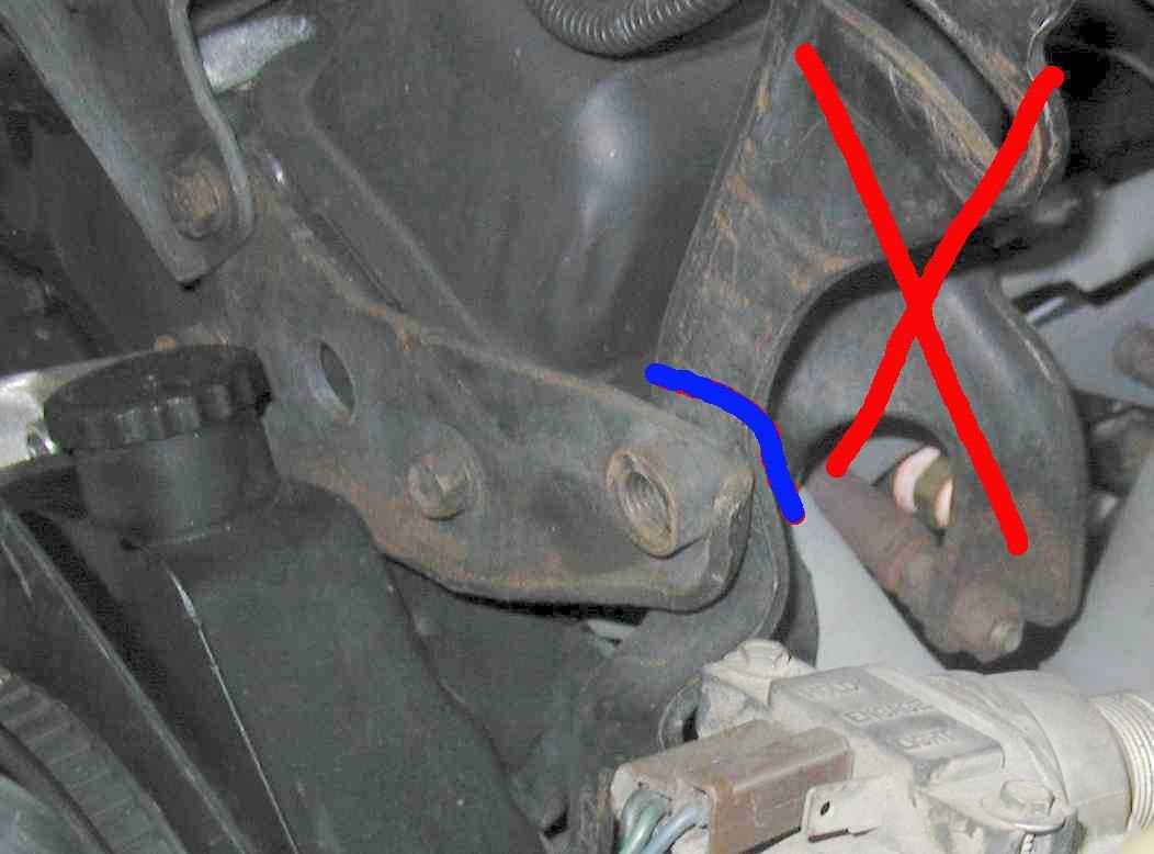

So something like this....blue line = cut; red "X" = remove?

Re: What is the bushing for that comes with hooker 2460s?
No unfortunately they won't.
They'll turn to a bronze kind of color the first couple of times you run them. Over time they'll turn a rusty chocolate brown. But it won't be loose, flaky rust like normal steel; it'll just be a solid coating layer.
But they won't stay shiny and steel colored for more than a few minutes of running.
The "silver" ceramic coating on top of stainless however, DOES stay relatively untouched over time. Here's such a set in my truck, after 50k miles or so.

Yes, something along those lines. I think once you have the part and the wizz-wheel in your hand, it'll come naturally.

What about Zeus rodding the head bracket to the AC portion and cutting off the portion of the head bracket near the water pump?

tidan, that would probably work, if you bolted em up in place, tacked em together, pulled em off, and completed the operation.
