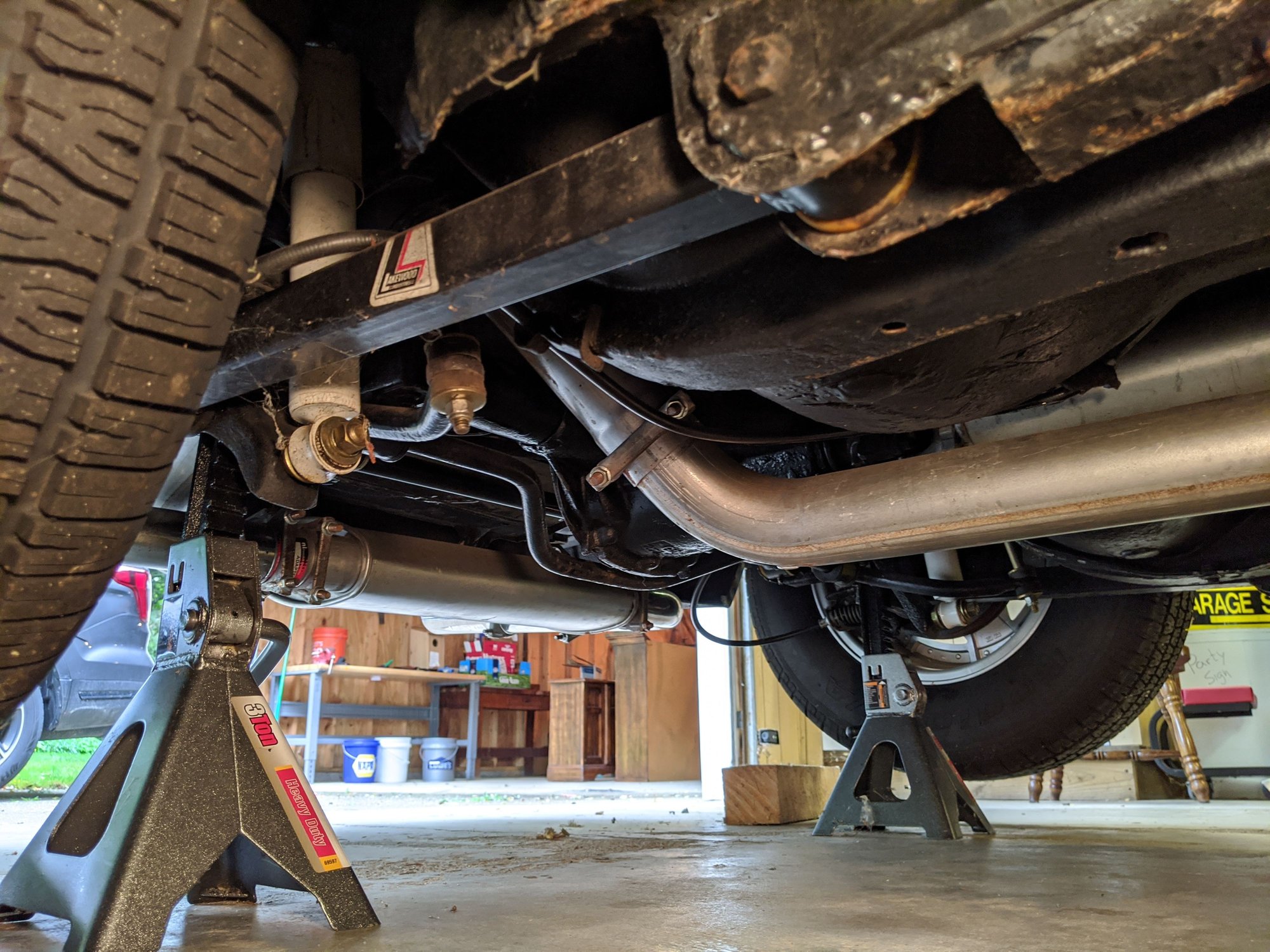

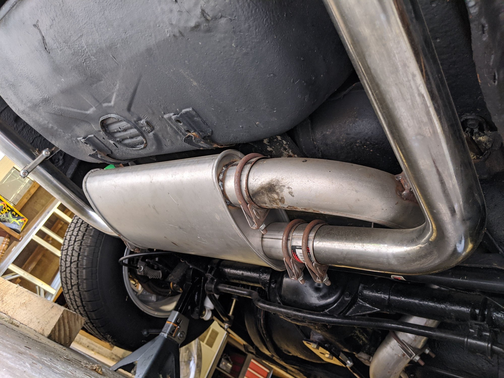

I have a '83 Camaro with a 383. TKO 5 speed manual trans. Whenever I look at options for complete kits, it seems they only fit applications with long headers and automatics.... and I can't find long headers which work with manual trans.
I have these shorty headers: 2460HKR https://www.summitracing.com/parts/hok-2460hkr
I have this Y-Pipe: 16767HKR https://www.summitracing.com/parts/hok-16767hkr
I would like to replace the muffler ... are there any muffler muffler from that Hooker Y-Pipe on back? Does anyone sell the pipe for over the rear axle? The one I have is a transplant from a Firebird and it's been cut and modified..

How much power is your 383 putting out? If its not a monster your everyday 3" catback will work. If its a screamer than id look at 4" mufflex. If its in between than the hooker blaclheart duals.

I like the Hooker Blackheart ... But do they make a kit for F bodies? Or do I have to modify to fit? Thank you for reply. 383 putting out 430hp

Thats right in the sweet spot for the blackheart dual exahust. A set of their new SBC long tubes would probably give you a little power bump over what you are making now. The setup isnt cheap. If you dont want to change headers i would look at any of the 3" catbacks from hooker, flowmaster, etc.
