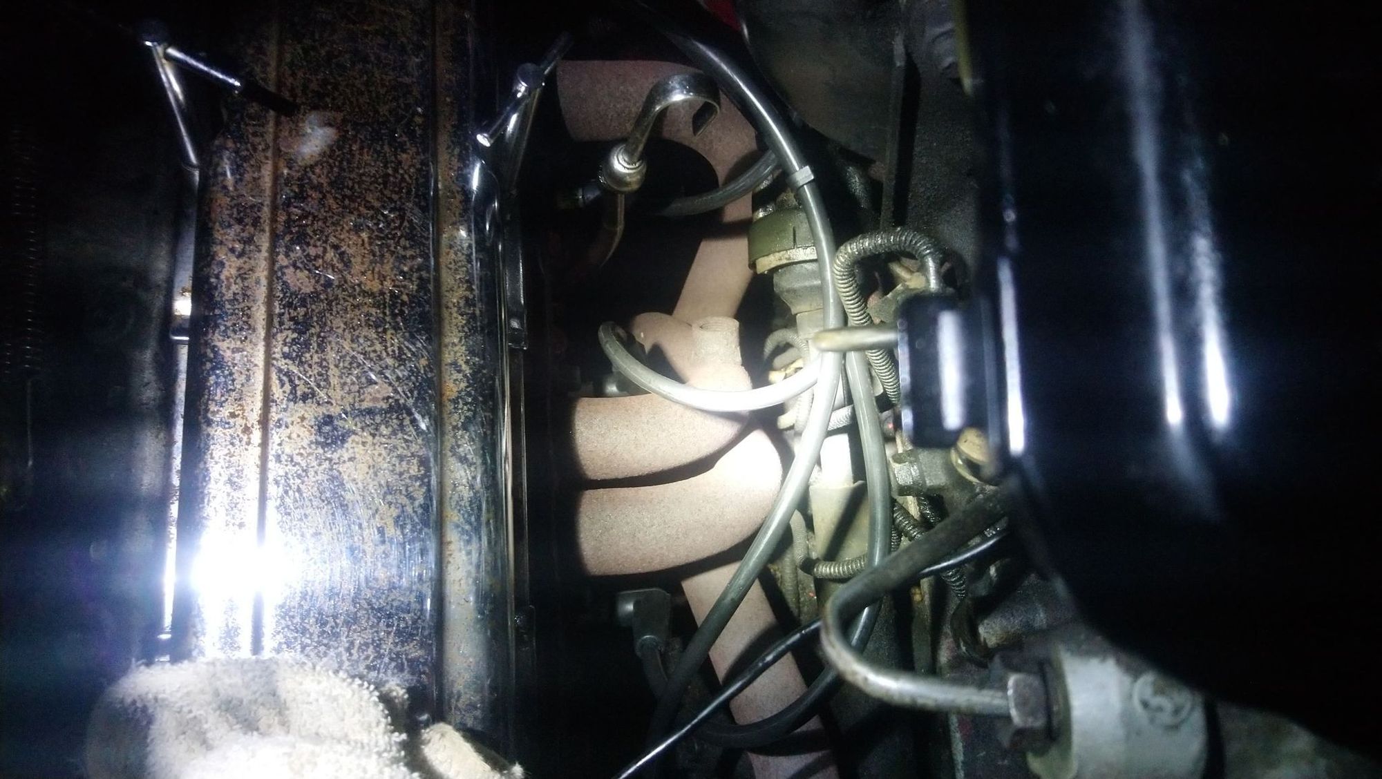

Post pictures headers are fairly distinct and we can probably tell you what you have

here are those pics sorry i have been away for awhile

Looks Kinda like flowtek what does the other side look like?

Dont have any pictures of the other side right now. hard to get those in the dark last night. ill grab some pictures of the other side when i get home form work today.
the passenger side has a similar bends to them. with cyl #6 spark plug being hard to access. the collector seems to be a bit more angled to the rear on the engine compared to the driver side though.

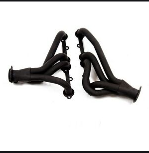

Does the pass side have a weird tube that goes over the top?

yeah that looks just about exactly like the ones i have.

Not surprised they are the most common, also the cheapest. I think you want PN 11116FLT
