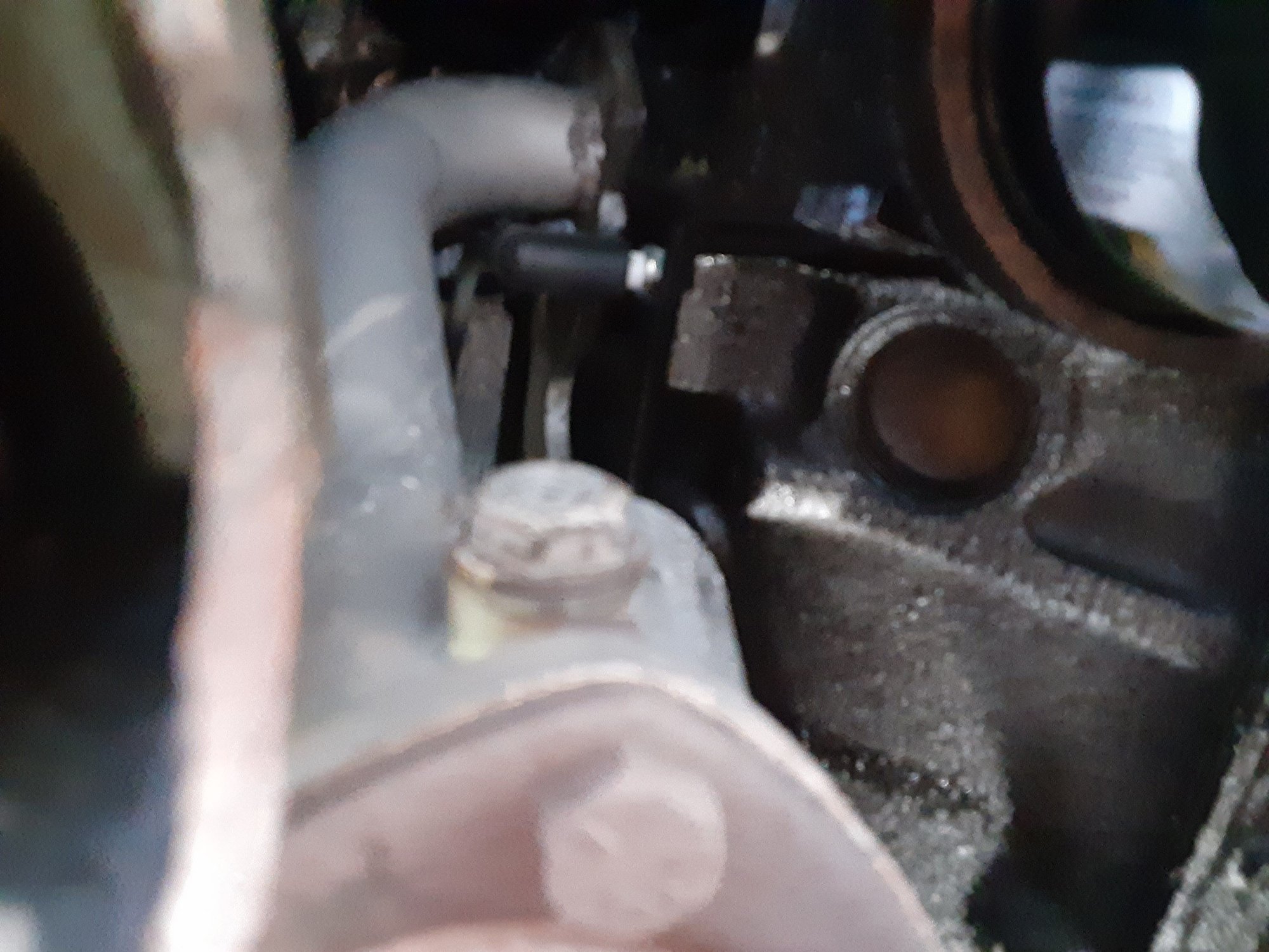

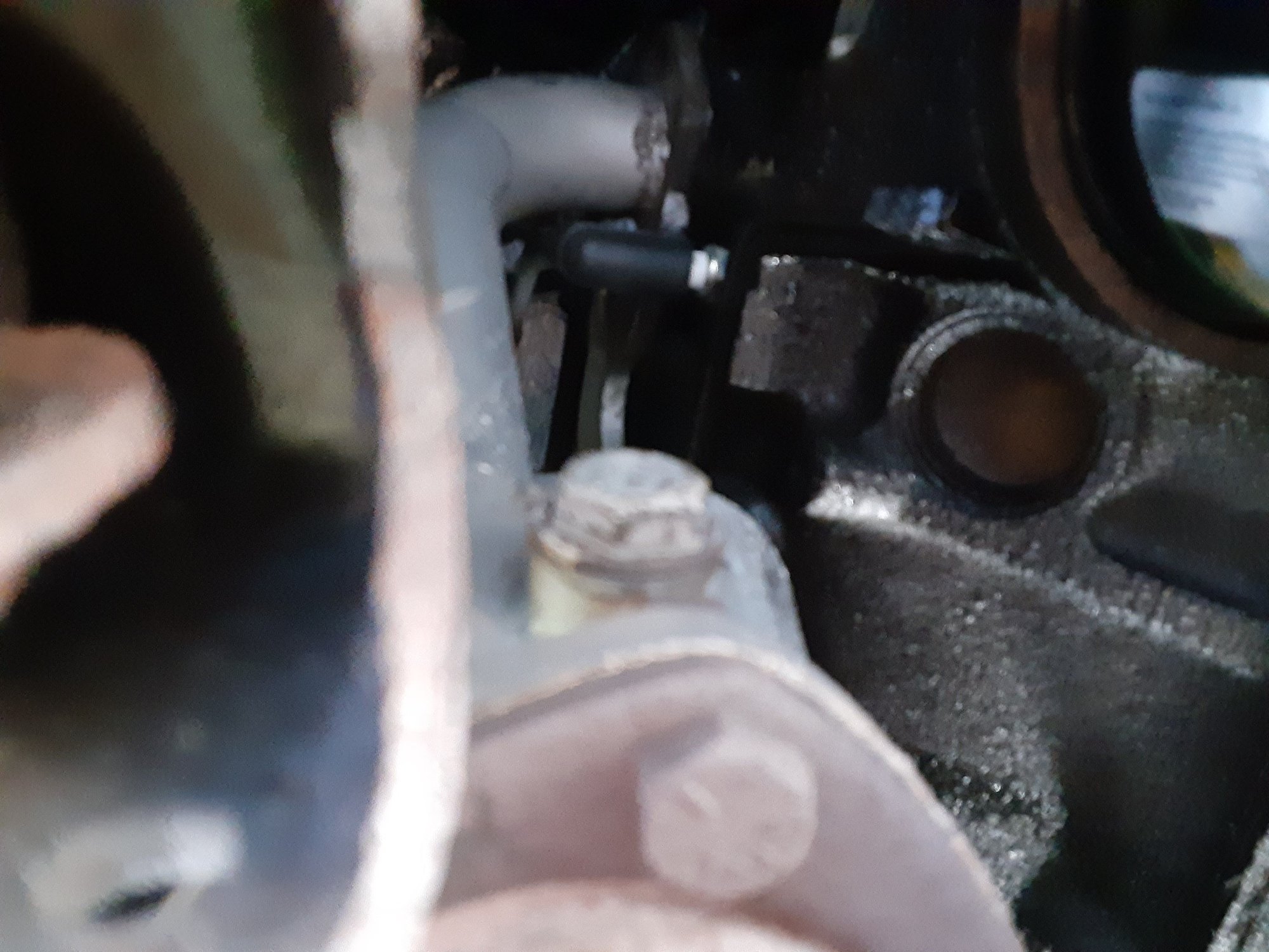

I don't know if I am blind as hell, but I cannot find this 02 Sensor for the life of me! I've checked all up and down my exhaust and nothing! On the driver's side header there is a port for it but it's sealed with a bolt. I can't find a wire anywhere. I've check the passenger side, further back along the straight pipe, up front, etc. No 02 sensor anywhere!
Does anyone have a picture of the wire and where it runs to underneath the hood? Maybe I could trace it? Or does anyone with a full hooker exhaust system have a picture of where it is?
Looks like a port for the 02 sensor but it's not there!

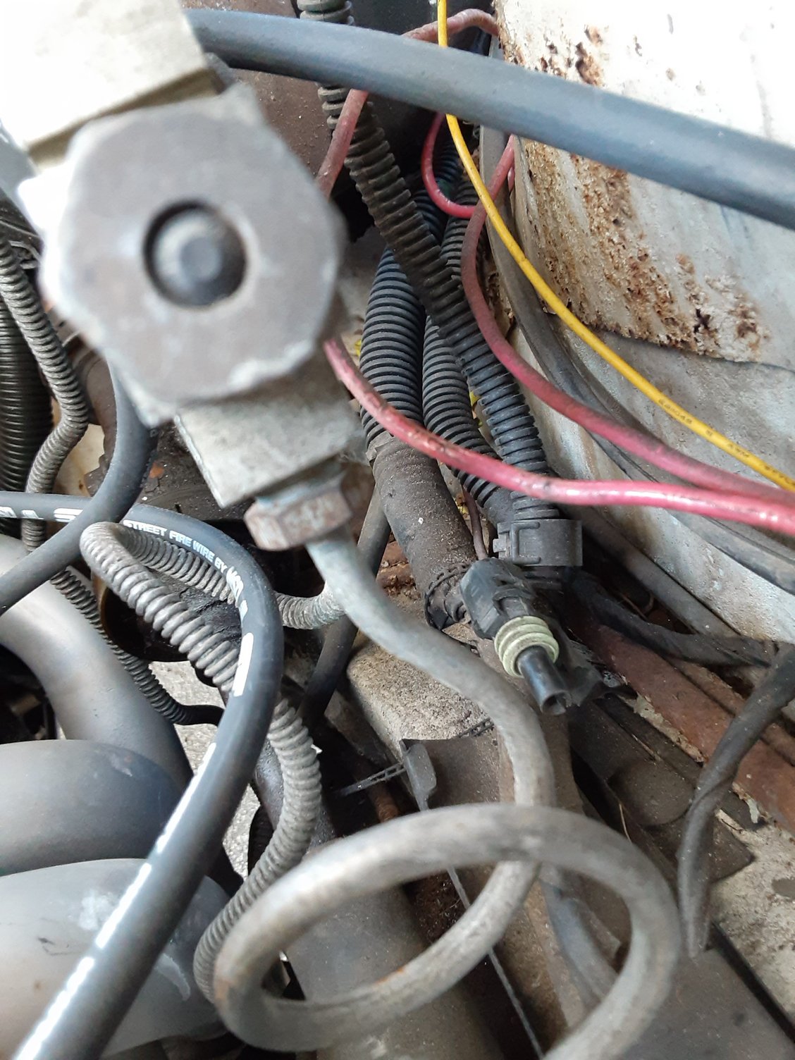

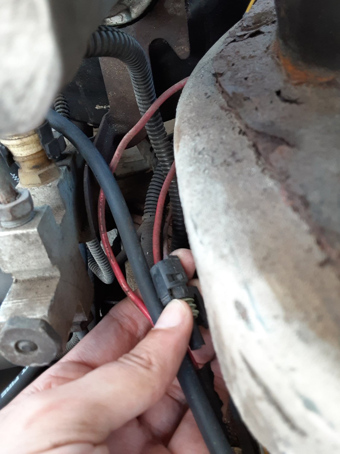

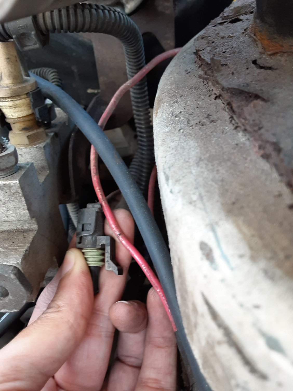

I found this under the engine. It has a purple wire and it runs to the Fuel Pump/MAF/MAF Burnoff relays. Nothing is plugged into it. But the pig tail from my new 02 sensor fits it perfectly! Could this be where my 02 Sensor belongs? Could the old shop have deleted it and some how my car ran normally for 5 years and only now it's running poorly (rotten egg smell, surging idle, low power)?
Or perhaps I still have a bad 02 sensor in another location (not sure where) would it be safe it plug my new 02 sensor into this pigtail and screw it into the port on the driver's side header?
What does that long pigtail go to?
The wire itself runs to the Fuel Pump/MAF/MAF burnoff relays.
Is this for the 02 sensor?

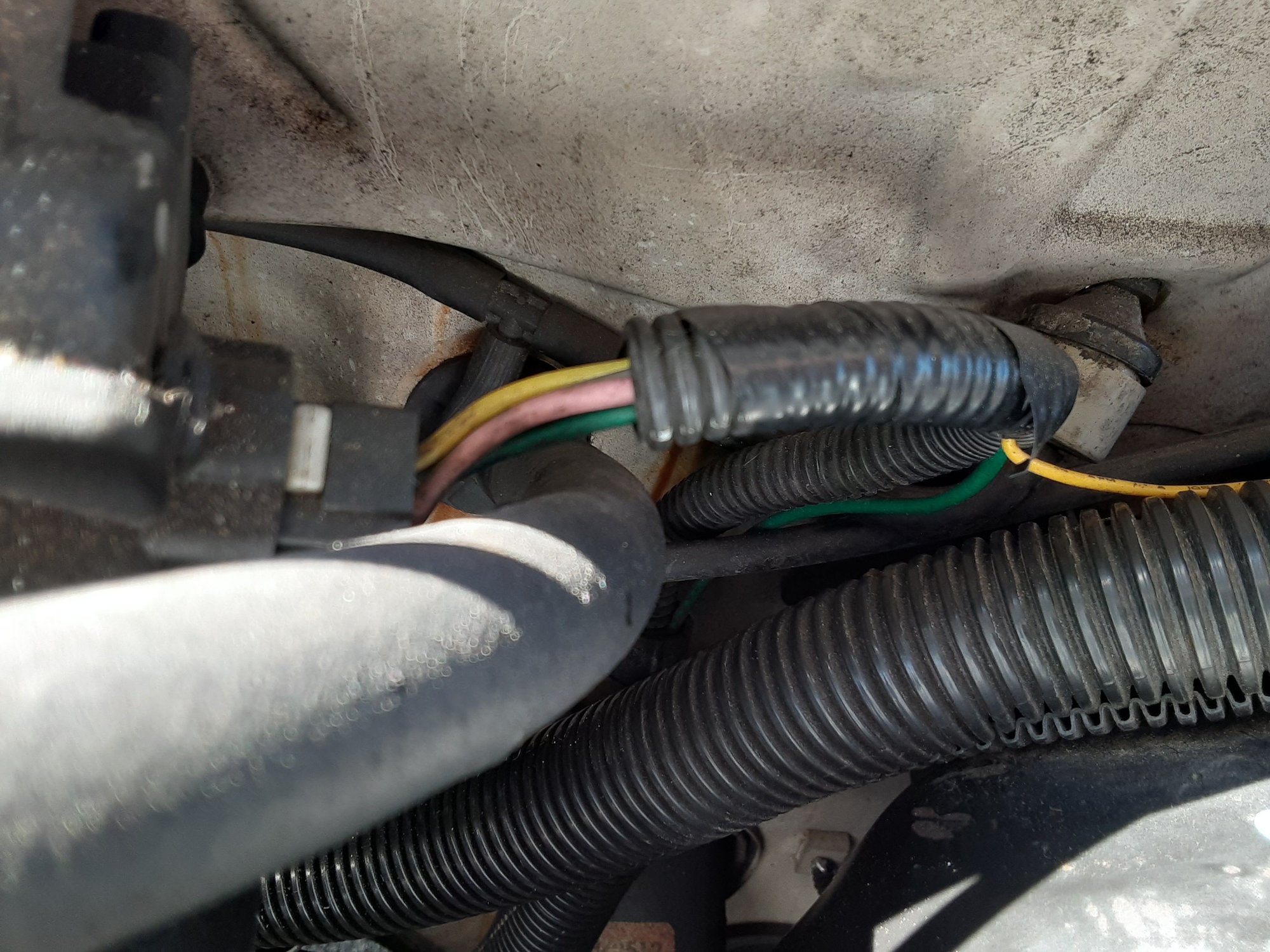

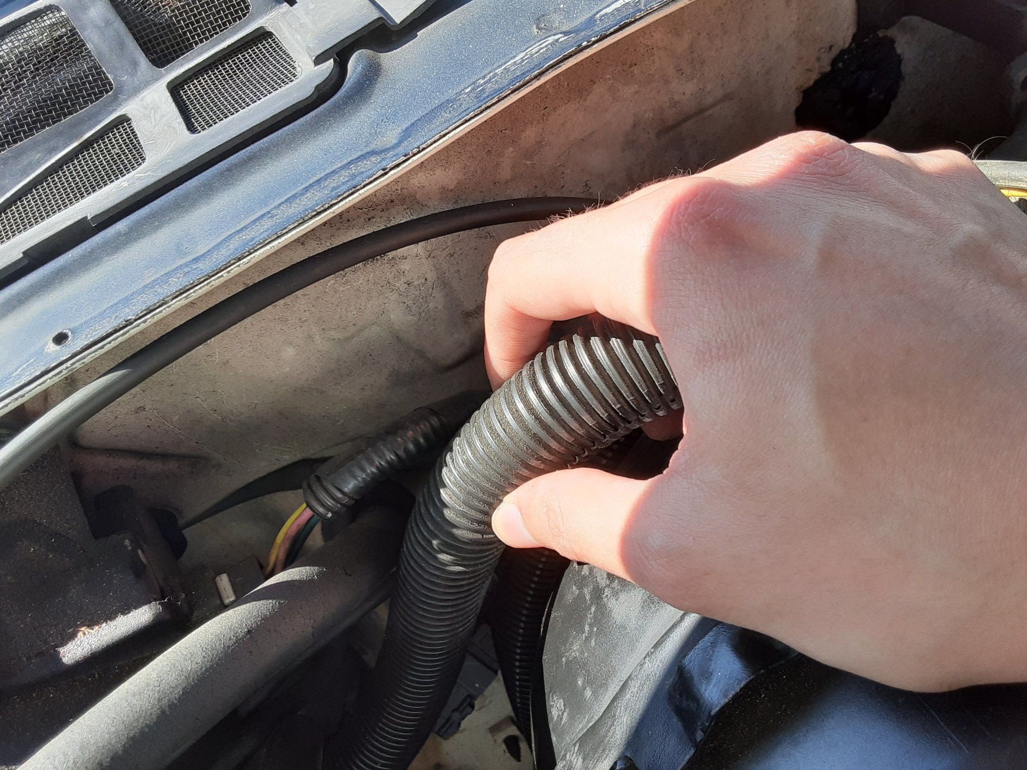

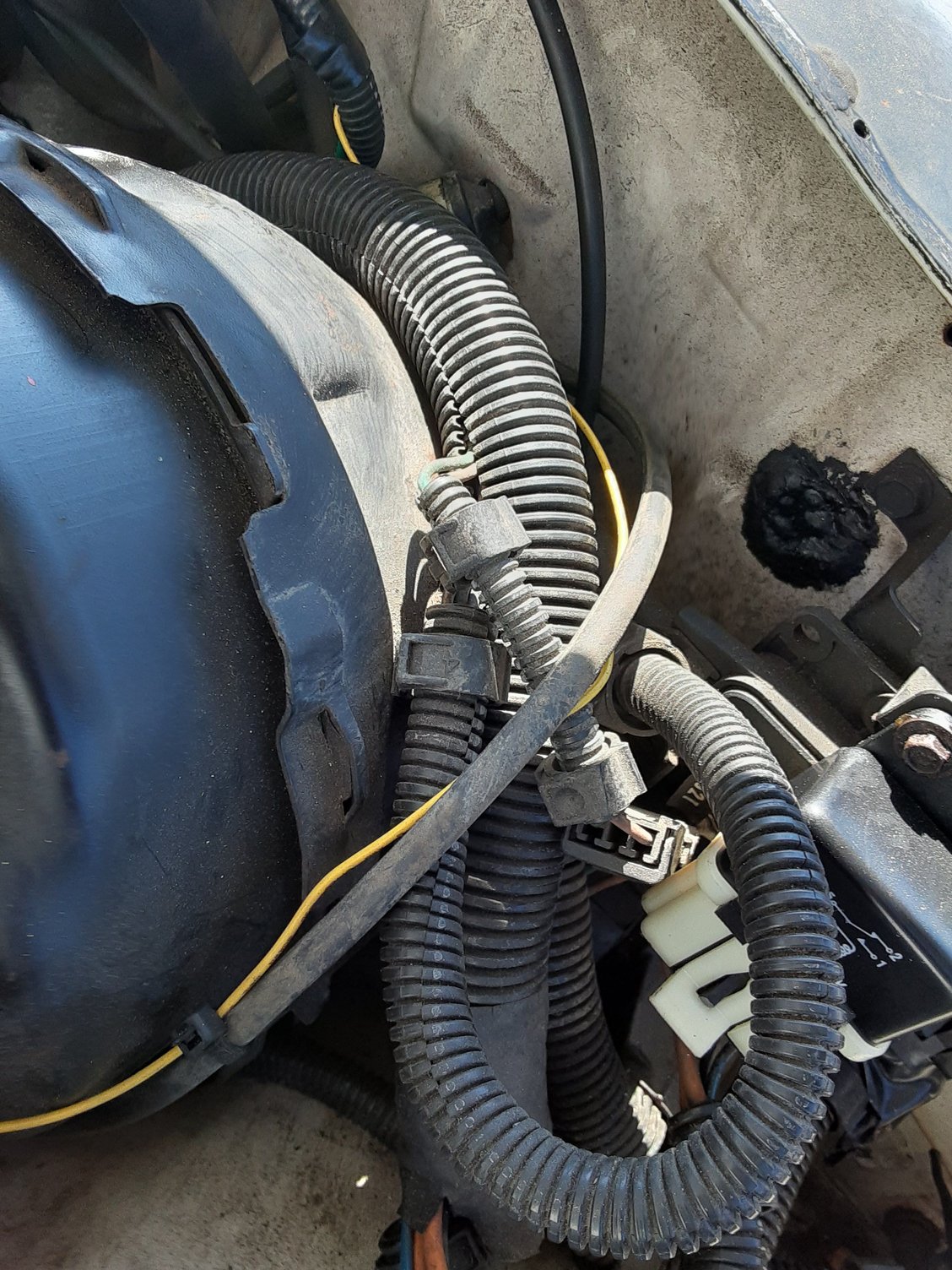

I think it's it. I traced that pigtail with the purple wire a little more and it runs into this collection of wires that goes over the brake booster and under the distributor. I'm assuming it mixies in with the wires on the passenger side. If that is the pigtail connector and I can't find my 02 Sensor (i'm not sure if the car has one) would it be safe to install a new 02 sensor into the header bung and plug it in? Even if my car may have another 02 sensor somewhere?
This runs above the brake booster and under the distributor to the passenger side.
The purple wire with the pigtail leads to this.

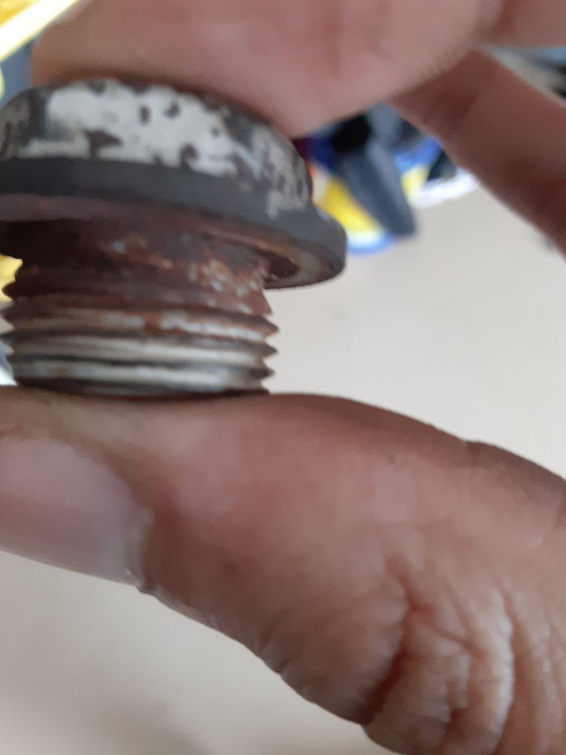

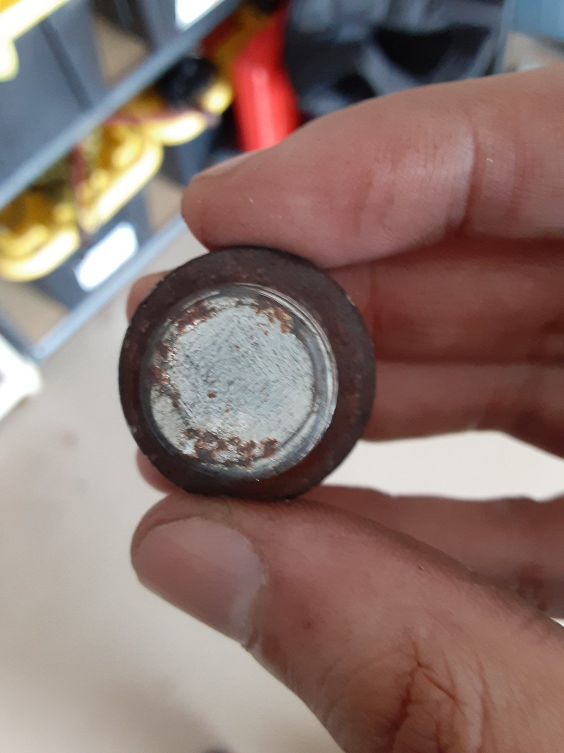

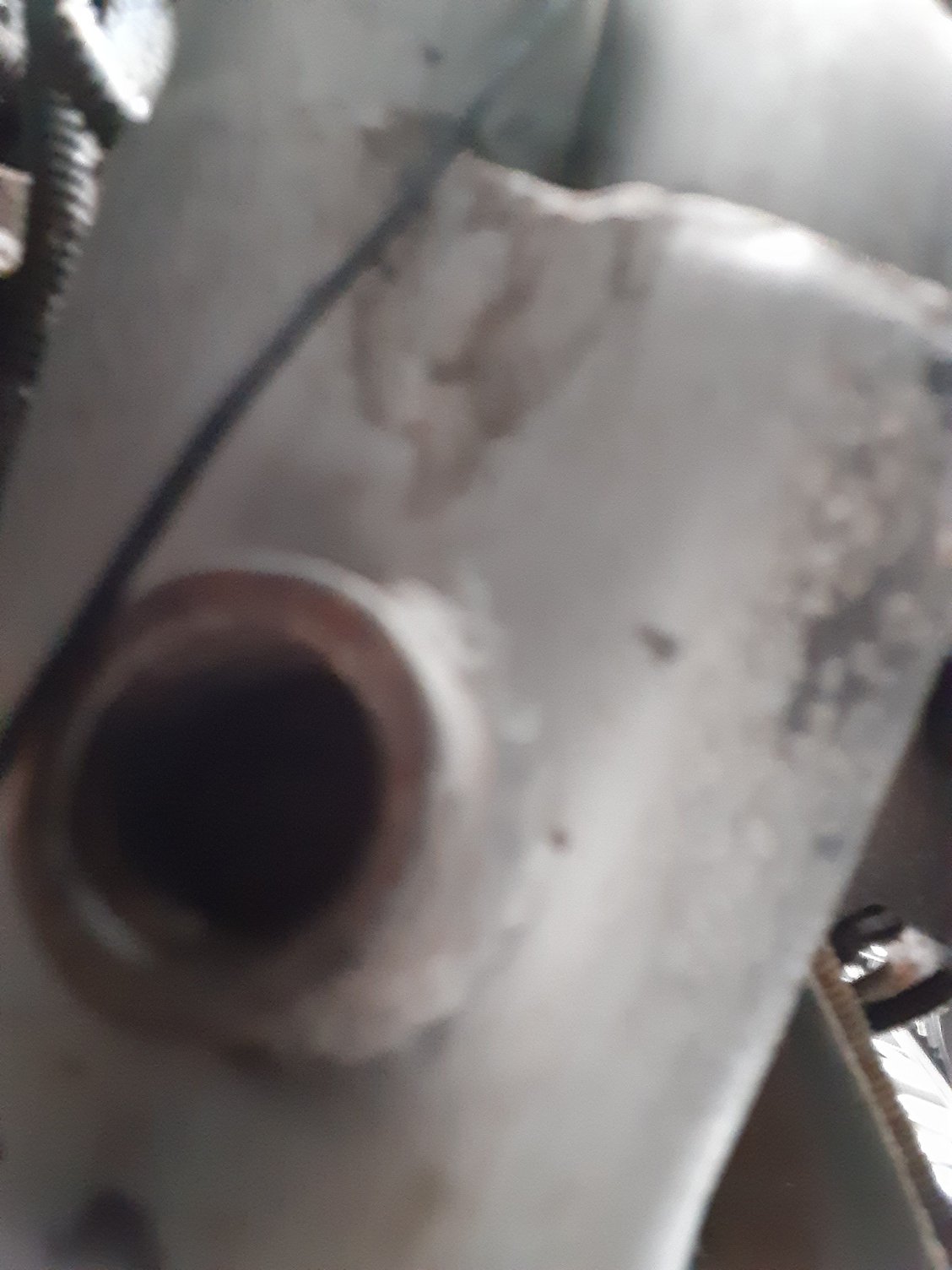

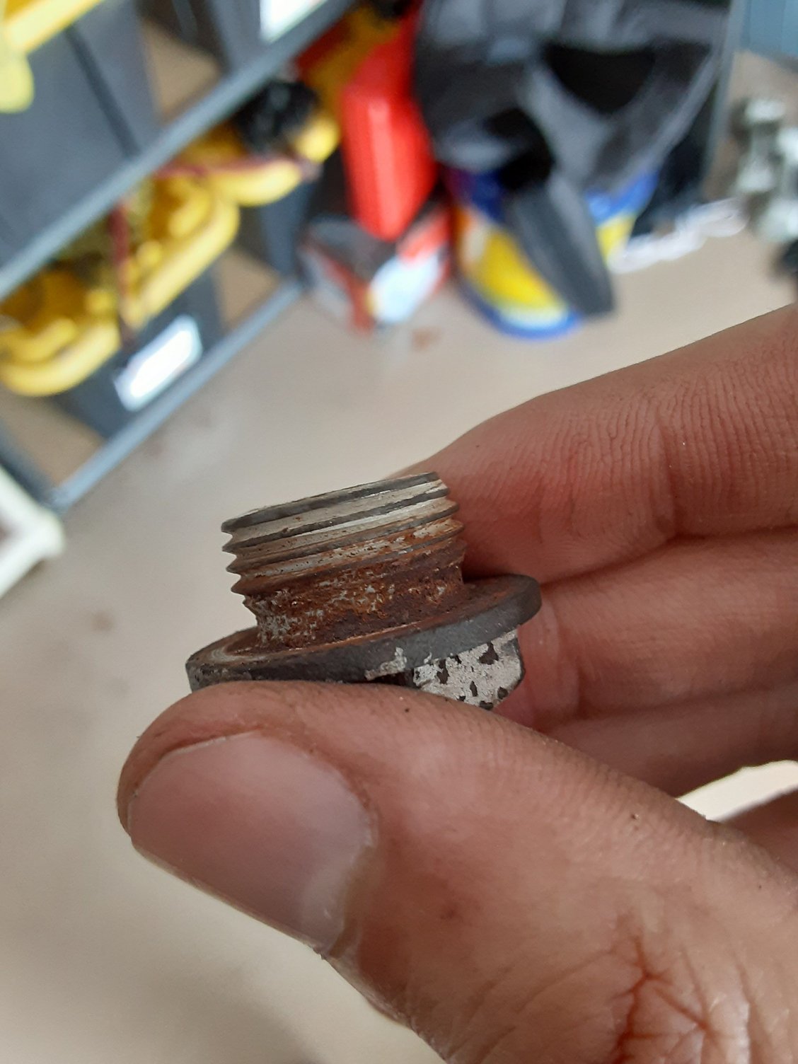

I am beyond baffled at this point. So I decided to to try and install my O2 sensor using that pigtail pictured above and the one I brought from the auto parts store. I removed that bolt that was in the exhaust bung and attempted to install the 02 sensor but it couldn't fit. There is a big chunk of metal behind where I removed the bolt. Like it's blocked by metal wall. The hole is filled in and nothing could get in. I assuming the bung is suppose to be hallow for the 02 sensor to read the flowing exhaust. As to why it's blocked I'm baffled. I've checked everywhere else on the exhaust and cannot find anything that resembles an 02 sensor or wires. I checked the straight pipe (since I know some cars have it by the cat but nothing).
The only thing that resembles a place is that bung by the driver's side and that pigtail on the driver's side. Now the mystery is how was my 02 sensor deleted and why having missing 02 sensor issues only started in the last month?
Here are pics for details. If anyone has another idea of where it could be. Please let me know. Or if you can post a picture of your pigtail and the wire, please do.
My only other theory. Could this bolt have snapped when I tried to take it out?

The only way you're going to find the wire is to open up the ECM wire harness shrouding/split tubing and trace it. That harness comes from the PASSENGER-SIDE fender well through an opening in the PASSENGER-SIDE fender apron near your A/C evaporator & blower motor. The O2 sensor is obviously missing which is probably why the car runs terrible, unless a previous owner converted the car to run without the ECM, which means a vacuum advance distributor and non-CCC carb...

I see a purple wire that runs into that tubing and comes out the driver's side near the brake booster, that I posted above. It's the only purple wire with a pigtail. If someone can just confirm that is the correct pigtail that would help a lot.

I think you're confusing the word "pigtail" with connector. The purple wire you are talking about has a connector on the end of it.
A "pigtail" is just a short wire or cable attached to a component (like the O2 sensor). Since your sensor is obviously not there, there is no "pigtail" for the O2 wire to plug into...
