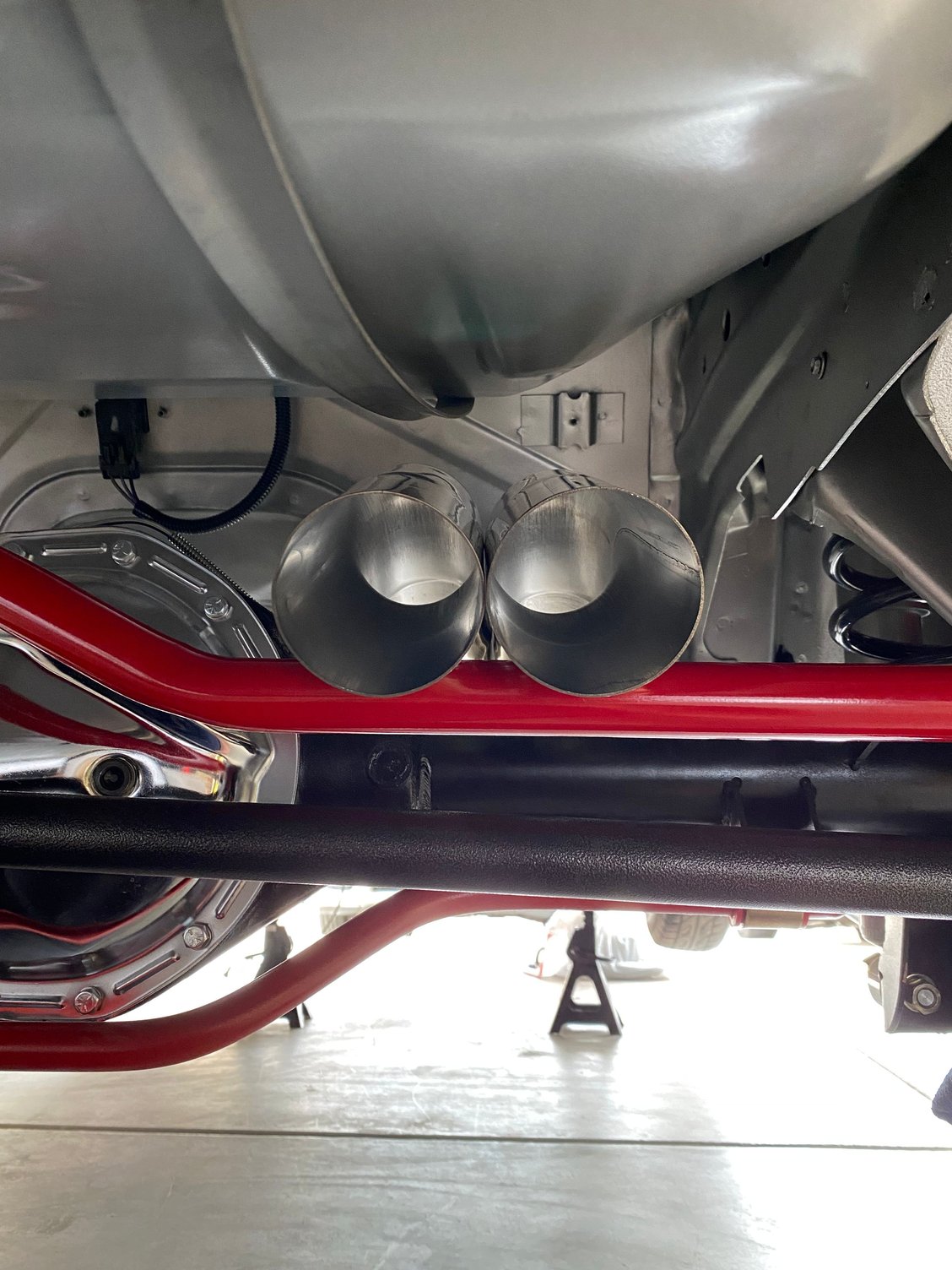

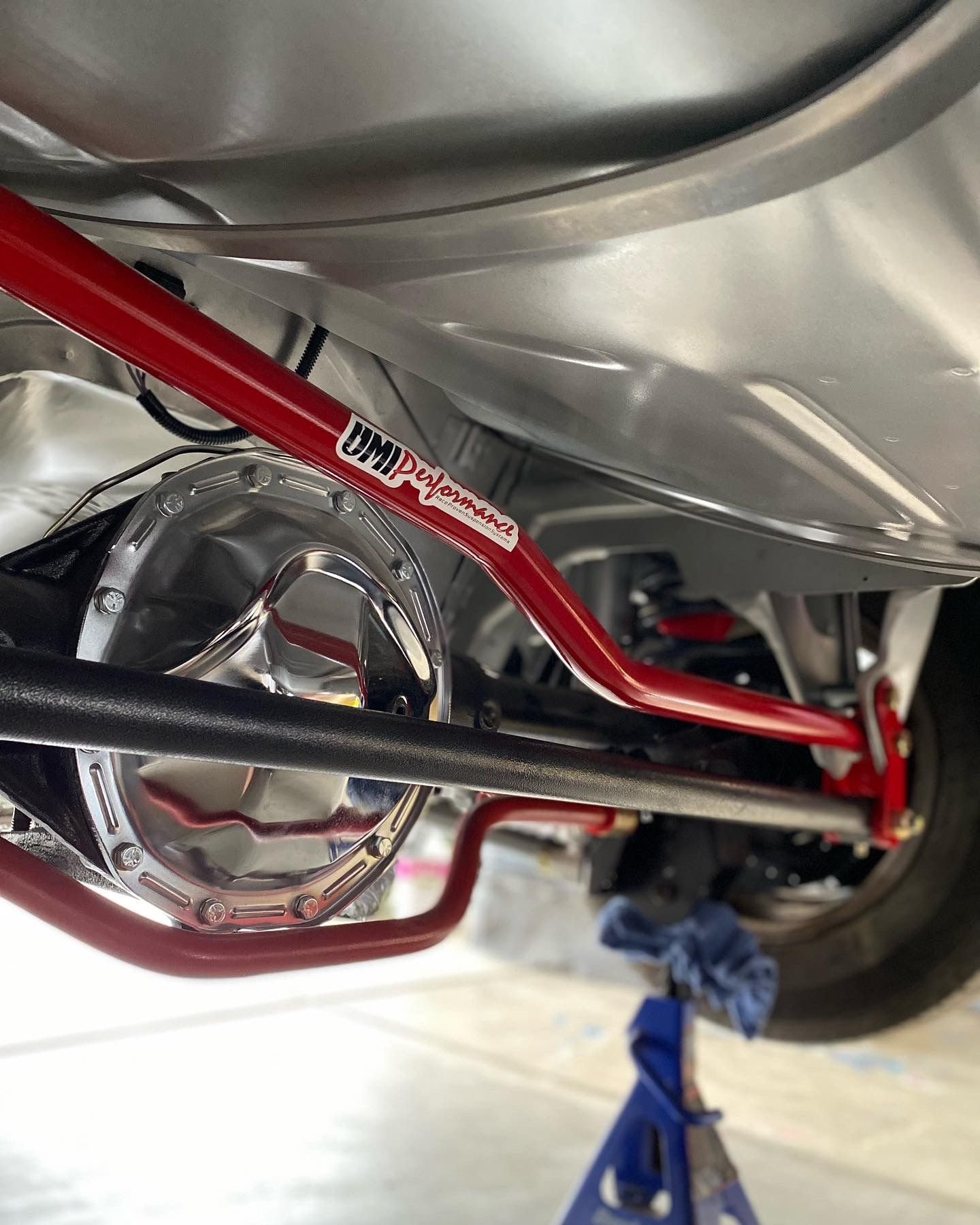

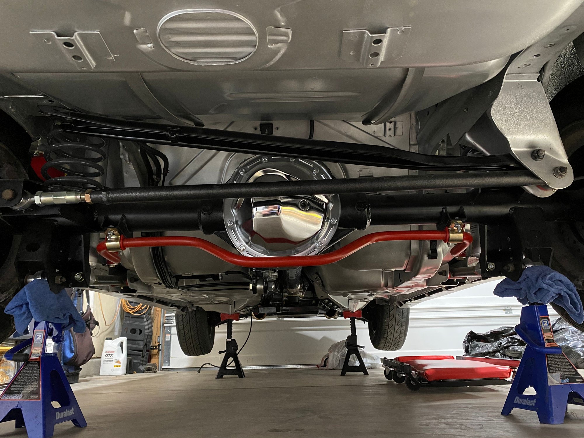

@QwkTrip Your suggestion was perfect!
I got a UMI Panhard Relocation Bar and that is exactly what I needed!
Before and After.
And a further back view of the whole area before and after.
Although I agree that dual 3” is a bit hard to route, I don’t think it’s overkill. Just complicated. I will be making about 530 HP so it’ll be functional.

Originally Posted by 85projectZ28
Off topic but I'd like to see how level the panhard bar will be once the suspension is fully loaded.
EDIT: Having a better look it would appear the weight is on the suspension. Just through the jack stands.
You might be wanting to add the adjustable bracket for the axle side of the panhard bar so as to restore it to a level condition.
​​​​​​​Possibly. I’m only aware that the Panhard bar controls the left and right sway of the diff. I have no idea how tilted or level it should or should not be. Let’s hear about it.
Old Oct 9, 2022 | 03:22 PM
skinny z's Avatar
Joined: Dec 2005
Posts: 9,920
Likes: 885
From: 53.0907° N, 113.4695° W
Re: 3" exhaust myth????
Short story is that the bar should be level at ride height.This way as the suspension unloads or compresses, the axle moves equally in either direction.
