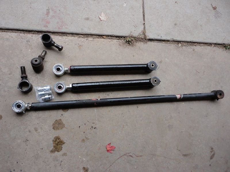

I recently purchased 3 different height-adjustable panhard kits. Some of the stuff in these kits was surprisingly bad which is why I'm sharing my own experience. I'll walk through the pitfalls that I saw and some of the tweaks I made along the way.
I already had an adjustable panhard bar with 3/4" spherical rod ends, so I just needed the brackets and revised track-bar brace. That doesn't make this any more difficult though as you can mix and match a lot of this stuff as you like. The products I purchased are,
* Heidts RC-567, Panhard Bar Relocation Brackets and Mounts
* UMI 2064, Panhard Bar Relocation kit
* Founders Performance 20246, Height Adjustable Panhard Rod Relocation Kit

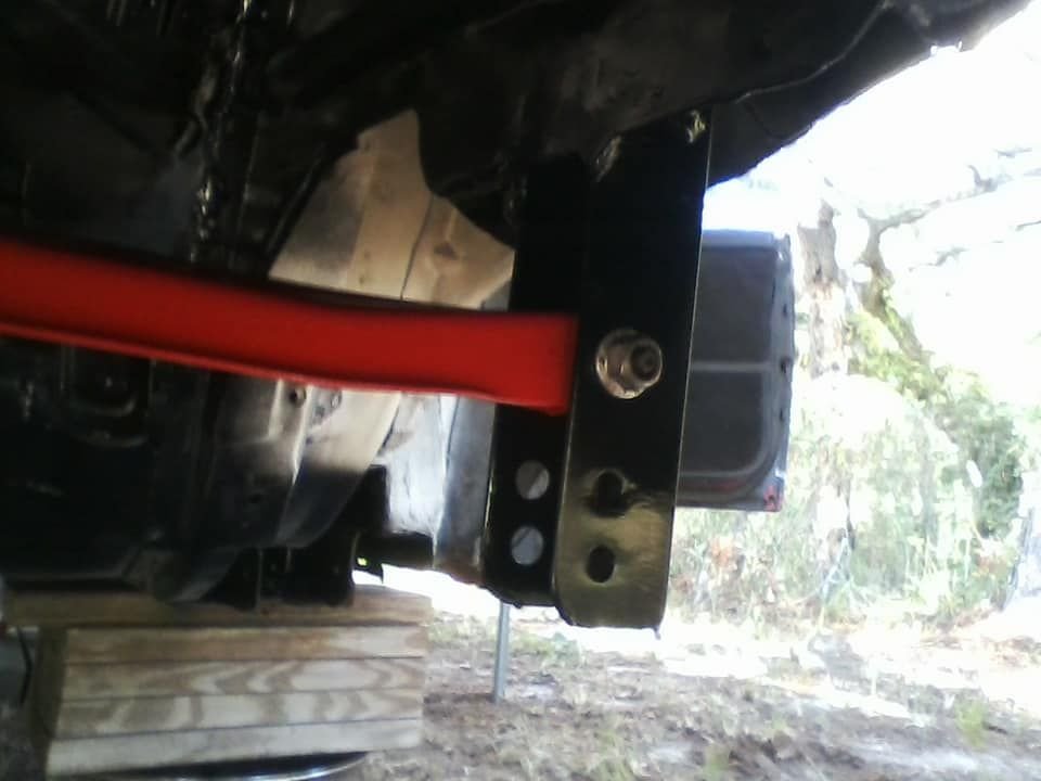

Track-bar brace takes a high path and lays hard against my plastic 4th gen fuel tank. That was a show stopper for me. I'm not sure whether or not it will clear a stock 3rd gen tank but literally nothing else in the kit fit my car so good luck if you try. The thru bolt is 9/16" and requires oversizing holes in the stock bracket. This is irreversible if you ever want to go back to stock. I simply prepped my stock track-bar brace for 9/16" bolt (explanation below) so it's ready to go back on if I ever want to raise my panhard back to stock height.

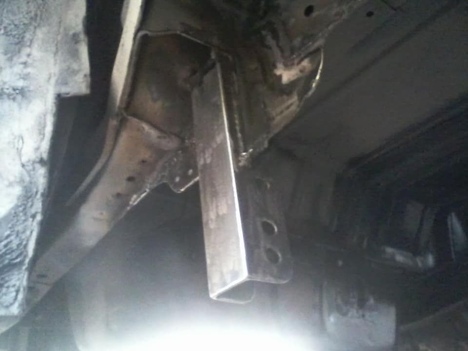

Body side bracket (passenger) is boxed on three sides and wraps around the outside of the stock bracket. This makes it super easy to fit a panhard bar with standard width (1-7/8" stack height) rod end bushings (you'll need to do some shimming with washers that are supplied with the kit). Comes with a large diameter spacer which I like. Lots of grinding needed to fit bracket to car but it can be done without compromising the bracket. The top mounting holes were misplaced so I had to weld shut those holes and re-drill. The bracket also protrudes some toward the wheel, so maybe pay attention to clearance if you're trying to stuff every crevice of the rear wheel well with tire.

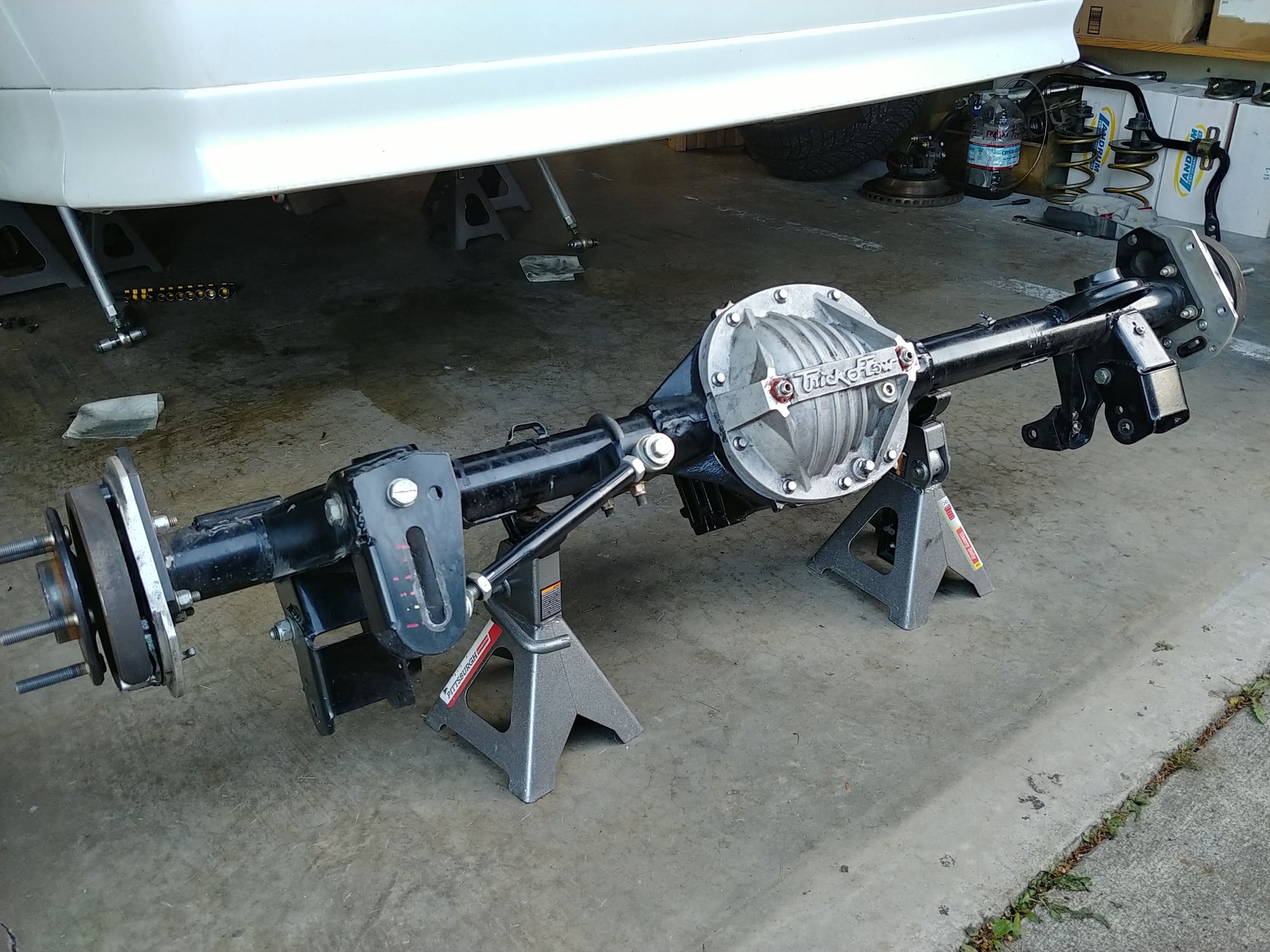

UMI axle side bracket is by far the sturdiest of all the kits and works okay for bolt-on applications. However, for weld-on applications the benefits of its strength is offset by not fitting flush to the stock bracket, with gaps that are so large that it is not easily weldable. UMI incorporates standoffs (washers) welded to the bracket that does not allow it to sit flush to the back side and causes the bracket to rock on the mounts. The width of the bracket is not quite right either, causing more gaps in other locations too. The Founders bracket by comparison fits like a glove with lots of good welding edge.
UMI is the only kit to offer a special feature of a weld-in brace under the spring pocket. I cut down one of the legs to provide better access to bolts. (note: Panhard bracket fits really nice, huh? It's not the UMI, that's why. )
UMI has a brace rod that supports the panhard bracket at the axle. The brace attaches to the bolt for the panhard rod end, and extends to a saddle that is clamped to the axle tube. The rod length has to be adjusted every time the panhard is moved up or down. The brace uses an aluminum bushing with only 1/8" insert into the rod end, including the radius. That means there is less than 1/8" of aluminum supporting the rod end. I double checked with UMI that maybe I received the wrong parts but they said it was correct. That, folks, is absurd! I fixed this by swapping out for 9/16" bolt, using a 5/8" to 9/16" reducer sleeve for the rod end, and machining the UMI aluminum bushings into thick washers.

Founders track-bar brace fits nicely and clears my 4th gen fuel tank. Pictured below is comparison of Founders (bottom) and Heidts (top). The Founders takes a lower path for more clearance to fuel tank.
The body side bracket (passenger) is boxed on 3 sides. Some grinding is needed to make fit but the holes line up nicely. Panhard height is infinitely adjustable in the slot. The slot is sized for a 14mm bolt which will have a bit of bearing slap in a standard 3/4" rod end. You'll need to enlarge the slot if you want to use a 9/16" bolt. Bracket width is a smidge too narrow for standard bushings with 1-7/8" stack height but it will slip in due to the "bendy nature" of the soft steel. Although, it makes the panhard bar VERY DIFFICULT to slide when adjusting panhard height. You're going to need a dead blow hammer for that job. Also, the bracket folds in like a taco if the spacers are too short, so spending time getting the shimming right makes all the difference in the world in terms of final fitment after the bolts are tightened. (You have to source your own shims.)

Axle side bracket (driver) is a perfect fit. Holes line up and it's nice and flush at pretty much every surface making it easily weldable. Can't really say anything bad other than the steel is kind of soft. Everything fits, panhard fits. It just fits!
Founders (picture top) uses a brace to the axle tube similar to UMI (pictured bottom), but ties into the bottom of the bracket instead of the panhard bolt. Set the rod length once and never have to adjust it again. The Founders axle saddle is a good fit to 2.75" axle tubes, and has a low profile that fit under my sway bar (yay!). Although the steel is soft and it bent when I tightened the u-bolts. I'm going to add some bracing to prevent that in the future.

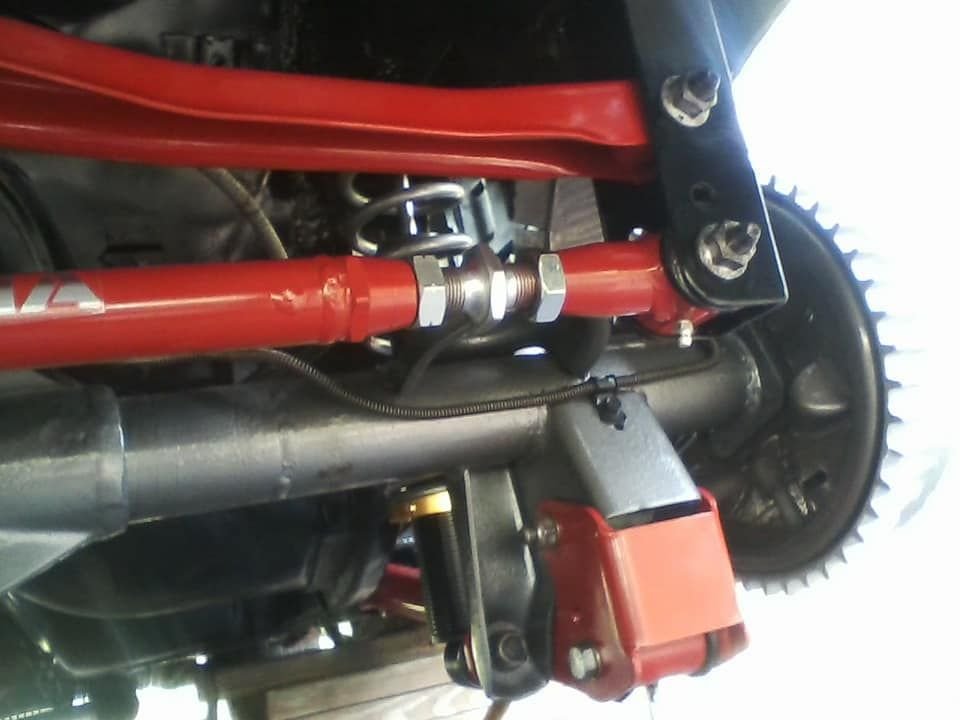

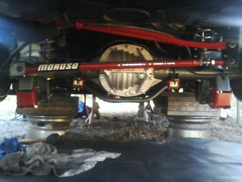

For added comparison, I used the Jegster axle side only (bolted and welded), Lakewood adj bar with Del-Sphere ends on the axle side - on a 12 bolt, too. More budget minded with some adjustability.

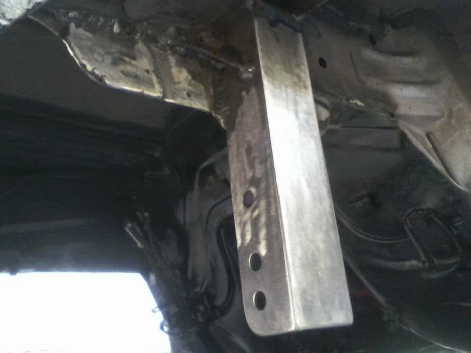

When i did a mild tub and narrow, ended up making my own mount. I'm cheap, lol

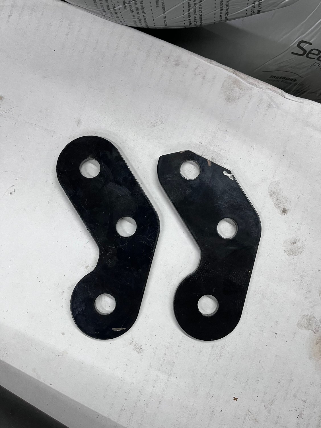

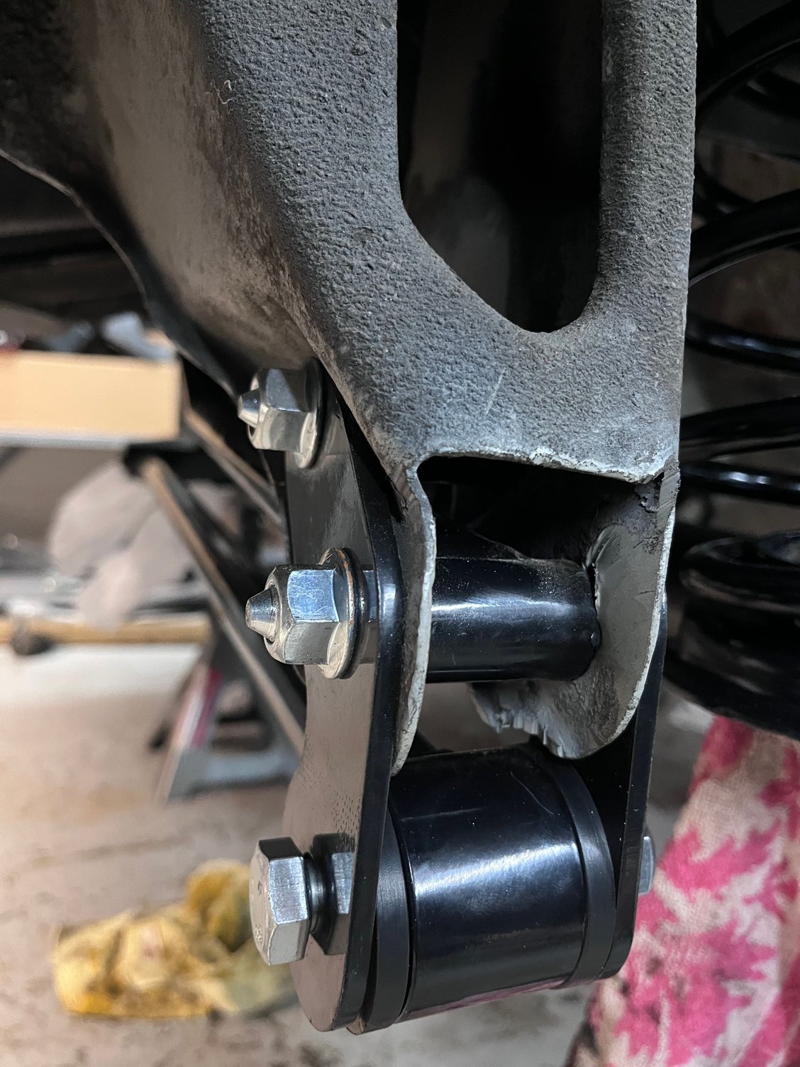

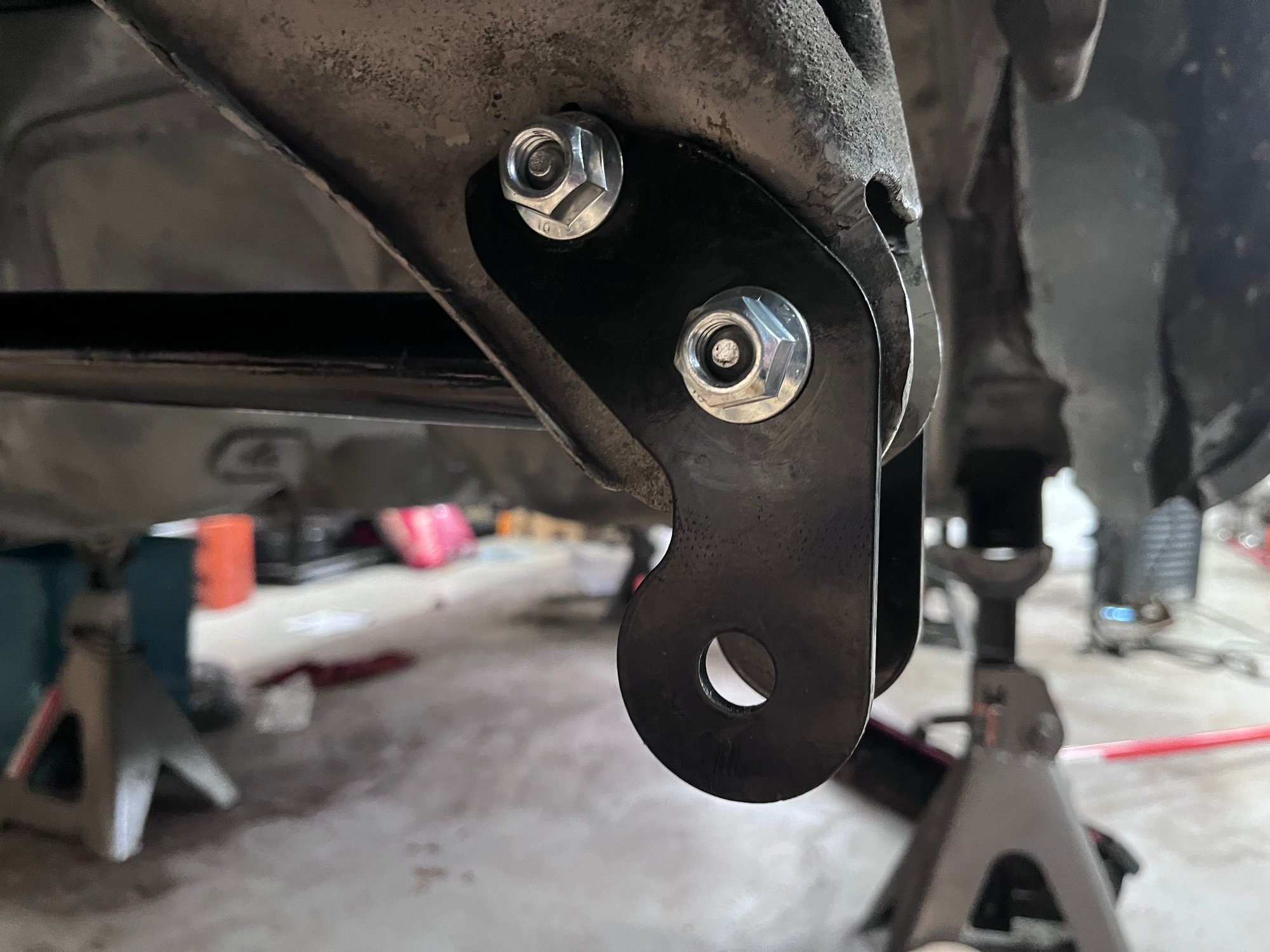

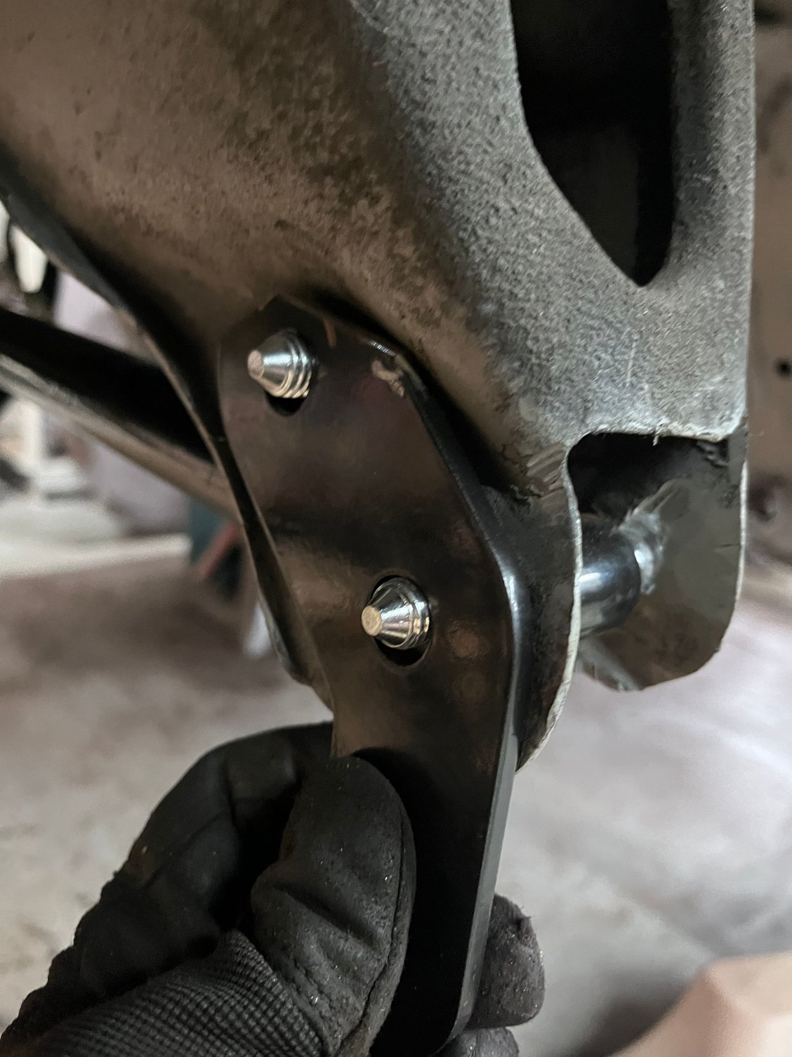

Adding my photos of the Non-adjustable PHB relocation kit from Speed Engineering. It is listed for 93-02 Camaro. Minor modification of one of the bracket plates was required.
Kit clears the 4th gen tank for me as well, it's very close to it. I didn't get good pics of the kit before installation but the kit includes the new brace, two flat bracket plates, a sleeve, and a nut and bolt. The kit was $104.99
Speed Engineering Panhard Rod Relocation Kit
Below shows the modification I had to make for the bracket plate to the rear side of the factory bracket, this was necessary to make it sit flush. Given the thickness of the factory material here, I'm not too worried about the integrity of this piece after cutting.
It would have been nice if it were a one piece bracket to ensure they are square. My factory bracket was a bit mangled, which was the real reason I got the kit.
I used new factory style stepped bolts from Spohn for the upper holes, since the one included with the kit doesn't fit the factory hole. They aren't really long enough to use for this with the added plate thickness. I was able to get better thread engagement by using a clamp to pull it together and an impact gun to tighten it down. The Panhard bar still fit in the brackets easily so it's not too tight there. Possibly just a result of my messed up factory bracket.

Is it just the pictures, or do you barely have just enough thread engagement on those bolts/nuts? If it were me, I would certainly like to see some threads protruding through the back-side of those nuts.
Yes, I would say that I have barely enough. Here’s a better pic after getting a little more out of it. You can also see how messed up my factory bracket is.

definitely would like to see 1-3 threads coming out of the nut.

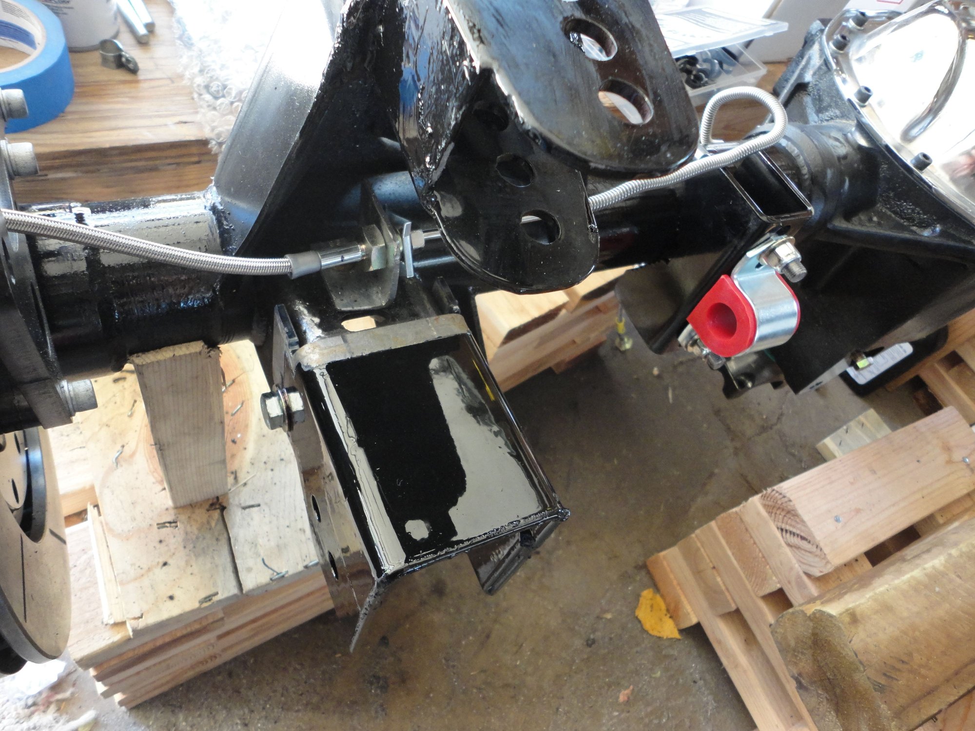

I've used the Founders full panhard relocation kit for 3 Autocross seasons now.
nothing has broken or bent.
That's good because I tend to break suspension parts.
Also keep in mind lowering the panhard bar lowers the roll center. So you will need FAR more rear spring to counter the fact that the chassis has more leverage on the axle. I wouldn't use any relocation kit with springs under 175lbs rate for cars that AutoX/Road race ex ex.
​​​​​​I Have a video on installing and welding it.
note: the aluminum panhard bar was flexing 1/2in on race tires so I replaced it with a unit from UBE. Probably fine for street use though.
https://m.youtube.com/watch?v=hV_ovYfZ384

Great info here. I run UMI's kit on my 86 Trans am. I was in the market for one of these again for my Daytona.

Ya, it's a panhard bar from Jason at Unbalanced Engineering.
I used his bar because it has Aurora rod ends. Those rod ends are a HUGE step up in quality over other rod ends.
Plus Jason is super knowledgeable when it comes to 3rd and 4th gens. So buying his stuff means I can bug him with technical questions.
Start talking Motion ratios and roll centers and 99% of 3rd gen owner's eyes gloss over. Ha ha.
