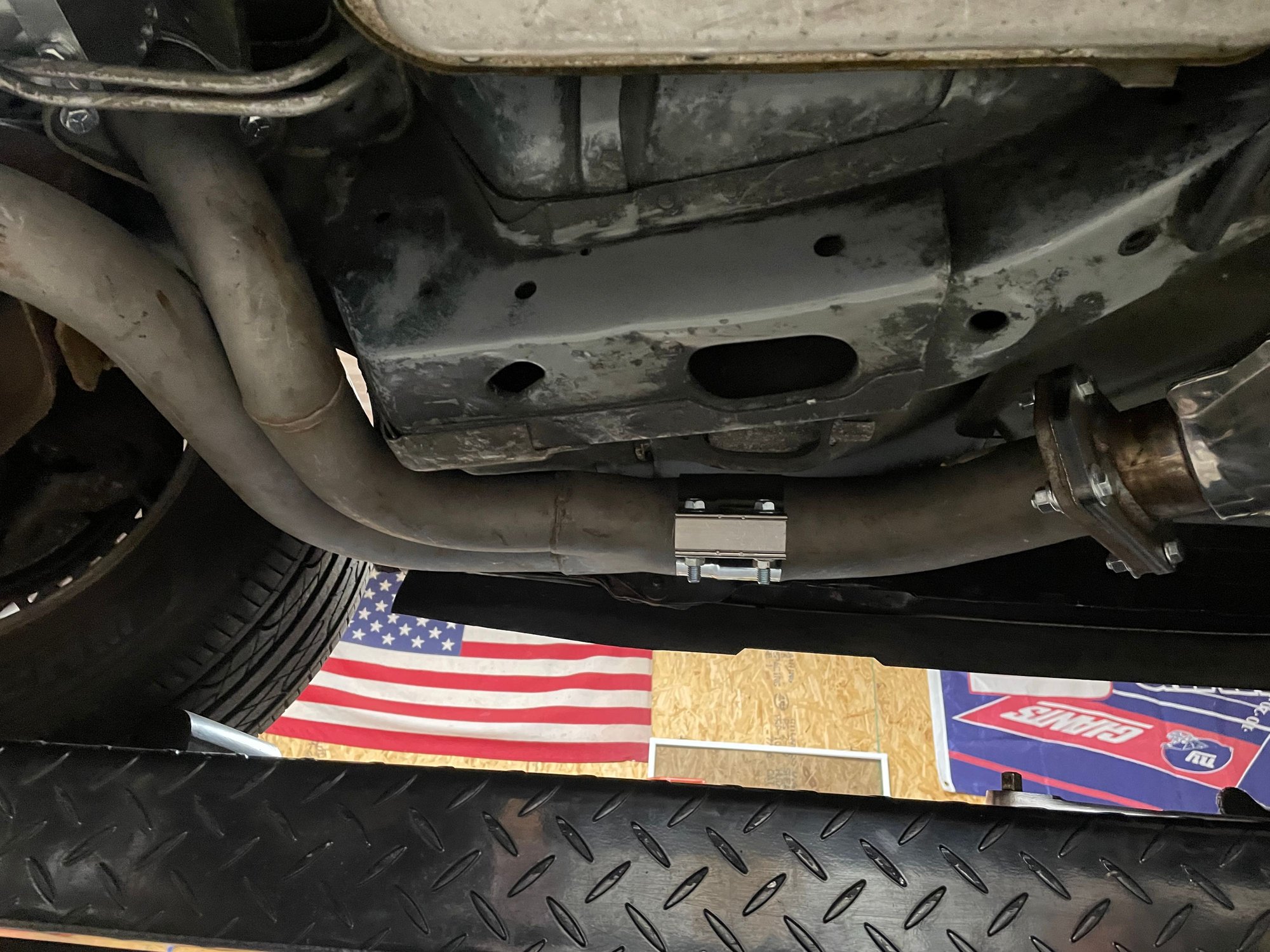

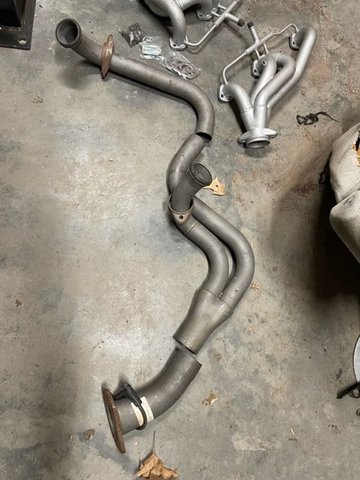

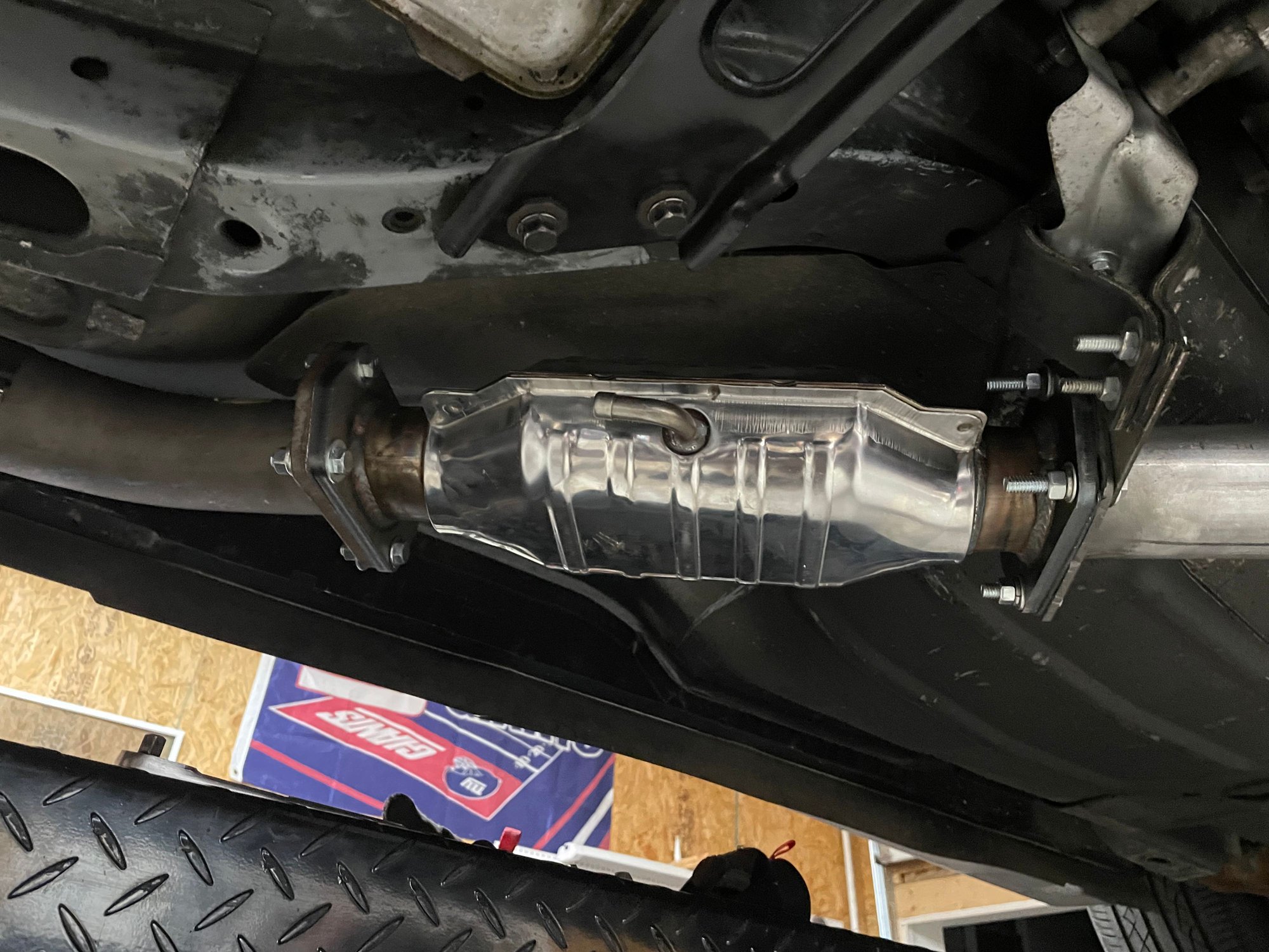

photos of the headers/pipe/ and stock setup:

Looks like the 4 in to 1 1" 3/4 tube headers with single cat Y pipe.
looking at your cat, I'm not sure it's factory, looks to be a replacement. Which means you may or may not need to use that adapter.

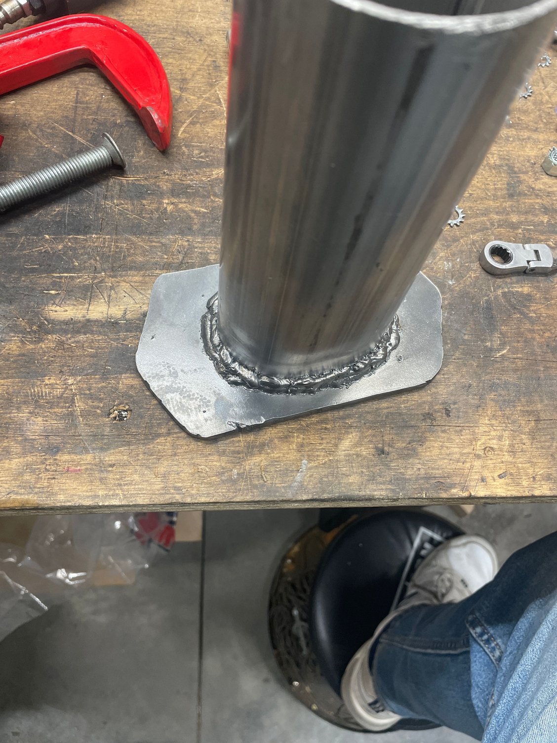

The current intermediate pipe is a 2.5" mandrel bent dynomax pipe (brand new--installed just prior to purchasing the vehicle). 3" might be in the future, but for now, we just want to get the car up and running.
I was looking at this flange: https://www.ptbtubebending.com/produ...xhaust-flange/
and this transition tube: https://www.ptbtubebending.com/product/oval-transition/
I can weld them together, if the flange is the same bolt pattern as the 93940.
Does anyone have any experience with these products or this company? I have a message into them.
Anyone else know of anyone that makes a transition piece? I've checked with a couple "custom exhaust" places around me to no avail.

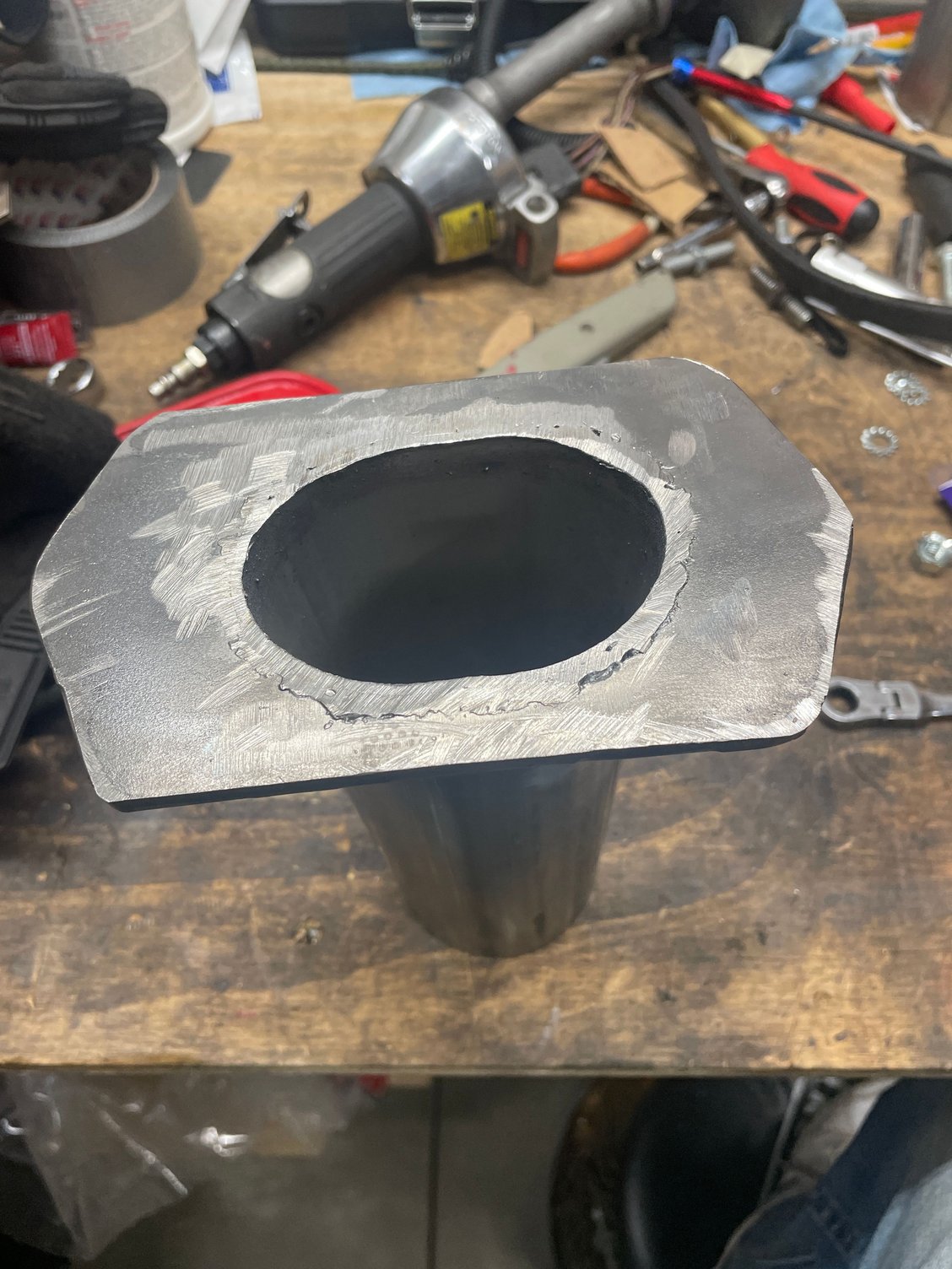

To make a "custom" one, all you'd have to do is, take a piece of about ¼" stock about 4" × 6" or whatever, cut an oval hole out of it, drill 4 holes in it, smash one end a piece of tubing to the same size & shape as the oval, and jam it in and weld it. Use the cat gasket as a template. You could smash the tube first and then cut the hole to match, to guarantee a good fit.
Without dimensions I have no idea whether those other parts would work.
You'd need to re-do that for the more appropriate size of exhaust when you realize that the 2½" is too small to begin with.
still have to drill the holes once the cat/gasket arrive….but made the flange.

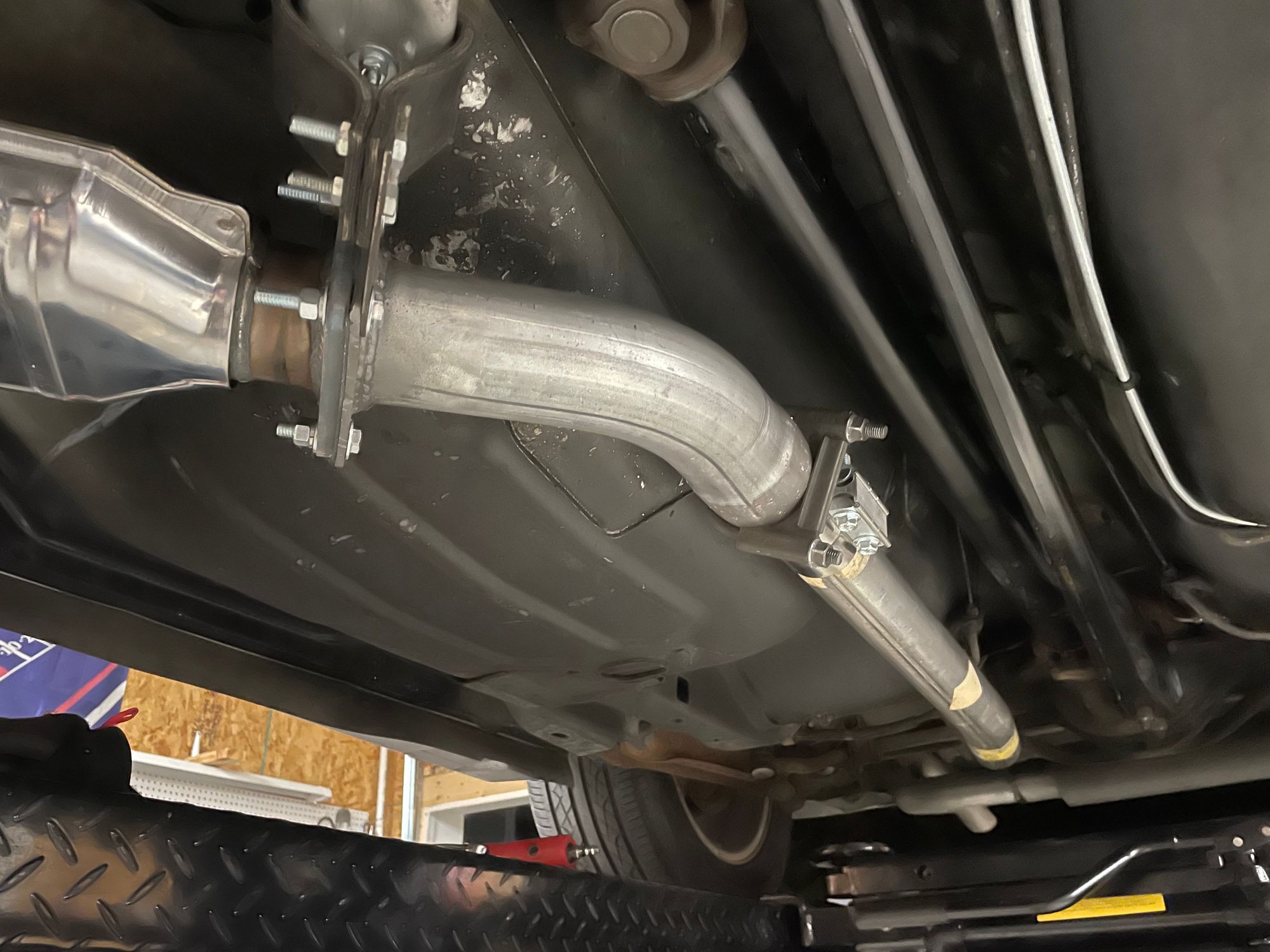

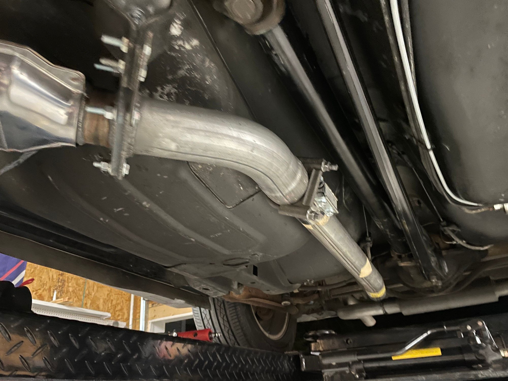

So, the first swing was a fail! Coming straight out of the cat like in the prior pictures does not work,
ended up cutting and welding another flange out of 3/16" mild steel, and using a Walker 42760 3”, 45degree bend. https://shop.advanceautoparts.com/p/walker/18370757-P
welded it up today and installed.

Not so hard, is it? Looks like it'll be MUCH better than looking up "86 Firebird VIN code H" and just bolting that useless crap up to your car.
