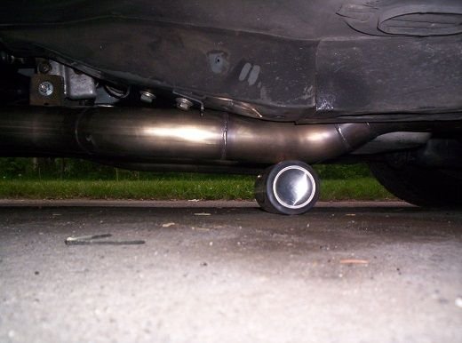

To fit Hedman LT headers on my lowered Camaro two things had to happen.
1) A y-pipe had to fabricated and it was fitted to the existing 3" "cat-back" Flowmaster exhaust.
2) The OEM crossmember was modified to provide maximum ground clearance.
2-1/2" stainless y-pipe with Magnaflow 2 into 1 merge.
Crossmember with notches and reinforcements.
Ground clearance was decent although with the car fully loaded (2 adults with golf clubs and luggage) speed bumps were a nuisance.
As installed on chassis number 2. (With the aforementioned speed bump damage evident.)

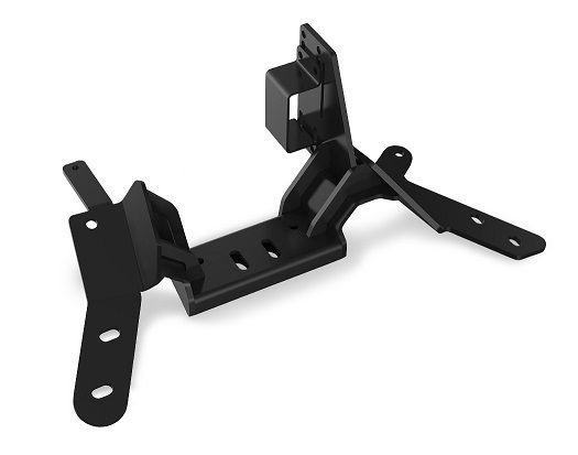

As I move forward with further car development, Holley's engine swap crossmember will be incorporated for a couple of reasons not the least of which is the generous real estate offered by the high arches. This will require the creation of another y-pipe for that to happen though.
