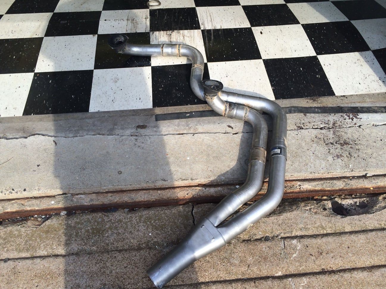

I did something similar for a friend sounded great and even better after he tossed that **** flowmaster muffler and replaced it with a magnaflow. I am thinking about recreating it for my self when I do my next exhaust
https://www.thirdgen.org/forums/exha...al-y-pipe.html

Yeah, the typical street oriented Flowmaster mufflers are worth skipping over, but their Y-pipe merge is really good.

I agree the flowmaster merge I used was very nice

Do you mean this pipe?
2x2,5" inlet, 3" outlet
https://www.summitracing.com/parts/flo-y250300
What is the advantage to some kind of those y-pipes?
The last one has inverted inlet (3") and dual outlet (2x2,5") but can be used either way...?
https://www.summitracing.com/parts/jex-su6-4

Forget the x-pipe. No room for it. Get the flow master Y with the 3" outlet and make your whole exhaust 3". Whatever muffler will sound good but flowmaster sounds the best
