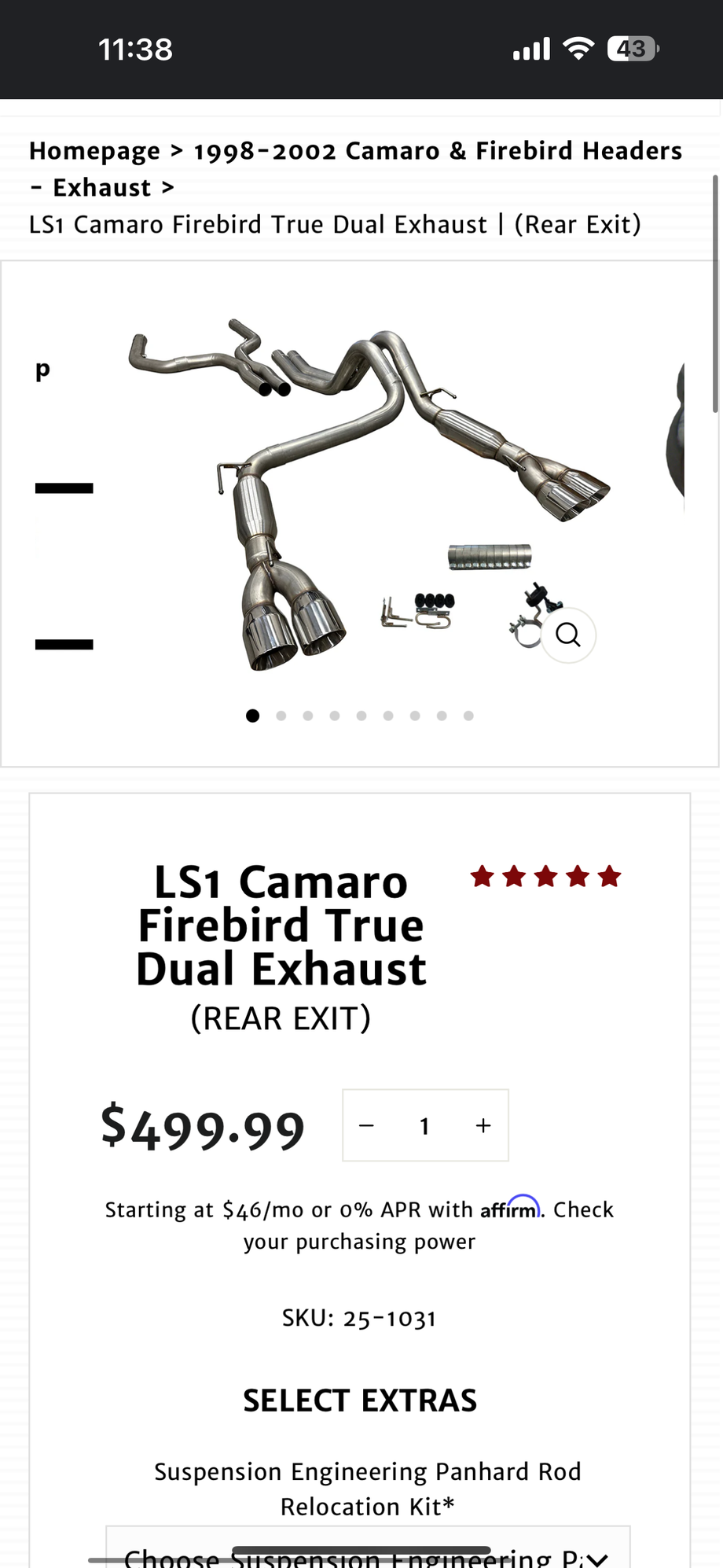

Does there exist a true dual exhaust system for the 3rd gen with an LS? Some additional info: Trans is a 4L60E, have UMI torque arm & cross member, SFCs, and long tube headers. I have seen many threads with custom systems and most threads are very old, so didn't know if anyone (Speed Engineering, Hawks, Summit, Speed Zone, etc.) has come out with anything since.
As an alternative, I am also considering Hawk's 3rd gen Y-pipe with a Hooker "double hump" cross member (w/torque arm mount) and then any 4th gen cat-back. Anyone done either of these two configurations? Any issues with stock panhard bar and 4th gen cat-back fitment? Hoping by using the double hump will prevent any clearance issues. Thank you.

Im at the same cross roads on my build but I’m researching and saw the speed engineering ls1 true dual exhaust. It looks like it would fit up on a third gen.
your thoughts?

Was considering that one too...it is their 4th gen system and with some mods would work in your 3rd gen, but would require some mods. The rear portion should fit just fine (as long as no panhard bar issues. Although they do offer a relocation kit if needed)...it is the front that might offer some challenges (i.e.: ground clearance issues if yours is lowered, etc.). This system mounts below the trans crossmember and being straight, wouldn't have the ability to "tuck up" if using a double hump crossmember.

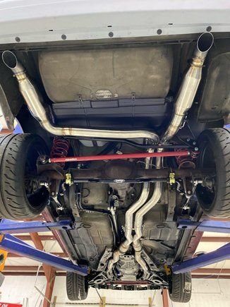

Mind sending a pic of the y-pipe area showing your fabrication? Thx!

Here is how I fabbed mine.

Looks fantastic. Did you do the welding yourself?
What's after the headers? Are those cats?

Yeah, short 3" cats. I had a speed shop who specialized in cages do the welding since they could tig. Since the system is 304 stainless I wanted it tig'd.
