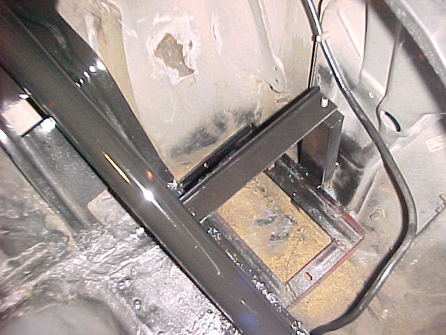

This setup wouldn't pass tech. though because it is not sealed off inside the car. I plan to change that later.
