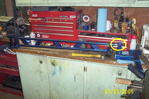

Decided that after my SFC turned out pretty good that I would tackle a new torque arm. I have a picture of Spohns so it kind of resembles his.
Have to look through the mess on the table to see it here.

Looks good for a home made fabrication but it doesn't look adjustable. Hows the pinion angle?

isn't that spherical rod end for adjustable pinion angle?

that rod end on the front won't really do much for angle adjustments. you need two on the back to really have much adjustment.

There are two in the back.
My bushing isn't working good and I have alot of vibrations transmitting into the car but I think I have a plan to fix that.
Those rod ends have too much slack in them and I can feel the torque arm move when I shift hard. I'm going to get rid of the front one rod end first and see if that helps and then make it solid in the back if I have to.

i kind of thought that you might have a couple in the back but i couldn't really tell for sure. how are you going to remount the front? gonna use a stock type setup or what?

I got a set of panhard bar bushings from Energy that I am going to use. I need to turn a couple of sleeves on the lathe and make a mount for the top one on the torque arm. Probably next weekend when I pull it apart to put in the new Centerforce clutch I'll change the torque arm.
