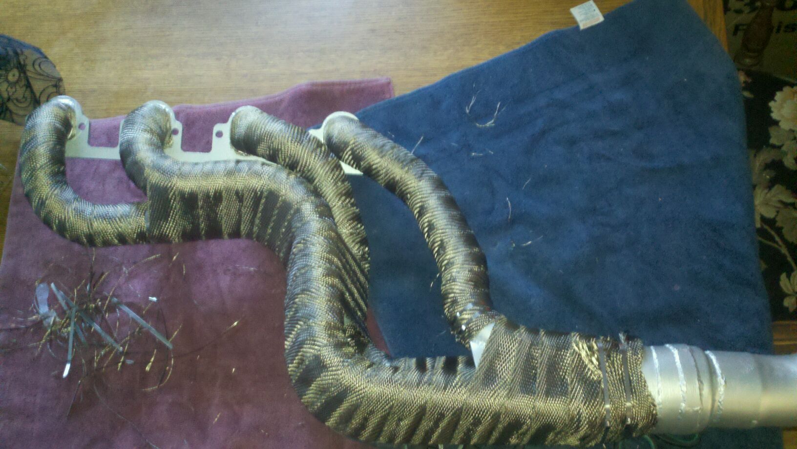

How about a 521cuin big block ford! 2" primary, 3.5" collector full length headers wrapped with DEI titanium wrap, true dual 3" exhaust with xpipe and turndowns, C6 3 speed trans, ford 8.8 rear end with custom adjustable shorty tq arm. thru floor and perimeter SFC, 8pt roll bar, aluminum door panels, 5" sterwart warner speedo/tach. I moved a 19x31" summit racing rad 3" to the passenger side to clear the steering box for the ford setup. Braced stock front Aarms, panhard bar support. Real bixenon HIDs with 55w ballasts and projector foglights all in a pop up delete lexan headlight cover
Dont mind the edelbrock air clearner... just there to keep stuff outa the carb. The engine was set back 1.5" with custom motor mounts i made ( i had it back 4" but it was too high)
Attached Thumbnails lets see some pics of your custom mods and/or fabrication-613.jpeg   lets see some pics of your custom mods and/or fabrication-619.jpeg   lets see some pics of your custom mods and/or fabrication-p1020941altered2.jpg
