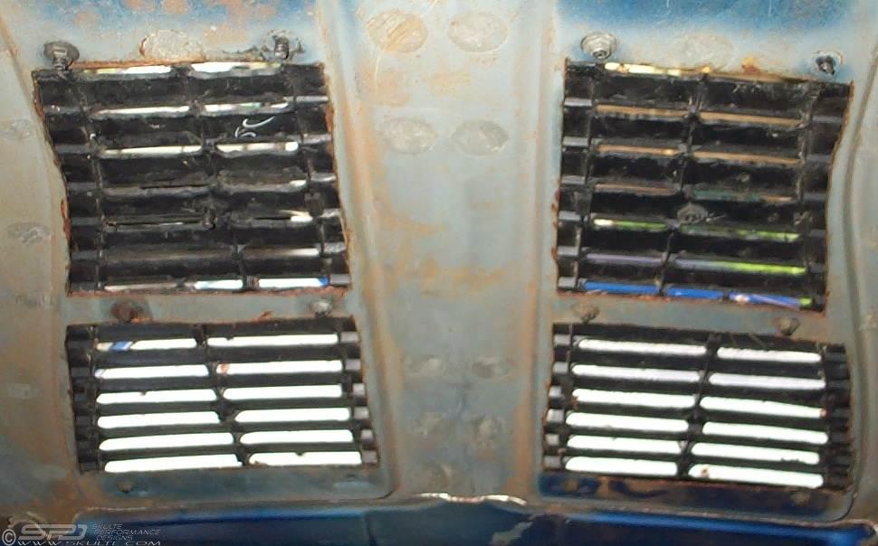

The IROC-series cars had open louvers & the only TGO member/public person to have done it too (that i know of) is Andris to his TT Camaro.
http://www.skulte.com/gallery/view_p...louver_outside

I made mine functional too, but I completely fabbed a pair from aluminum. I bet if you searched under my name you'd find the thread pretty easy since I don't post much.

townaj, was this the link you were referring to? http://www.flickr.com/photos/camaro8...7606917040057/

Yup thats the one! Wow my car has changed soo much since I bought it. I still have the louvers though and they work great. I lost a TON of underhood heat. And you can see the heat waves radiating out from them, especially with my headers. I lost about 10 to 20 degrees from my engine temp too so I'm glad i did them, it definitely helps.

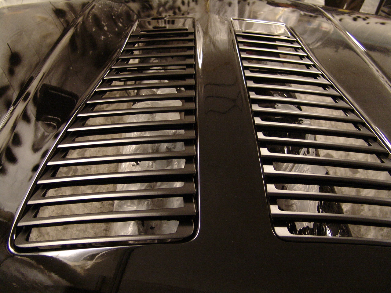

I've done that mod....so far so good!
Also, I just got a stock looking Carbon hood. I will be cutting out
the middle sections and doing the same mods as below.

Thats sick man. Looks amazing

are those the plastic louvers that came with the hood...they look really good.
how hard was it to do?

They are the stock louvers. Cutting them is a PITA! I messed up several times and some cuts are really crappy. I broke each louver a couple times where the cuts got too thin. After cutting, I used plastic filler to go over all the rough cuts. I then sanded the filler and repainted the louvers.
It can be done, but just take your time.
If I had to do it over again, i'd go slower.

That's a gorgeous hood

Nice looking hood thats the best look Ive seen so far.
Have you got under hood pictures would like to see how it looks

Hi There,
Here is a picture from the initial work. Notice that I didn't cut the metal completely. I left the cross sections that are covered by the louvers. This will give the louvers something to sit on while also providing some rigidity to the hood.

My question is... Isnt there fumes and such coming from the engine bay, and the seal strip between hood and firewall. I was under the impression this(seal) is a safety feature to prevent the accumulation of noxious fumes and gasses in the passenger compartment.

nope, this has nothing to do with that, the seal between the hood and firewall keeps crap from getting under the hood, but it goes between the engine bay and the outside of the car.

Update...anyone interested in buying this hood? I just purchases a stock looking carbon Fiber hood and will be doing the same mods to it. I no longer need this steel hood. It's a shame because we just finished painting it...it hasn't even been on the road!
The hood will come with the cut louvers just as you see in the picture.
Make me an offer. Due to the size and weight of the hood, I prefer local sales.

Thats crazy!!! Sparks my intrest in doing it again, I wonder how hard it would be to make then from scratch, I guess it couldnt be any harder than carving them out huh??. I work at a machine/weld shop so I have everything i need to do it. Just depends on which is the easiest to do. Suggestions??

If you decide to make them, I'll be glad to share my experiences. Its not hard, just time consuming.

Townaj what it that around the edge? And still wondering as far about the rain when your car is just setting still does it get in the carb?

The stuff around the edge is the same stuff they put on the edges of car doors so they don't ding another car when you open them. Thats probably not a good explanation but idk how else to say it lol. I got a whole roll of it from Napa. The water doesn't get in the carb at all. I have a 14 inch filter so what little water gets in just rolls off the edge of it. And it will only get in if its parked, while driving nothing gets in them. I also haven't noticed any increase in debris that gets in the engine bay either.

No problem. I think cutting the stock louvers would be cleaner looking. I just didn't have the ***** to try and do that lol. Post up results of what you do!
