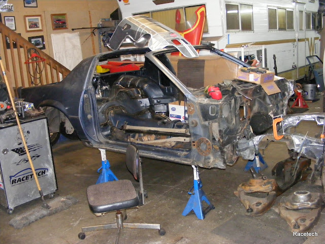

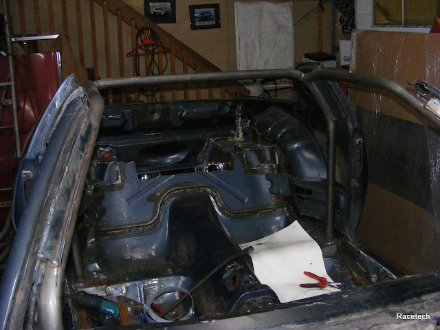

Ok, before I get slammed here for doing this to a decent car I want to clarify I needed a cheap car and quickly. Our first ChumpCar Camaro was an 81 that I was a partner with and the partnership split up and I was left hanging which worked out better for me.
Rules of the Races are simple, cheap cheap cheap. I found a 84 Z28 T Top car on Craigslist non running for $300 complete without title but with the proper paperwork from DMV.

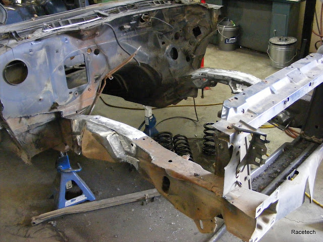

After deciding on a course of action we determined to lose the front struts do to the cost of getting decent struts for minimal money. Plus I always wanted to do a A-arm 3rd gen. Camaro.

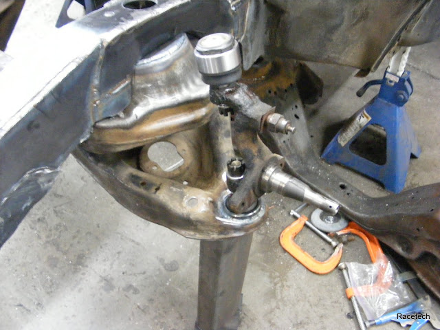

I used the spindles from a drum brake GM car (Chevelle) to allow me to use the C4/C5 Vette brake upgrade. I also used mopar screw in ball joints top and bottom. Had to ream the spindles for those to fit but it allows me to change them at the track in case one gets bent.

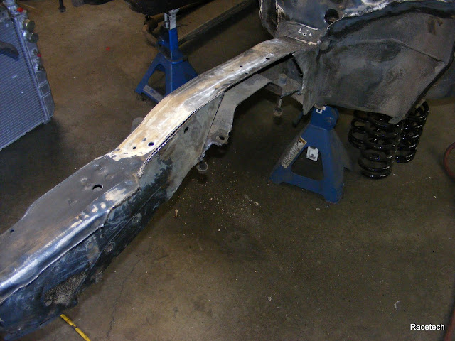

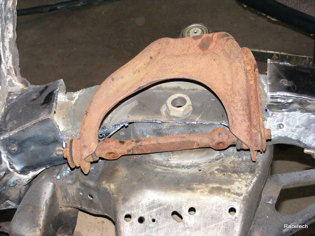

So after doing a plasma job on the front we went to work plating the 3 sides of the rails to handle the abuse of the A-arms have get a good mount place.
I also added weight jack bolts on all 4 corners to allow easy suspension set up and scaling. Front can be seen just below the A-Arm cross shaft. Car weighs in at 2854 less driver with full 22 gallons. Bump Steer is near zero and balance of car is 56/44. Using used Stock car shocks purchased off of the Bay and springs are 750lbs front and 200 rear. I lowered and stiffened the track bar and made multiple adjustments holes and swapped out the T5 for a 4 spd Saginaw. Torque arm was shortened up by a foot and mount to the Driveline hoop.

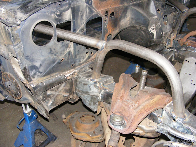

I added the forward Cage bars to the front to also help stiffen the front up.
Rules allow us 2x rule for brake upgrades so that opened up a large budget for decent brakes.
Safety is open and is what ever you want to spend for Seat, cage and belts. I fabbed the cage up from the front to the rear but I do not have any completed pictures as of yet. Car is going into paint soon so I will take some them.
Tires are limited to UTQG of 180 or colder. We are using a Dunlop Durezza 245/45/17s. Needed to go to a 17 wheel to clear the rotors. Fronts are 13.25 and rears are 12.75" I think. Do not quote me on the rears.
Fuel items such as Cells and lines are open from Pump to cell. I went with used Sprint Cup 22 gallon ATL cell that I got on the cheap from a Race Car parts liquidator.
Engine is a Target Master 350 from the 80's. I installed a LT1 Cam and lifters to try to recover from the less than 9:1 compression.
I also removed the top of the car to get rid of the T-tops, sorry guys but I think GM did wrong with installing those plus rules require me to fill them in. I found a roof from an 85 that was being totaled so I cut it off.

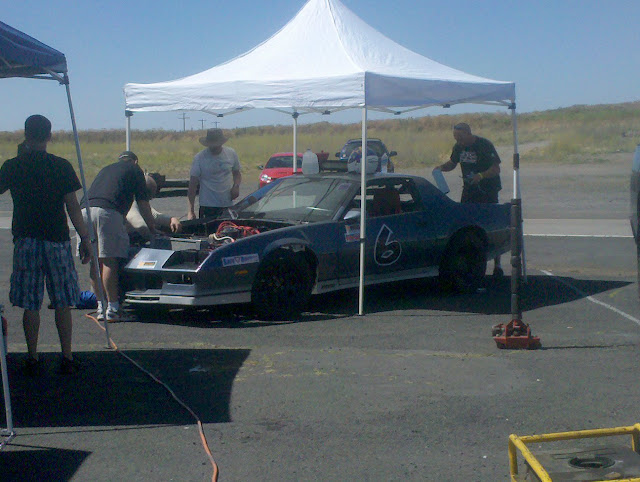

Here are a couple of shots from the Race we did in Spokane last month. We were in a big hurry to get it there on time so the graphics and paint were neglected. It will be nice for the next race next month.
You can see the build on our Blog, stumptownchumpsters.blogspot.com. It has all of the details on our little endeavor.

We pulled all the burnt stuff out and pulled all the skins to see what was bad and what was salvageable.
Brake lines, H20 gauge, switches, plug wires, stuff aforementioned, radiator, seat cover, harness, window net, all wiring forward of firewall, windshield and a few odds and ends.
