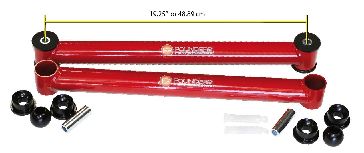

Hi guys/gals I just picked up a 1988 that has no rear end I am going to try and make my own adjustable lower control arms. I have made a couple control arms for dirt cars but im looking for a base line center of hole to center of hole. For the lower control arms. Thanks in advance

19.25

Thank you so much.

i just make the picture, thanks to KWIK84
