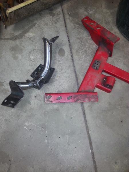

There is PLENTY of room down there as you can see in the pictures. All of those items are installed on that car in the side view shot, great ground clearance. The converters are the lowest point of the system, if removed it would then be the headers. Nothing touches any other component, nothing bangs or rattles, nothing is crushed to fit, the system is round from front to rear.

Those are Random Technologies free flow cats for 2 1/2 inch tubing. They are awfully similar to the factory cats on my 99 silverado.

hey 91ls1t56, you plan on selling that spohn crossmember now that you made your own? I'll take it off your hands

Are those subframe connectors something you made or something someone is making for these cars?

I made the frame connectors along with the crossmember, they all bolt up and work together.

I would say that is some very good fabing and welding. I would buy those in a heart beat. They look clean and fit like a charm. My duals dump out by under the axle. I don't get emission tested so no coverters and race bullet mufflers on mine.
