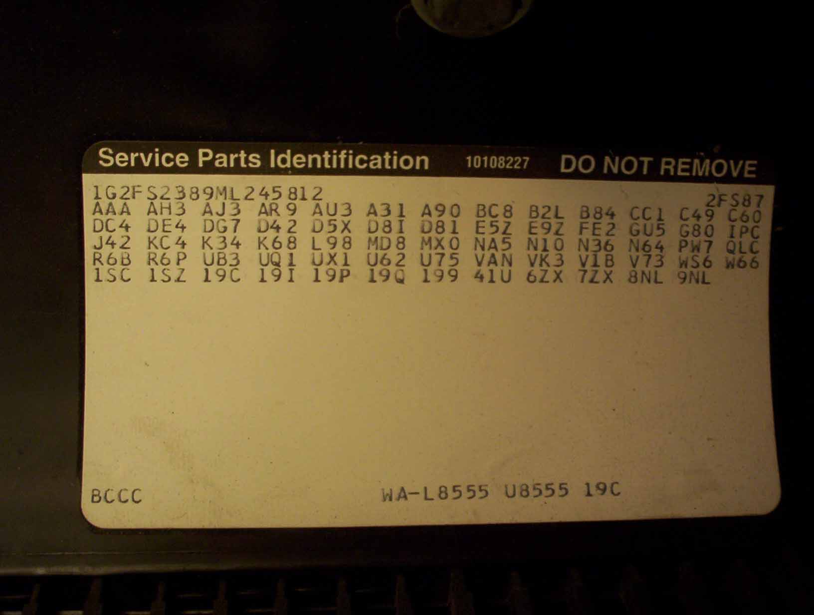

'91 Formula 350 & T-Tops RPO tag:
https://www.thirdgen.org/techbb2/att...postid=1291220

Being that is production # 45812, it is safe to assume the car was produced in LATE 1991. The highest figure I have for 1991 Firebirds is 50,454
John
