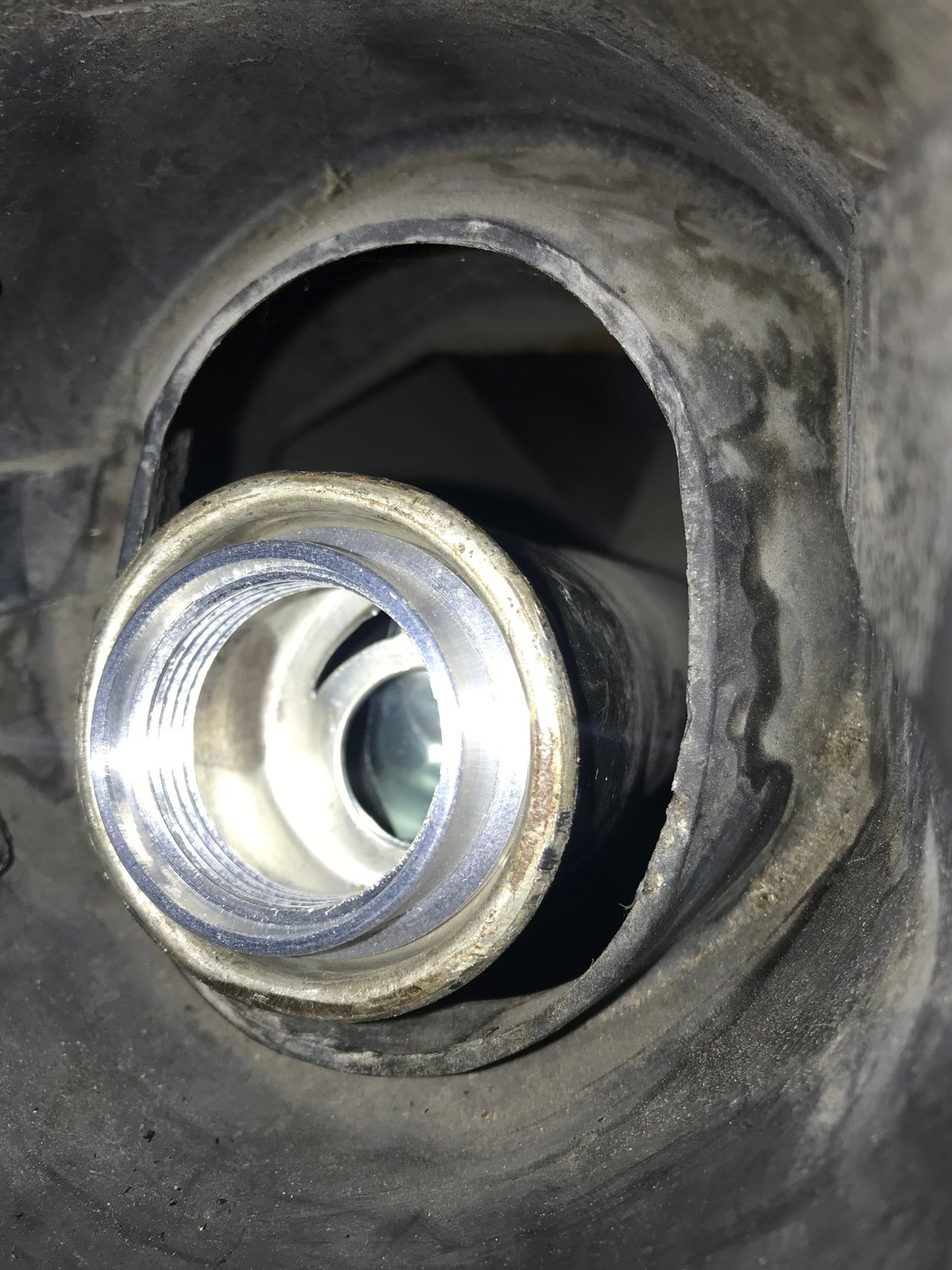

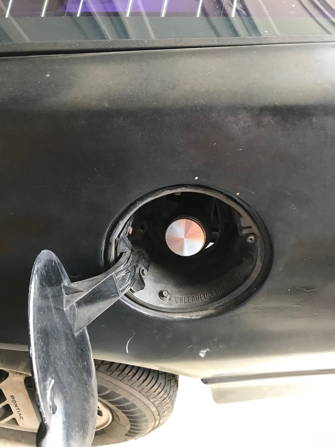

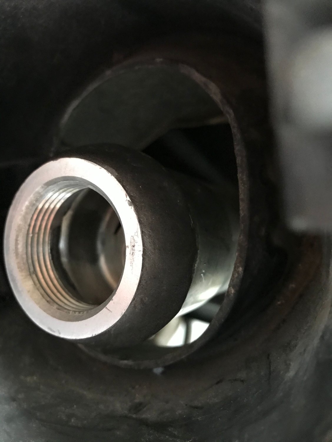

Just came across this thread because I had the same issue. Replaced the gas tank, but didn’t know the threads were crap until it was too late. Best solution I could find was filing down the cap threads. However, I did come up with a repair that does not require you to drop the tank and ensures a trouble free cap. Use JB Weld Tank repair to install a weld-in motorcycle cap inside the filler neck. Worked perfectly and gives a custom touch. A couple of notes on the project
- the tank is Aluminum, so need to find an all aluminum cap assembly to prevent galvanic corrosion
- do not weld/braze to the tank if you have ever put gas in it. Stick with JB weld tank repair on this one so you don’t end up with a bigger mess.
- the cap I bought had a 1.75in OD that necked down to 1.5in OD. I bought this one: https://www.ebay.com/itm/Billet-Aluminum-Filler-Neck-Weld-On-Bung-Screw-Cap-Small-CNC-Gas-Oil-Tank-USA/ If you turned it upside down (Put large diameter into the filler neck), this would sit perfectly on top of the threads with a nice gap all the way around for JB weld (see first picture)
- I was worried the o ring would get torn up from not having a proper seating surface, and I wanted the cap to sit a little farther from the filler neck for easier access, so I added some scrap aluminum to make mine a constant 1.75in diameter and 0.125in longer. Then installed it “right side up” with JB weld.
There is an ideal weld in cap out there that has a 2in OD that necks down to 1.65in, but from everything I could find, the aluminum version has been discontinued.
I know this is too lake for those in this thread, but maybe it will help someone.

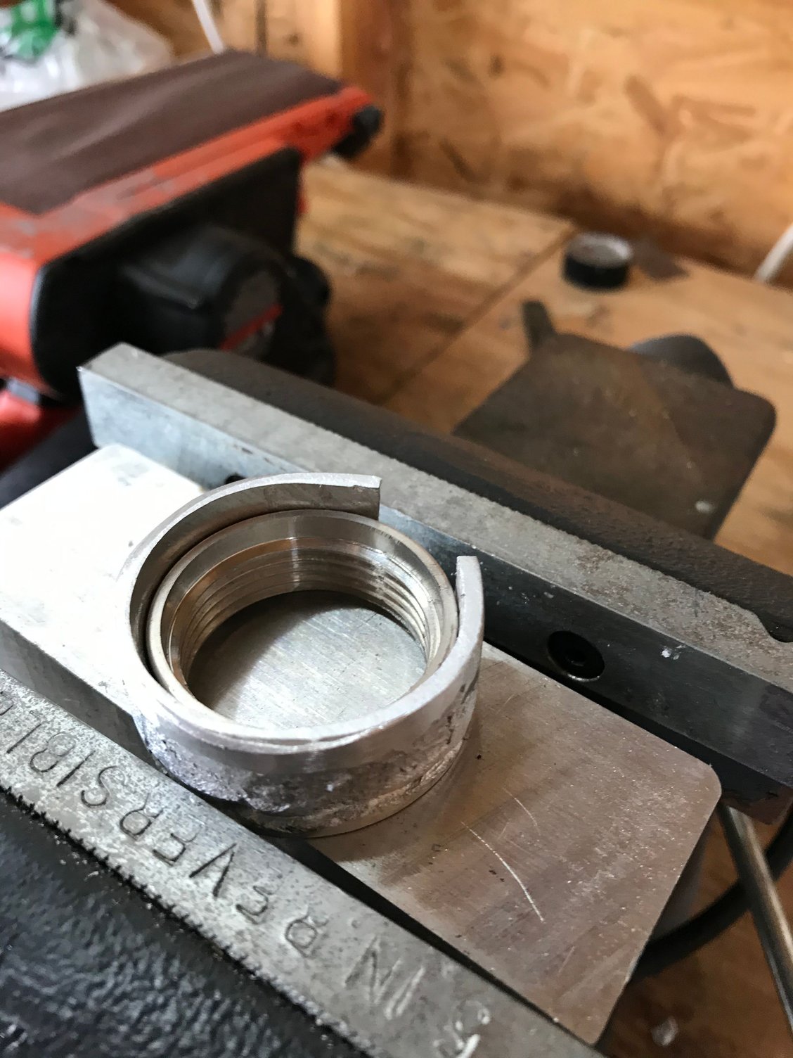

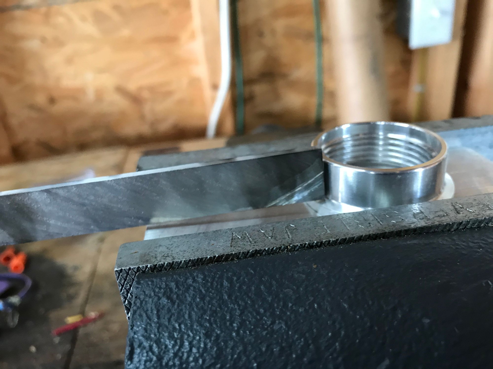

Weld in bung installed upside down.
Heated, bent, then brazed scrap aluminum to make constant 1.75in OD
JB weld assembly into place (right side up)
