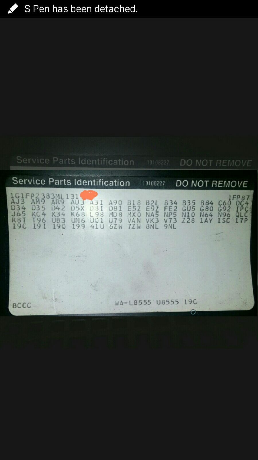

Ok guys .... I would like some info. Hopefully you guys can help out.
My buddy bought a Camaro. Production date is 6/90. Title says its a 1991. Vin 10th digit is L, which means 1990. The badging on the car says IROC. The RPO label supports the IROC as being real. But they didn't make 1991 IROC's. So the question is ..... Is this a super rare car or ?????

Your vins 10th is a M which is 91 your L is the 11th meaning build in Van Nuys. Its a z28. Recount again

The "IROC" license ran out at midnight, December 31st 1989. Any cars built after that were Z28s only, as GM could no longer use the name under contract even though they were mechanically identical.
This is correct.
Chevy licensed the name from The International Race Of Champions, and the contract expired at that time. Chevy decided that it was no longer of marketing value to associate themselves with a race series where they didn't race against other brands.
Dodge bought the rights next, for a few years; put the name on some little FWD POS. Did very little marketing with it.
When that expired, I don't recall anybody licensing it any more... the series ended up buying their own cars. They used Firebird bodies for the last few years of the series existence. The cars of course weren't "stock", they were tube-frame race cars, just with whatever sheet metal hung on them.
Bottom line is, somebody bought the stickers later on, and stuck them on the car.
I don't see "IROC" anywhere in the SPID label.

So in short .... it's not an IROC and it is a 91 model year.
The doors are the only IROC labeling on the vehicle.
It is a Z28 Camaro, 350 L98 TPI, that is unmolested. Even still has stock radio and exhaust. I told him to repaint the car, remove the IROC from the doors and keep what it is ... a Z28.

It should have the tall spoiler too.
