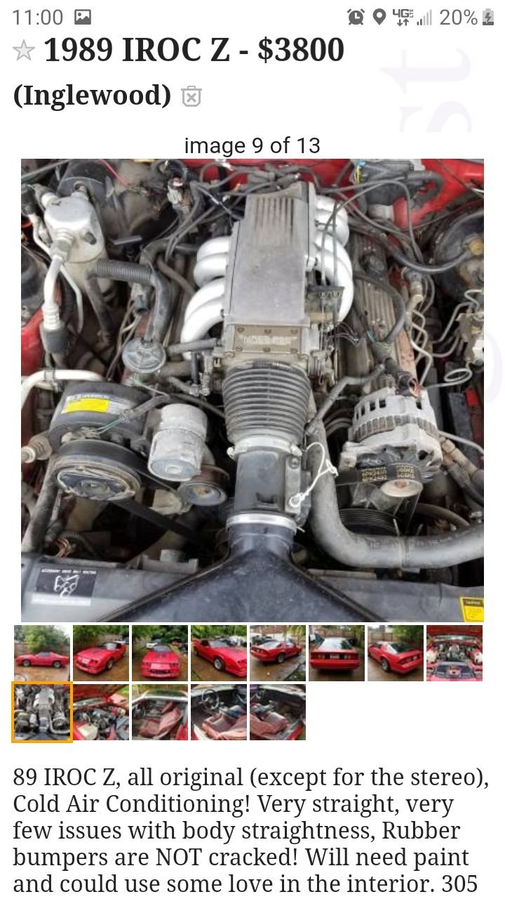

Name everything WRONG with this car......
This car almost made me nauseous. I wonder how many cars worth of parts it took to make this thing. Seems like NOTHING is right on it......
It says "All original other than the stereo" lmao.
https://nashville.craigslist.org/cto...944594245.html

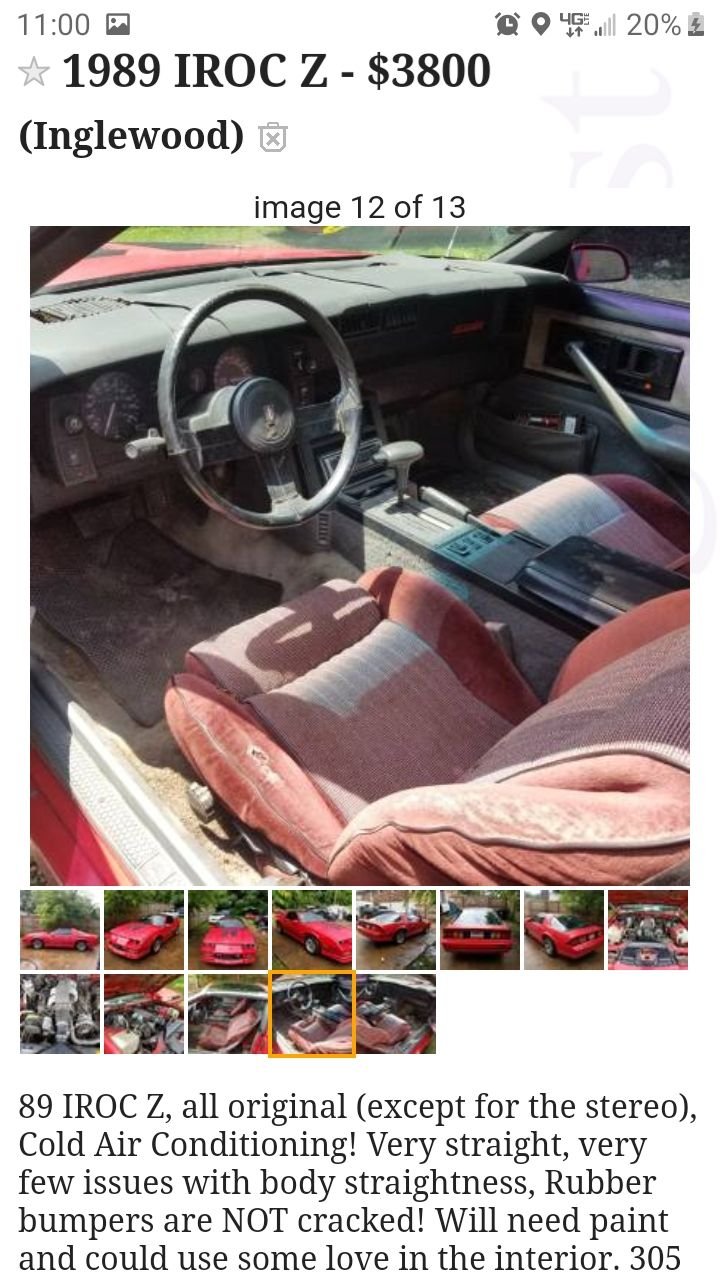

Re: Name everything WRONG with this car......
After maybe 20 seconds of opening the ad, I found.....
Wrong wheels
IROC-Z decals in the wrong spot
Trans Am door panels
Trans Am shift handle
1982 Camaro L/S seats. I say 1982 because they are maroon and that was a 1 year only color
No black headlight buckets
Mismatched fog lights

I don't even know where to start!
steering wheel
seats
shifter
door panels
decal
missing buckets
Did I miss any?

Obviously floor mats and dash emblem could be a nice car imo definitely needs interior work rather have the 85 to 87 style wheels anyway.seen alot worst ragged out thirdgens it's not worth $3800 the way it is.

Originally Posted by scottmoyer
Good catch on the lighter bezel. Another 1982 piece along with the seats and steering wheel.
Yep, that was a great catch! I missed it, too!

Actually, the 3 lined spoke steering wheel was only 1982 and 1983. In 1984, they went to only the lined 2 spoke.

Correct. And they used up the remaining 82-83 wheels in some 84s. But I don’t know if one or both plants. Probably both.
